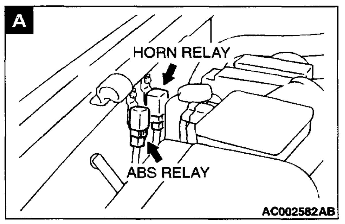

If it is the ABS system, then removing the ABS relay should have stopped it. Here is the location of the relay so you can be sure you remove the correct one. The reason I say this is because the horn relay is right next to the ABS relay. Check out the images (below). Let us know how it goes.

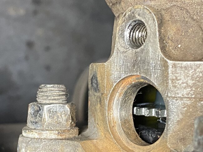

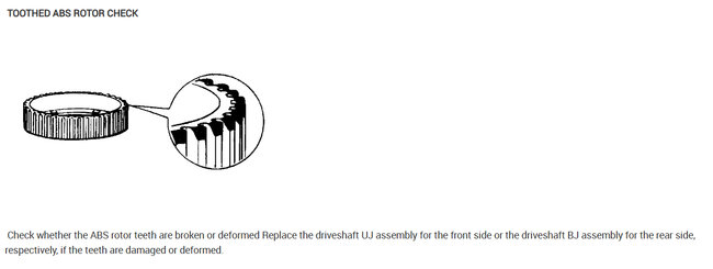

Hi Barry, yes this can happen when the reluctor wheel does not line up with the sensor or, there are metal particles on the reluctor wheel. I would remove the sensor and use a flashlight to inspect the wheel and check the alignment through the sensor hole.
If the alignment is off, you may have a wheel bearing hub going out. Please upload pictures or videos in your response of any problems so we can see what to help you with. Check out the images (below). Please let us know what happens.

I took it off and it looks decent to me ?

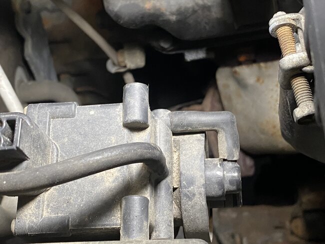

Also any idea what the second picture is ?
I find the l shaped hose was unplugged on one end.

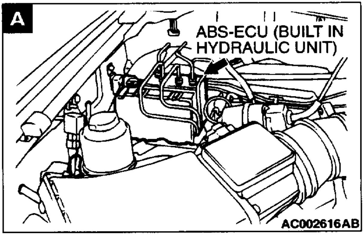

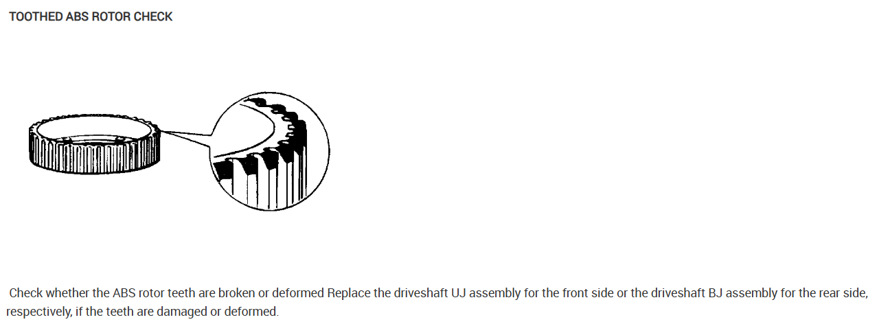

That looks okay, did you spin the wheel to make sure all the teeth were still there? If so and all looks good, I would replace the ABS module. Thanks for the images they help. Here is how. Check out the images (below). Let us know how it goes.
