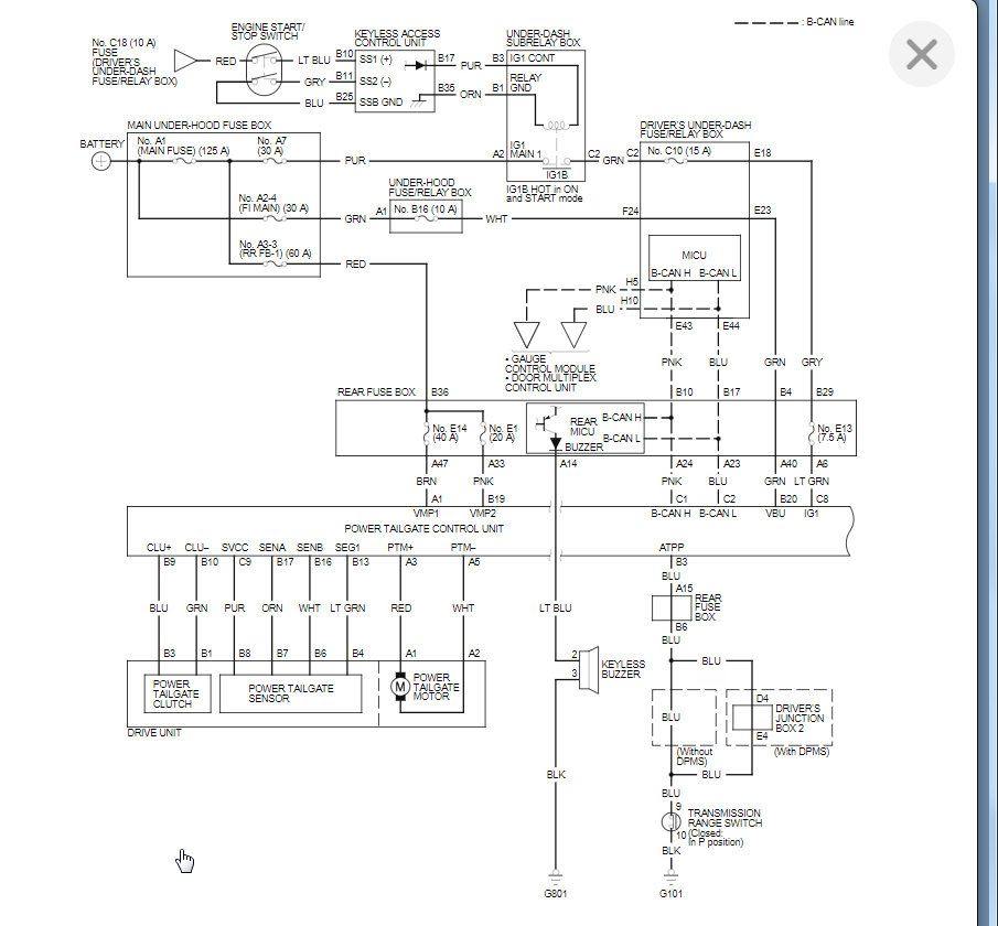

The rear hatch on my van will not open when I press the button on the dash or the button on the hatch. It worked okay, then it won't work anymore. Is there something somewhere that would disable it? Is there a fuse for it and where?
I can press the hatch switch and it pops but I have to lift it up and push it down.
Any info is greatly appreciated.

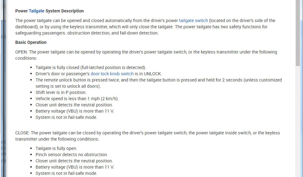

Okay. Just to be clear. The auto lift and close function is not working at all from any button but you can manually open and close it?
Does the vehicle beep at all when you press the button? If so, how many times?
We need to check for codes as you may have some body codes in the computer that will point us in the right direction.

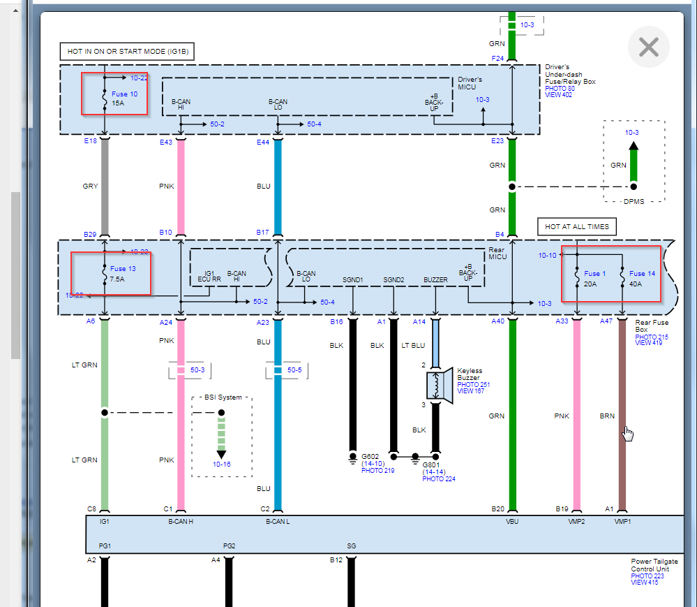

If there are no codes then we are going to have to check fuses as there are 4 involved but not one that directly controls just the door. I included these below as well.

The thing that is concerning me is that it is not beeping at all. That means the control unit is not getting the signal that the button is being pressed. So we need to go the rear fuse box and check the fuses for this system which as shown below. They are E14, E1 and E13.
Once we know they are ok we are going to have to test the voltage coming out of the Power Tailgate control unit just to make sure it is operating but I suspect we will find the control unit is the issue.
Let me know if you have questions on this.

Shortly after the last posts, I found my car barely turning over to start. So I took it to NAPA for battery test. They said it was weak. So I replaced the battery. I was hoping that "maybe" it was a weak battery keeping the hatch from opening and closing. Now with new battery, I waited to see what would happen. For 3 days - it still had the intermit but mostly the problem, hatch no work. But then after that, I never had the problem since. I put the battery in on June 2nd. I was giving it time to see if it failed again. But so far - All okay. Does that really make any sense????
Jun 10, 2021 at 11:21 AM
I would not think a weak battery would cause this but there is no "normal" concerns with a weak battery. You never know what will happen when the battery is weak.
So if it is working then I would not questions it and just enjoy the fact that it is fixed. If it breaks again then we can readdress it but hopefully that doesn't happen. Thanks for the update. That info will help others. Thanks for using 2CarPros.
