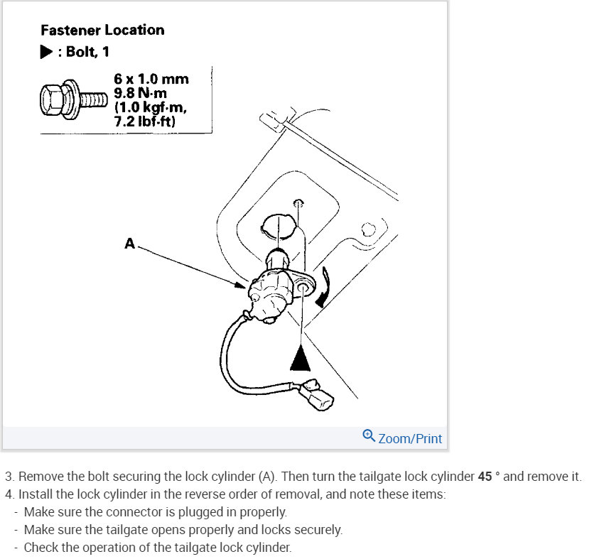

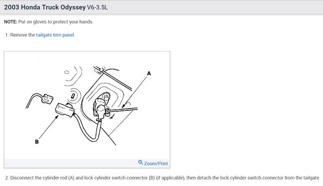

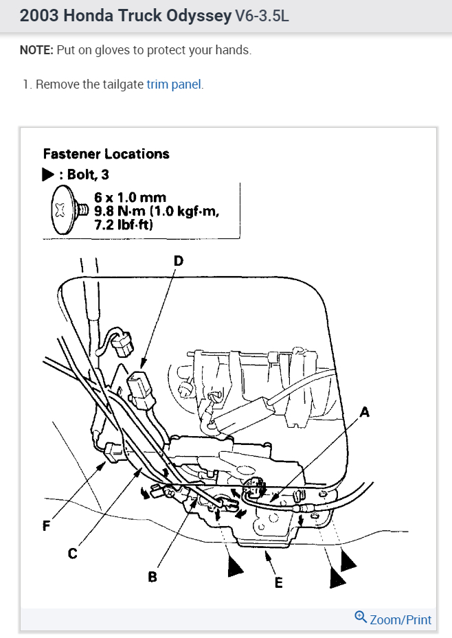

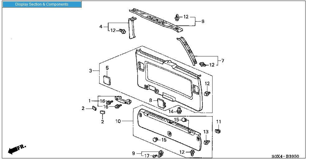

All of the sudden the rear hatch door will not open when the door is unlocked. It was working fine yesterday and there was no unusual event to cause this. The door lock moves up and down normally but the door handle on the outside of the door behaves like the door is locked. There is no door handle on the inside.
Any help would be appreciated.
May 8, 2010 at 3:14 AM
HONDA TECH 1818
  • 536 POSTS

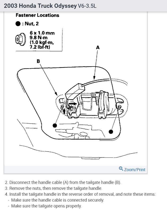

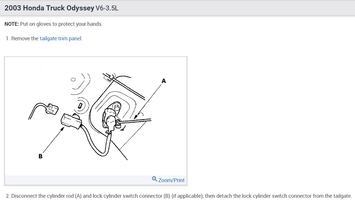

The cable probably fell off, you need to remove the rear hatch door panel (from the inside) to inspect cables. Here are diagrams to show you what to look for (below). Please let us know what you find.
May 8, 2010 at 8:43 AM
GLP
  • 29 POSTS
Thanks for the help. I removed the panel and the rod was fine but the cable had come out of the slot in the handle housing that it sits in. I popped it back in and it works fine now.

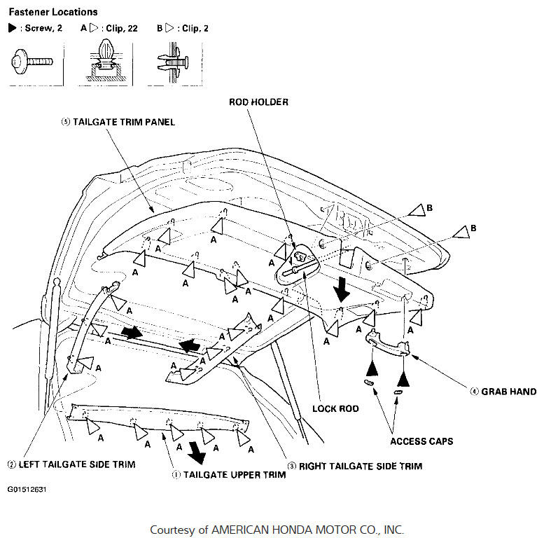

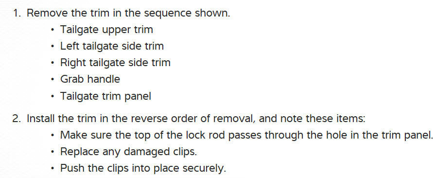

I have the same issue with the rear hatch door, could you please help me how to open the pannel? I could see that rod fell down and I could see the hole on middle of the plastic pannel(jest below the mirror). Any help would be greatly appriciated !!! Thanks in advance !!!
May 25, 2011 at 12:08 PM
GLP
  • 29 POSTS
You take a flat screwdriver and pop out the panel along the outer edges at the locations where there are clips holding it on. Apply enough pressure to pop the panel out of the clips located behind the panel. The attached image shows where the clips are located (items 12, 13, 14). I used a Haynes repair manual to guide me through this. You can buy one for your Odyssey at www.haynes.com.
