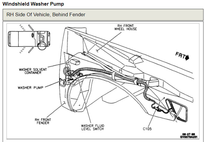

Where is the windshield washer pump located on a 1997 buick riviera? Supercharged 3.8l engine. Is It covered with a plastic shield and not obvious?????

Here is a guide to help you see what you are in for when doing the job.
https://www.2carpros.com/articles/how-to-replace-a-windshield-washer-pump

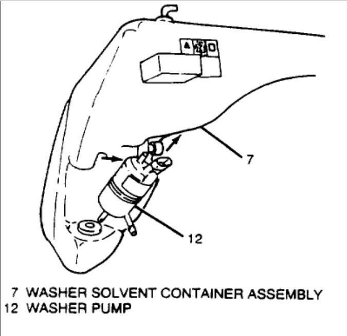

Remove or Disconnect
Outer washer solvent container assembly from vehicle.
Washer pump (12) from washer solvent container assembly (7).
Pull top of washer pump (12) out from side of washer solvent container assembly (7).
Pull washer pump (12) up out of washer solvent container assembly (7).
Install or Connect
Washer pump (12) on washer solvent container assembly (7).
Push washer pump (12) down into washer solvent container assembly (7) completely.
Push top of washer pump (12) into side of washer solvent container assembly (7).
Washer solvent container assembly (7) on vehicle.
Check out the diagram below
