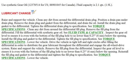

I hear a noise when I turn the wheels left or right at slow speed. GM diagnois -possible moisture in the differential. Suggest change fluid first. Would like to know how many quarts of fluid does it hold and what type of fluid is needed, and how to change the fluid in the differential?
If this doesn't help, GM suggested to replace the differential. That's my probem. PLEASE HELP.

For the differential, I found this info. Double check your owners manual for fluid type and amount,
https://images.2carpros.com/forum/automotive_pictures/170934_differential_1.jpg
