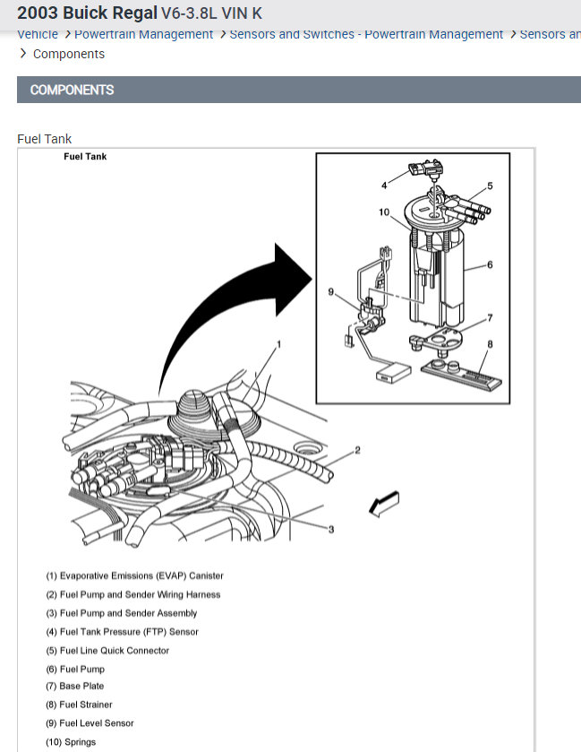

My car is able to "make" gas. The gas gauge goes from full to empty to 3/4 to 1/4 to empty and by the time I got home it was at 1/2. What is causing my gas gauge to act this way and how expensive is it to repair.
Feb 1, 2009 at 10:44 PM
SQM
  • 6,383 POSTS

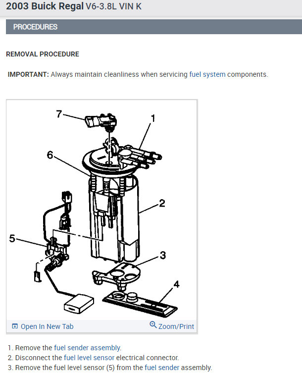

It sounds like an issue with the fuel level sending unit.
That sending unit is a part of the fuel pump assembly.

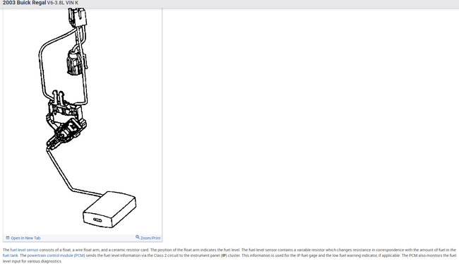

The sending unit consists of a resistor and a float.
The float goes up and down with the fuel level and connects with different values on the resistor panel.
Over time the resistor panel can go bad and that will give you incorrect fuel level. It can read higher or lower than what is in the tank.

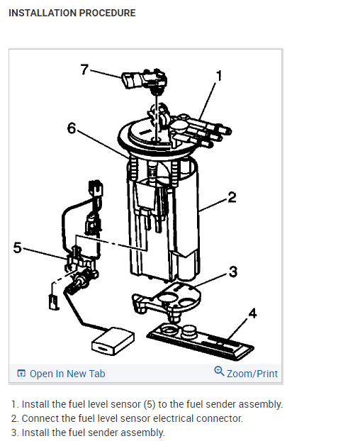

In order to replace the level sending unit you will have to take out the pump from the fuel tank.
