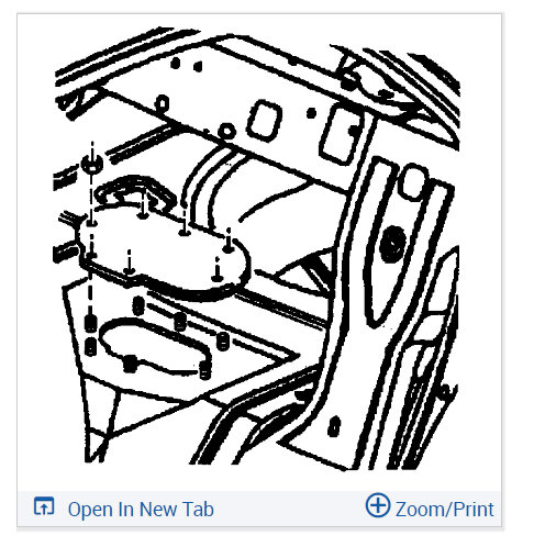

I have a 2000 Buick Regal GSE. When I start the engine, the fuel gauge goes to full and after a moment it drops to empty. I bought all new fuses and replaced the them in the passenger side fuse box. I also wiggled the wires near the fuel tank.

Sounds more like a bad sending unit in the tank...or the guage on the dash is bad.

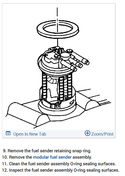

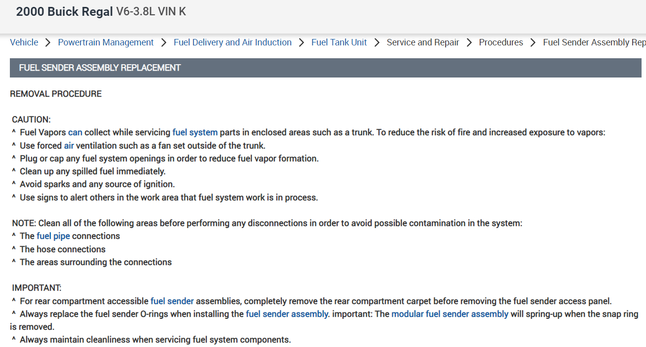

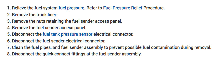

The above comment is really horrible information. Techron can’t fix a mechanical issue on a sending unit. The gas tank, pump, and sending unit are all replaceable parts separately. No way you’re a mechanic and telling people these flat out lies.
The most likely culprit is a bad sensing unit.
Sep 7, 2024 at 3:04 AM
  • 55,428 POSTS
Yep, good call, LSUSSEL must work for Chevron lol. Here is how to change it out so they can fix the problem. Luckily there is a trap door, so you don't need to drop the fuel tank. Check out the images (below). Let us know if you need anything else.
