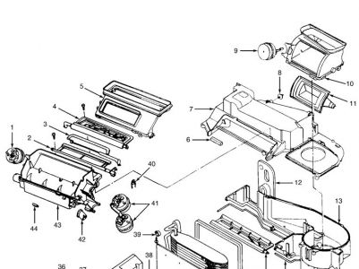

BMRFIXIT
  • 19,053 POSTS
https://www.2carpros.com/forum/1999-buick-regal-blend-door-actuator-vt139193.html?highlight= is it auto , daul zone you have
https://images.2carpros.com/forum/automotive_pictures/99387_buick_3.jpg

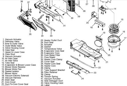

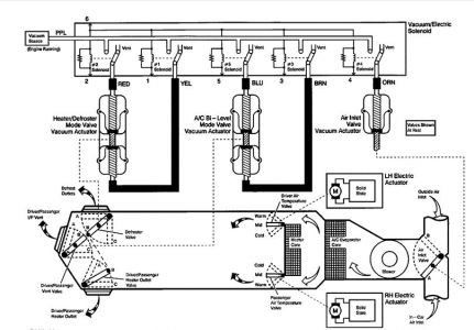

BMRFIXIT
  • 19,053 POSTS
https://images.2carpros.com/forum/automotive_pictures/99387_buick1_1.jpg
https://images.2carpros.com/forum/automotive_pictures/99387_buick2_1.jpg
