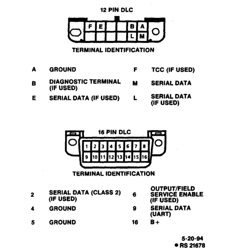

I would go with the PO codes you have. OBD2 Was mandatory in 1996, but some maunufacturers had complied earlier. I have had various cars the wer 94 and 95 that were already OBD2 compliant.

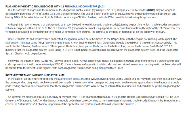

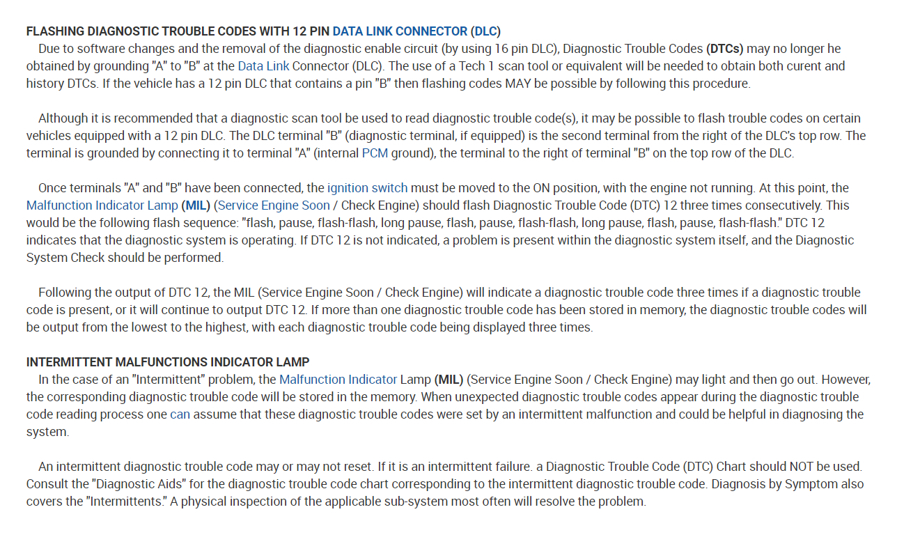

Your car in ALL probability is an OBD-1,you can ascertain that by grounding the diagnostic terminal and observe for the flashing of the "Check Engine"light which should start flashing.

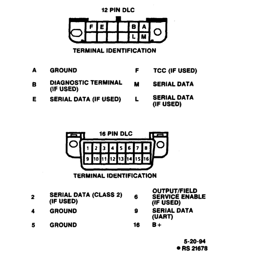

This is a good question. GM started to transition to OBD 2 in late 94 and 95. The pin arrangement in the connector was not the same as the olds models.
You need an advanced scan tool like a snap-on that has the correct cable to read the serial data line for the information. Then you will get correct information from the ECM.
