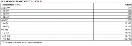

Have you checked the ECT? Here's the chart.

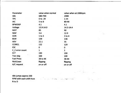

I had not directly checked the ECT sensor. A check at 2 temps shows that it tracks the table, but not exactly. The one sensor that doesn't test with the GM book is the MAF. The book shows a DC reading over 6 V or under 4V demonstrates defective device. I understand the sensor doesn't operate on DC, but it consistantly measures 2.6VDC. The scan tool values seem to track with the GM "normal" range. Attached is a list of scanned values.
https://images.2carpros.com/forum/automotive_pictures/413835_38L_2.jpg

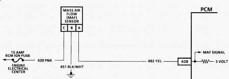

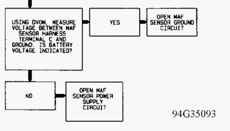

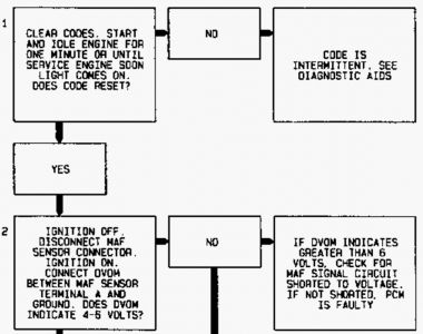

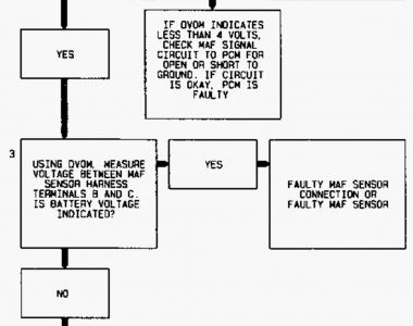

Engin e size? 3.1 or 3.8? This works for either anyway... Mass Airflow (MAF) Sensor A malfunction in the MAF sensor circuit will set a related diagnostic trouble code. For testing procedures, see Code P0101 in the TESTS W/CODES - 3.8L article in this section. If driveability problems exist, MAF sensor failure is suspected and no Code P0101 is present, disconnect MAF sensor connector. If driveability improves, replace MAF sensor. Here's the flow chart I have.
https://images.2carpros.com/forum/automotive_pictures/62217_maf_1.jpg
https://images.2carpros.com/forum/automotive_pictures/62217_mafa_1.jpg
https://images.2carpros.com/forum/automotive_pictures/62217_mafb_1.jpg
https://images.2carpros.com/forum/automotive_pictures/62217_mafc_1.jpg

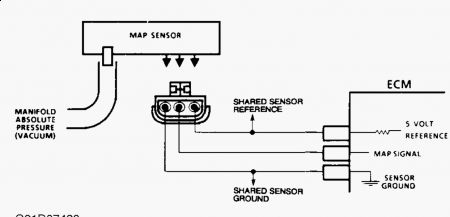

Dont forget to check for a bad MAP, unplug it and see if conditions improve.
https://images.2carpros.com/forum/automotive_pictures/62217_map_1.jpg
CODE P0101, MAF SENSOR CIRCUIT The Mass Air Flow (MAF) sensor measures the flow of air which passes through it in a given time. PCM uses this information to monitor the operating condition of the engine for fuel delivery calculations. A large quantity of air movement indicates acceleration, while a small quantity indicates deceleration or idle. MAF sensor produces a frequency signal, which cannot be easily measured. Diagnose sensor using procedures on this chart. Code P0101 will set when the following conditions are present.  Engine is running.  No MAF signal for over 4 seconds. With Code P0101 set, PCM will use a default value for airflow based on throttle position, IAC motor position and engine speed. PCM will illuminate Malfunction Indicator Light (MIL). 1. This step checks to see if PCM recognizes a problem. 2. Voltage reading at sensor harness terminal "A" of less than 4 volts or greater than 6 volts indicates a fault in circuit No. 492 (Yellow wire), or poor connection. 3. Verifies that both ignition feed voltage and a good ground circuit are available. Diagnostic Aids An intermittent may be caused by a poor connection, mis-routed harness, rubbed through wire insulation or a wire broken inside the insulation. Check for:  Poor Connection At PCM pin: Inspect harness connectors for backed out terminals, improper mating, broken locks, improperly formed or damaged terminals, and poor terminal to wire connection.  Mis-Routed Harness: Inspect MAF sensor harness to ensure it is not too close to high voltage wires, such as spark plug wires.  Damaged Harness: Inspect harness for damage. If harness appears okay, observe Tech-1 while moving related connectors and wiring harness. A change in display would indicate intermittent fault location.  Plugged Air Intake Filter: A wide-open throttle acceleration from a stop should cause MAF reading on Tech-1 to range from approximately 4-7 grams per second at idle to 100 or greater at time of 1-2 shift. If not, check for restriction. NOTE: Test numbers refer to numbers on diagnostic chart.

We are reading from the same manual. Following the troubleshooting flow chart is why I did a second replacement of the PCM. Had exactly the same reading with the new one. The harness checks fine, the routing is factory. Unplugging the sensor puts the idle at approx 2500 in N. IAC count is way high and the code for sensor low sets. Been trying not to just shotgun parts. Stores won't credit back electronic parts. Direction?

MAP sensor been checked? Is there vac at the line? Unplug it and see if that changes anything. Electrical! Check MAP for vac leaks too.

No MAP sensor in '94 3.8L. Vacuum sits at 20-22 inches and drops with added throttle. Looks normal

Disasembled throttle body. No significant slop or stickiness found,however.. turns out you had the problem pegged a couple posts back. While I had the thing apart, I checked the TPS sensor using 5 volts and a scope. At the very bottom of the travel of the arm, the pot had a tiny dead spot. Must have been enough to confuse the PCM but not stable enough to throw a code. I still can't see it with the Fluke meter on volts or ohms. I replaced the TPS and the problem is gone! Nice shootin' Merlin. Thanks!

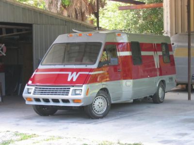

That 3.8 Buick drivetrain is in a salveged french built motorhome. Jon

Nice rig! I might get one when I retire in five years!
Good work on the TPS, some would have given up on it by now!
