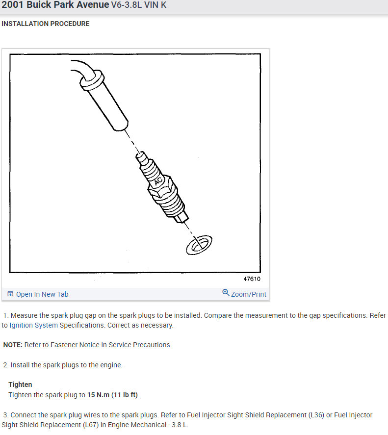

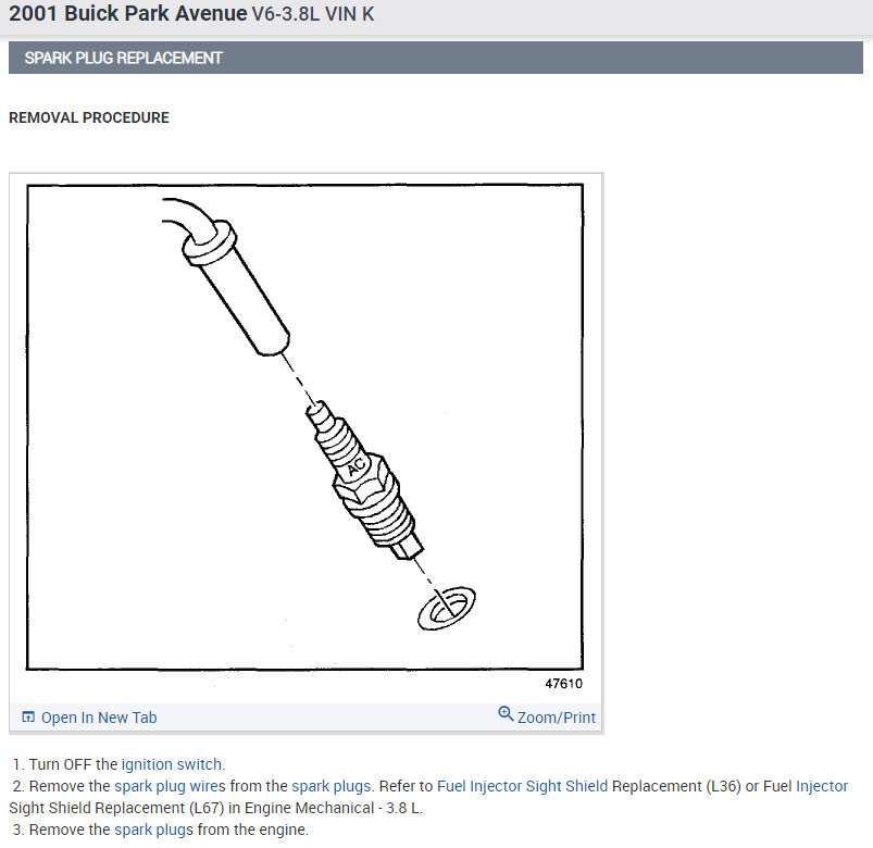

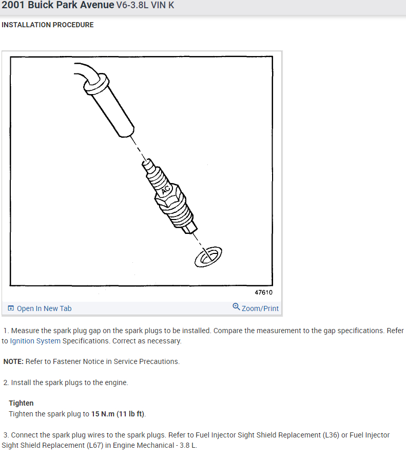

what should I be aware of before attempting to replace my sparks plug especially the three in back?

The spark plug installing on the Park avenue is straightforward. It's just the back 3 plugs are difficult to get to. You do not need any special tools except for longer extension with swivel.
Here is a helpful article on spark plug replacement:
https://www.2carpros.com/articles/how-to-change-spark-plugs
https://youtu.be/c9_NVXiwvYg
See attached for your vehicle specific info.
