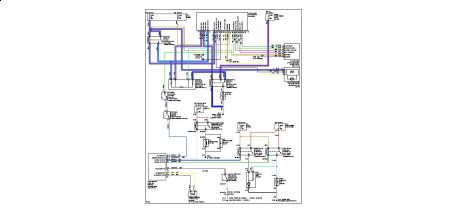

Hi, recently weve had a problem with the blower motor.at first it wouldnt shutoff even when the ignition was off.we pulled the 30amp fuse out so it wouldnt drain the battery.the nextday we put the fuse back and now the blower dont work at all!iv checked all the relays and fuses under the hood and under the dash and everythings ok.even went as far as pulling blower out and hooking it strait to a battery and its fine.i dont know what else to look at.any ideas would be helpful. Thanks.

start with making sure that you grounded the blower motor really good when you put it back in because those things have to have a good ground or they won't work

Check fuse 5D 25amp and fuse no.3 30amp, also the blower speed relay and the high speed blower motor relay to include the HVAC control module.
https://images.2carpros.com/forum/automotive_pictures/12900_blower_motor_12.jpg
