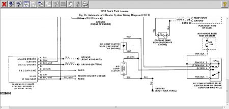

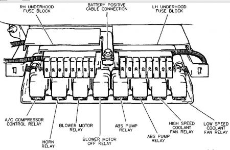

The AC/Heater blower motor runs all the time even with ignition off. Had to remove 30 amp fuse in engine compartment to shut off blower motor. Electrical diagram shows 30 amp fuse powers a blower motor relay. Found 6 relays under the fuse bank in engine compartment. With 30 amp fuse reinstalled disconnected each relay one at a time. The blower motor still keeps running. Could not find any more relays in the engine compartment. Please tell me where the AC/Heater blower motor relay is.

It sounds like you have a relay stuck on, here is its location so you can remove and replace it.
https://images.2carpros.com/forum/automotive_pictures/139033_ac_7.jpg
Here is a guide to help you test to confirm the problem. https://www.2carpros.com/articles/how-to-check-an-electrical-relay-and-wiring-control-circuit Please let us know what happens so it will help others

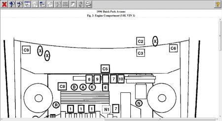

when I returned home today my blower motor would not shut off. It is continuously running. Where do I locate the relay for the blower motor?
Aug 19, 2019 at 6:34 PM (Merged)
  • 75,992 POSTS
Hi felicia110, Welcome to 2carpros and TY for the donation and selecting us as your auto repair site Feel free to ask questions at anytime and Merry Christmas and a Happy New Year 2010 Location: Center rear of engine compartment see road map below There's 2 relays one for the low and one high speed relay-No.8 is the low and high is no.9 -Check and test both
https://images.2carpros.com/forum/automotive_pictures/12900_blower_relay_7.jpg

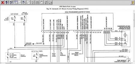

Put the relays back in place I want you to remove fuse no.3 30amp in the right underhood fuse block-did the blower motor continues to run?

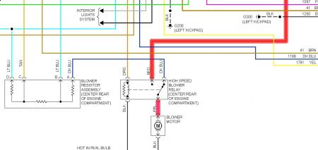

cab fan heater/air conditioner fan - continues to run after key switch is shut off, and key taken out of iginition. I disconnected the battery and let the car sit over night, and then re-connected the battery in the morning, upon re-connection the fan took off running again.
  • 75,992 POSTS
The red and purple wire are shorted together, where this 2 wires meet at is at the high speed blower relay socket-try clean out the relay socket could be corrosion that's causing it-
https://images.2carpros.com/forum/automotive_pictures/12900_blower_relay1_1.jpg

  • 75,992 POSTS
That red and purple wire are touching, you have remove the relays and it still come on, but when your remove the fuse it stops-The fuse is powered at all time thru the red wire if it touches the purple wire the blower motor will continuesly run-this is what's happening

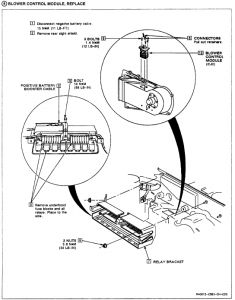

On the center rear of the engine compartment you will find the blower control module.It has a purple wire gray wire with a black stripe a black wire and red wire.Unolug it and see if the blower motor shuts off?Also a multi meter would be great to test some things.

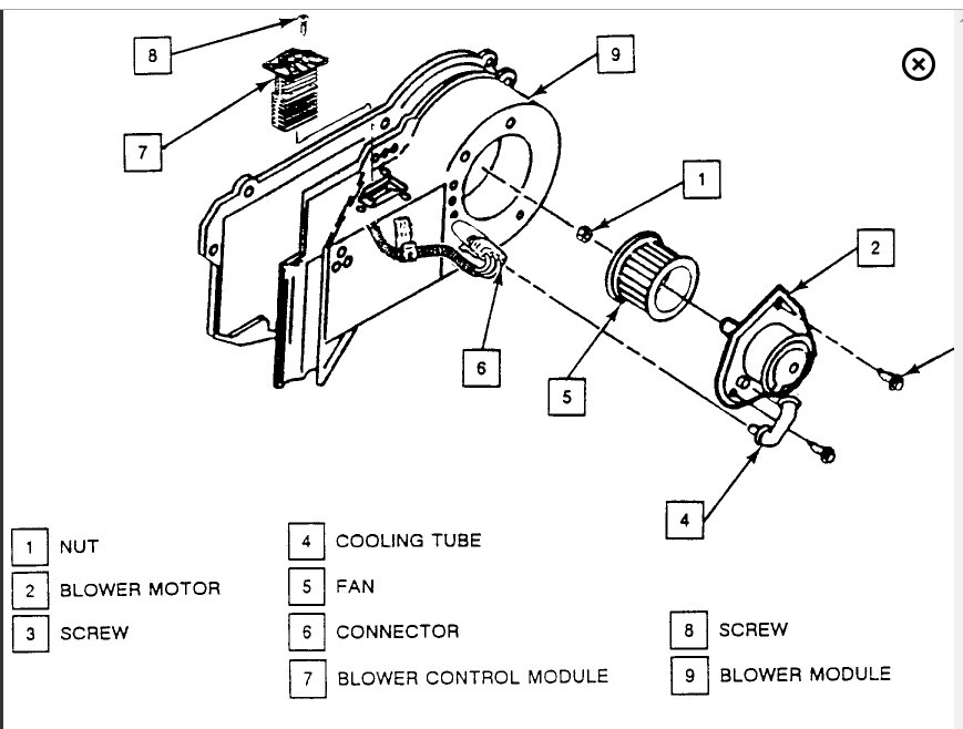

My heater fan stays on high speed even when the ignition is off and key removed. I think it is the blower motor resistor/module that has failed. Can you tell me if this is true and if so how to get to the module?
  • 75,992 POSTS
Inspect and test the blower motor control module at center rear of engine compartment

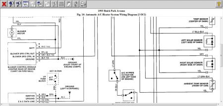

I gave you for an Auto HVAC system Park Avenue and Ultra
https://images.2carpros.com/forum/automotive_pictures/12900_hvac_5.jpg

  • 75,992 POSTS
https://images.2carpros.com/forum/automotive_pictures/12900_blower_motor_control_module_2.jpg

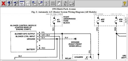

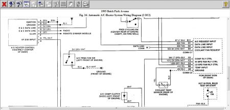

Are we talking about the condenser fan or the blower motor, if its the blower motor is doesn't have a resistor, you have replaced the blower control module -check fuse no.2 10amp in the relay center and also fuse no.3 30amp in the underhood fuse box if okay your problem is coming from the HVAC programmer AC/Heater EWD
https://images.2carpros.com/forum/automotive_pictures/12900_b1_16.jpg
https://images.2carpros.com/forum/automotive_pictures/12900_b2_16.jpg
https://images.2carpros.com/forum/automotive_pictures/12900_b3_9.jpg
https://images.2carpros.com/forum/automotive_pictures/12900_b4_4.jpg
