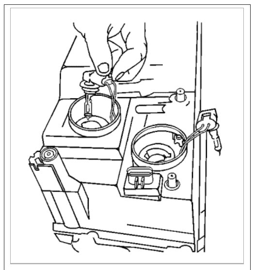

2004 Buick Rainier, 5.3 liter engine,
How can I change a headlight on the beast? I haven't been able to figure out how to get the grill work off?

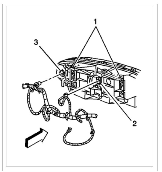

Hi:
Open the hood to gain access to the rear of the headlight assembly. You will see the electrical connections going to the assembly. Just turn them to the left to unscrew / clip the retainer, pull the bulb out, and reverse sequence to replace.
https://www.2carpros.com/articles/how-to-replace-a-headlight-bulb
Here are diagrams to help you see (below)
