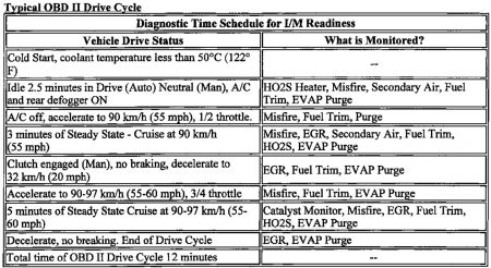

It has 69500 miles on it - I've had it for about 5 years. It won't pass NY inspection. I took it to the mechanic, and he did something, and said I needed to drive it around to reset the computer - highway is best. So I drove it and it still didn't reset. I drove it again yesterday, more than 100 miles (nearly 200 miles the day before), and everything reset except the evaporator system. What do I have to do to get it to reset so the car can pass???

Heres the complete cycle:
https://images.2carpros.com/forum/automotive_pictures/30961_gm_drive_cycle_1.jpg
https://images.2carpros.com/forum/automotive_pictures/30961_mitchel_21.jpg
Two things that will help is the highway cruise over 40 mph should be as steady of a throttle as possible. The fuel tank should be between 1/4 to 3/4 full.
