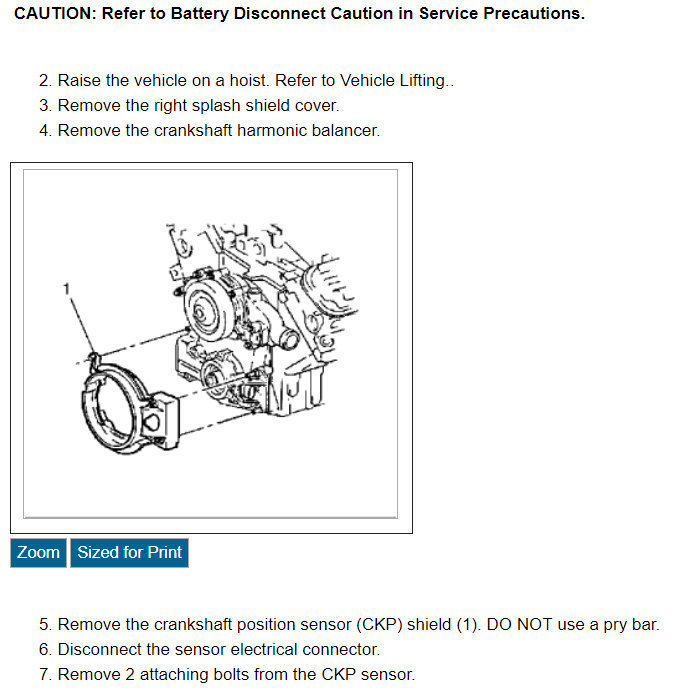

When driving the car acts like someone turns the key to off. Sometimes will start back up after entering the key-less code. What may it be?
Oct 14, 2009 at 2:21 AM
  • 110,244 POSTS

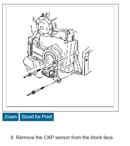

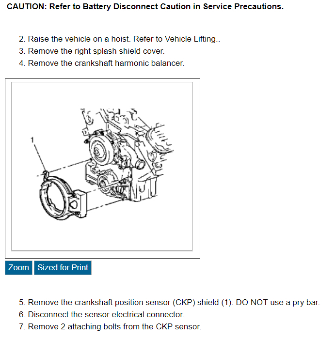

This sounds like the crankshaft angle sensor is going bad which is common. Here is a guide to help you see what you are in for when doing the job and the diagrams below you show the location for your car.
Cheers
Nov 4, 2009 at 5:28 AM
KENDRARUSSELL
All fixed. Thank you so much. I love this site.
