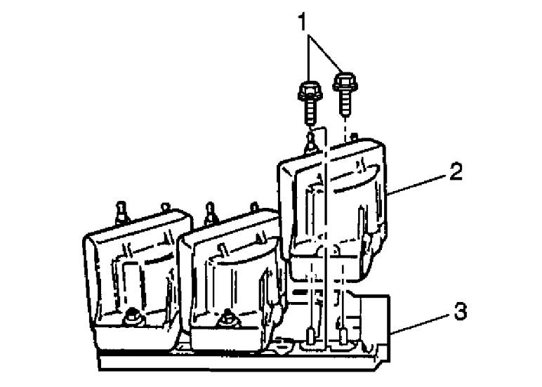

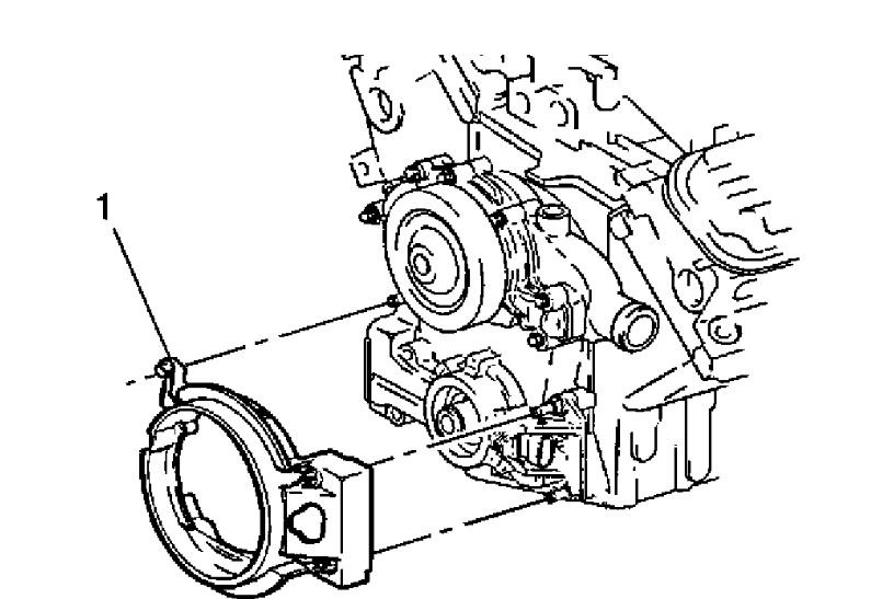

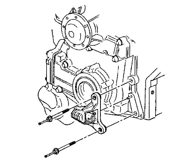

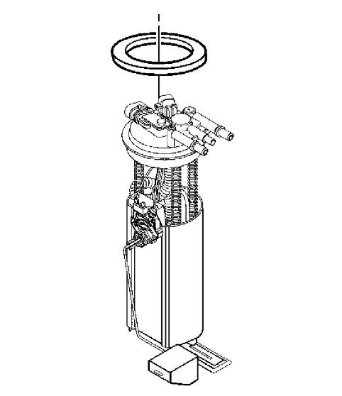

Good morning,
This could be a spark issue or a fuel delivery issue.
https://www.2carpros.com/articles/engine-stalls
A bad ignition control module will cause this as well as a bad crank sensor.
Both items will not code so old fashion diagnostics has to be done.
If it does not start right back up, it could be fuel delivery and that could indicate a failing fuel pump.
If it starts right back up, it is most likely spark related.
