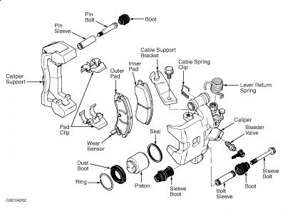

2002 Buick Lesabre 6 cyl Front Wheel Drive Automatic
I too need to remove and replace the left rear caliiper. I know from when I did the pads that I lremoved the lower bolt and rotated the caliper out and then replaced the pads. But to REPLACE the caliper, how do I get at whatever is behind the rubber cap where the top bolt is. Is it a torx, allen? So PLEASE tell me how to remove the caliper?

Hi Remove park brake cable from caliper. hose bolt discard two washers. remove lower bolt rotate caliper up slide off top pin. Diagram will help Thanks for donate
