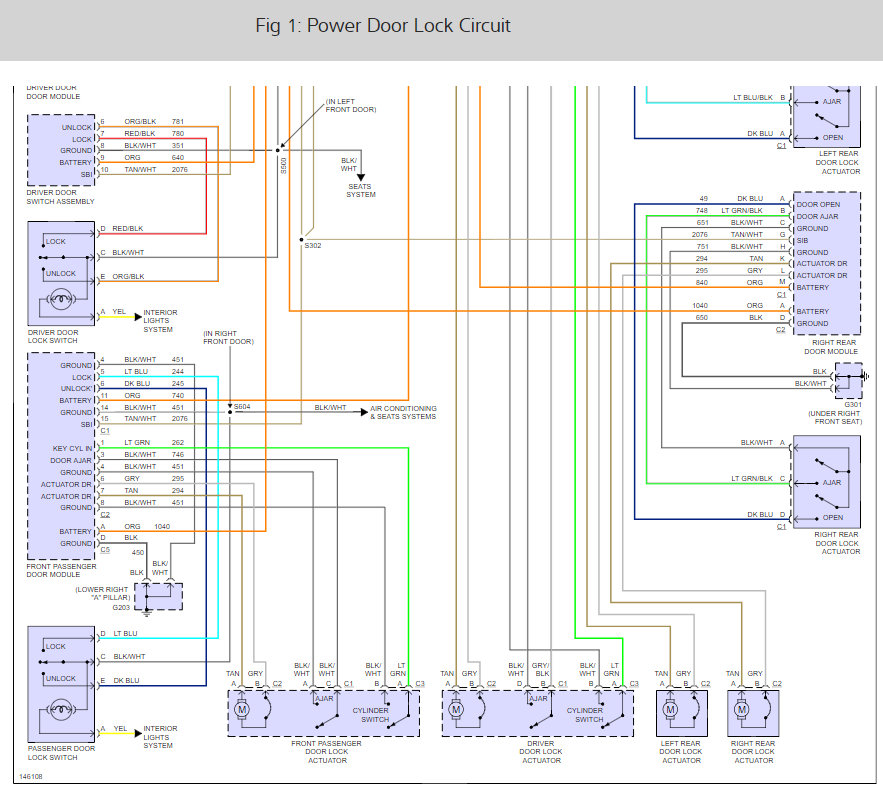

Except for the driver side window and door lock, the others don't work. fuses are all good. What could be the problem?
Apr 12, 2009 at 2:31 PM
  • 54,840 POSTS

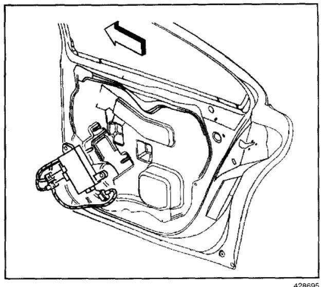

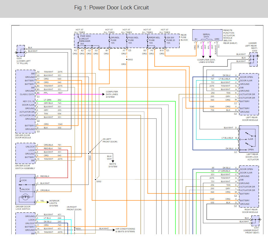

There is a driver door module that goes out on these cars. Here is a wiring diagrams for the windows so you can see how the system works.
You must remove the door panel to get to the module. Here is a guide to help you see what you are in for when doing the job.
