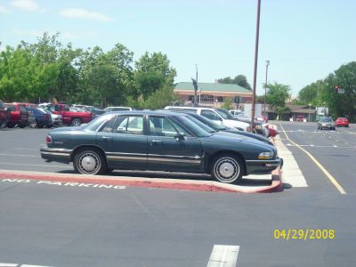

As of 4-26-08 my buick has had a lower than normal idle and now I have to slightly press the gas pedal down to start it.
Within the last month, I have replaced the sparkplugs and wires, the trans fluid and filter, engine oil and filter, and fuel line. {Within the last 3 years, the radiator, the heater core, the fuel filter, the tires, alternator, new battery, and a new timing gear set}
It had been running normal until the low idle. With the low idle the engine does seem to run just a very small amount warmer.
(might this be related to the summer blend of fuel in California?) Any ideas would be appreciated, Thank-you.

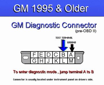

https://images.2carpros.com/forum/automotive_pictures/62217_95_OlderGM_17.jpg
Cross these two terminals as shown, then turn the key on. Count the flashes, a 22 will flash as 2 flashes then a short pause, then 2 flashes, if more than one code is stored, the pause will be longer. The codes will display three times and end with 12. Write them down and post here. This connector is right under the middle of the dash...Let me know what you find, I think it will be either a bad ECT or TPS...
