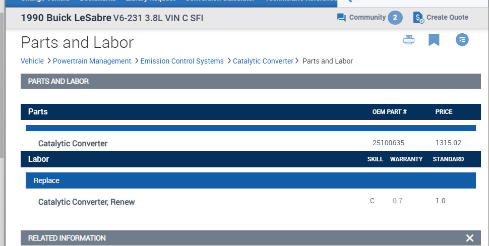

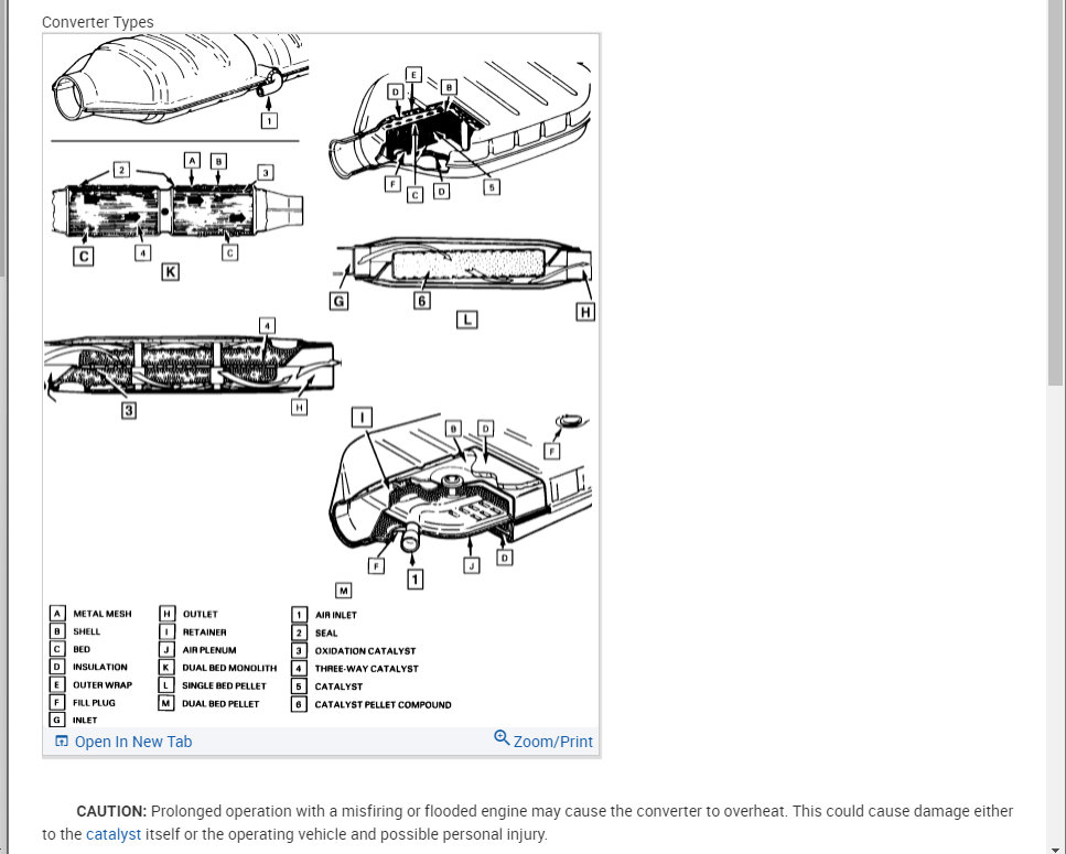

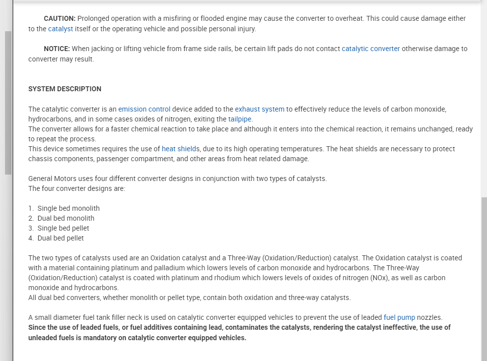

If you are failing due to high hydrocarbons, then the most likely cause of this is the converter has failed and is no longer reducing the emissions enough.
Here are a couple guides that will help with this:
https://www.2carpros.com/articles/smog-test-inspection-information
If you have no engine issues other, than it is failing this test then I would suggest changing the converter and then having the vehicle retested.
Please see the info below on this and let us know what questions you have.
Thanks
