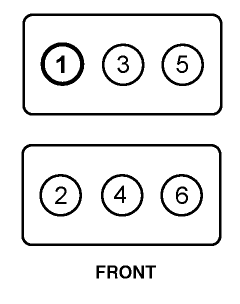

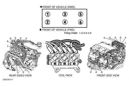

I just changed spark plugs and my car now is in rough idle and sputtering. I used Autolite platinum. I want to know the spark plug order. I numbered my wires and I may have messed it up. Is it -2-3 along the fire wall with 1 being on the passenger side? And 4-5-6 in the front with 6 being on the passenger side. I assume that is to correspond with the numbers on the distributor cap.

The part that says front in the diagram is passenger side. You have a coil pack, no distributor, correct?

Thanks for the diagram. I had two and four switched. Yes, I have a coil pack. I mistakenly said distributor, also working on my old gas tractor.

DOCFIXIT
  • 18,828 POSTS
Fire wall side front to back 1-3-5. Radiator side front to back 2-4-6.

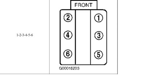

Firing order for 99 buick century
Thursday, November 26th, 2020 AT 10:17 AM (Merged)
  • 75,992 POSTS
Here is the engine ignition Firing Order 1-2-3-4-5-6 Check out the diagrams (Below). Please let us know if you need anything else to get the problem fixed.

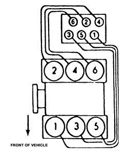

2CARPRO JACK
  • 11,533 POSTS
Firing order 3.8.
https://www.2carpros.com/forum/automotive_pictures/1639_38_1.jpg
firing order 3.1, 3.4.
https://www.2carpros.com/forum/automotive_pictures/1639_3134_1.jpg

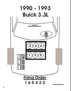

What is the firing order and which side is number 1 plug on?
Thursday, November 26th, 2020 AT 10:18 AM (Merged)
LEGITIMATE007
  • 5,121 POSTS
Firing order and wire order for buick 3.3 v6
https://www.2carpros.com/forum/automotive_pictures/88091_buick_33_1.jpg

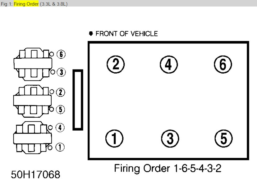

LAKEFRONTLIVIN
How come the #4 plug wire is going to cylinder #2. I hope I'm reading the diagram right?

ZACKMAN
  • 4,202 POSTS
Try one of these.
Late 92 (sometimes known as 1993)
https://www.2carpros.com/forum/automotive_pictures/55316_92centuryfiring_1.jpg
1993
https://www.2carpros.com/forum/automotive_pictures/55316_93centuryfiring_1.jpg

JDL
  • 16,098 POSTS
3.3 litre engine
https://www.2carpros.com/forum/automotive_pictures/170934_33_litre_engine_1.jpg
Firing order is 165432.
