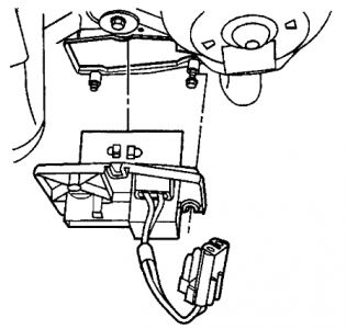

I'm not sure if you have battery issues now due to the blower problems but to resolve the blower problems I would replace the blower motor resister which incorporates the blower relay and likely the reason the blower won't shut off. It's located next to the blower motor under the dash on the passenger side.
https://www.2carpros.com/forum/automotive_pictures/561653_Blower_motor_resister_00_Century_1.jpg
