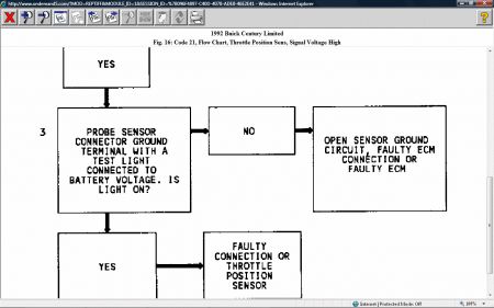

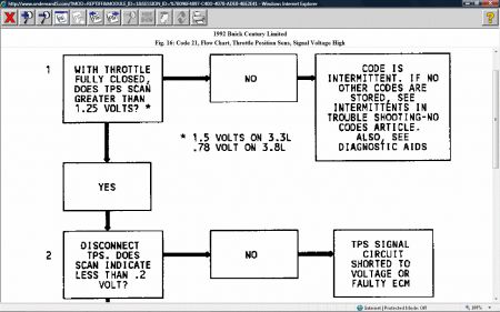

Why when I am driving does the car turn off, and when I put it back in park it starts right back up again like nothing happend?

Well I bought a code scanner and the results were no RPM pulses are present during engine off testing and TPS sensor high voltage. Can you help

Here's the flowchart for TPS, Test this way!
https://images.2carpros.com/forum/automotive_pictures/62217_Centurya_1.jpg
https://images.2carpros.com/forum/automotive_pictures/62217_Centuryb_1.jpg
