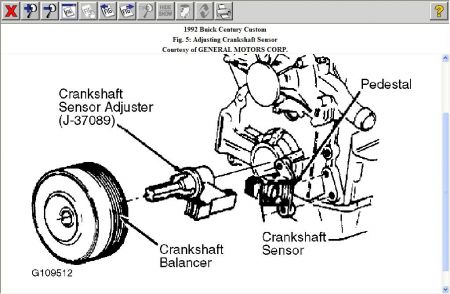

Why did you rule out he crank sensor? Is this a 3.8? If so they had problems with the crank sensors. Do you have injector pulse?

Why have you ruled out the crank sensor? The sensor might not be faulty but could be out of adjustment resulting in the intermittent non starting.
https://www.2carpros.com/forum/automotive_pictures/192750_CrankSensor92BuickCentury_1.jpg
Have you confirmed that the non starting is due to sparking problem? The most common cause of no sparks are the crank sensor.
ECM are quite reliable and seldom gives way though it does breaks down and I would go for the crank sensor first.

How hard on a scale of 1 to 10 is it to adjust or check the sensor? I use to be a GM Mechanic before I joined the Air Force in 1989. :>)

Hi DKTSgt,
With the proper tools, I would say it is a 3.
2CarProJack asked if there were injector pulse, did you check those when it could not start?
Is it a 3.8liter engine?
CRANKSHAFT POSITION SENSOR (DIS)
1. If a "Scan" tester is available, scan RPM parameter while cranking engine. If RPM is indicated, crankshaft position sensor is operating properly.
2. If "Scan" tester is not available, disconnect crankshaft sensor harness connector. Set ohmmeter to 2-k/ohm position, measure resistance across sensor terminals. Resistance should be 900-1200 ohms.
3. Set voltmeter on the 2-volt AC scale. Crank engine and measure voltage across sensor terminals. Voltmeter reading should be.1 volt or greater. If resistance reading is not as specified or sensor does not produce a voltage reading, repair faulty wiring or crank sensor.
