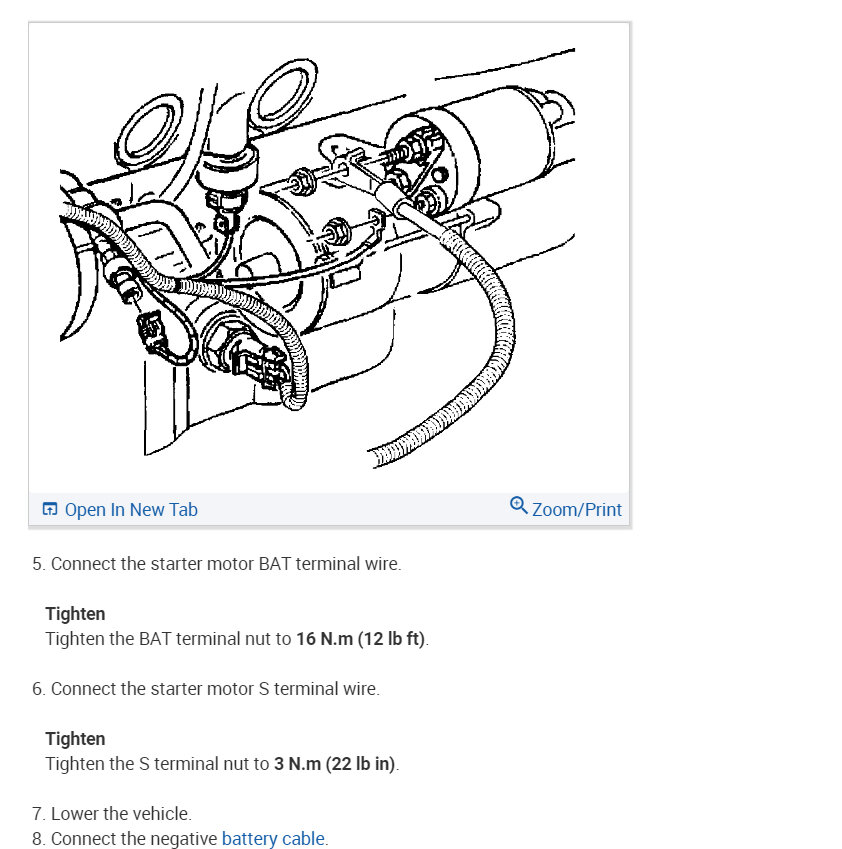

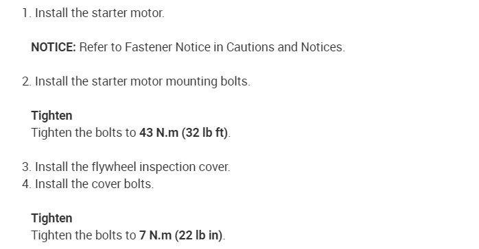

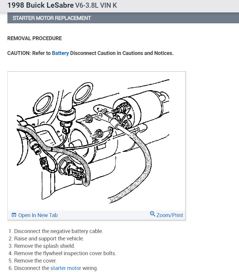

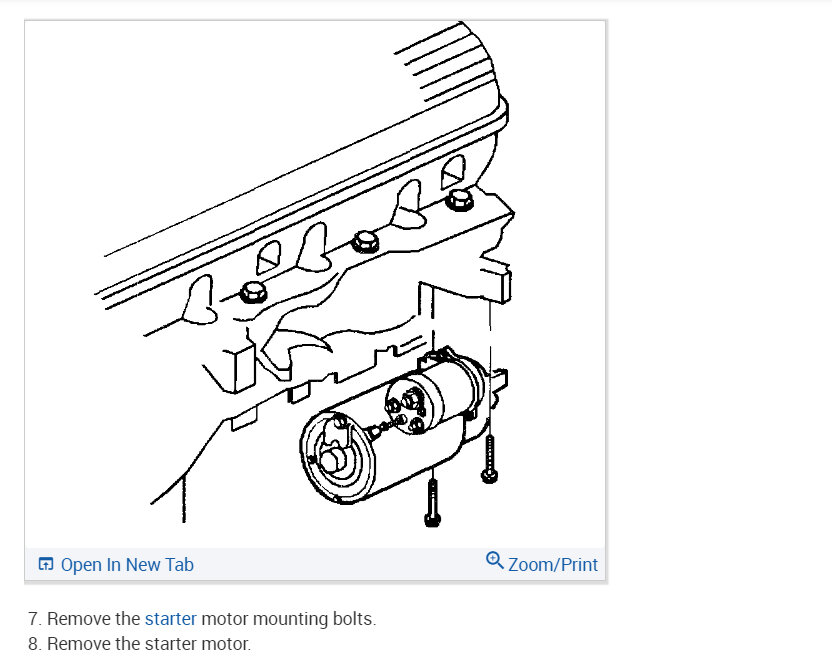

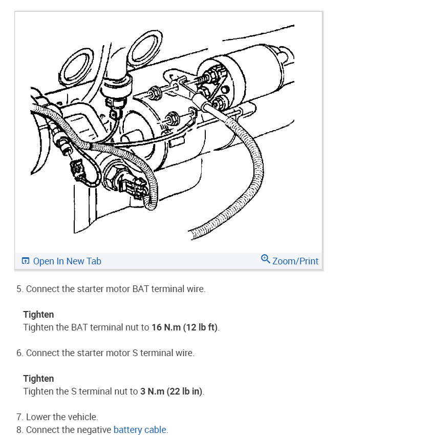

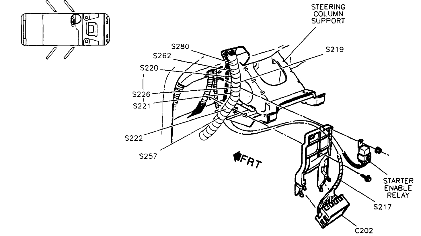

Okay, let's check for power at the trigger wire of the starter when the key is in the crank position. Here is a guide to help us because it sounds like the starter when out:

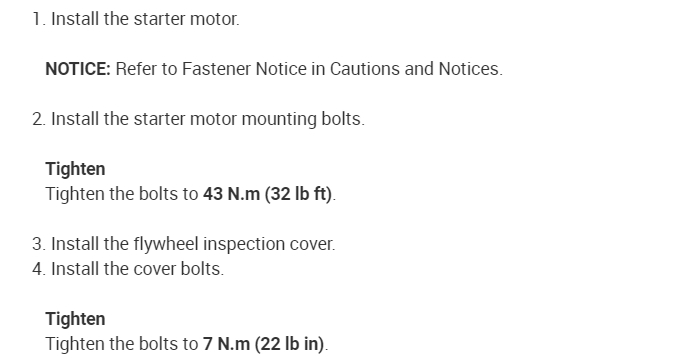

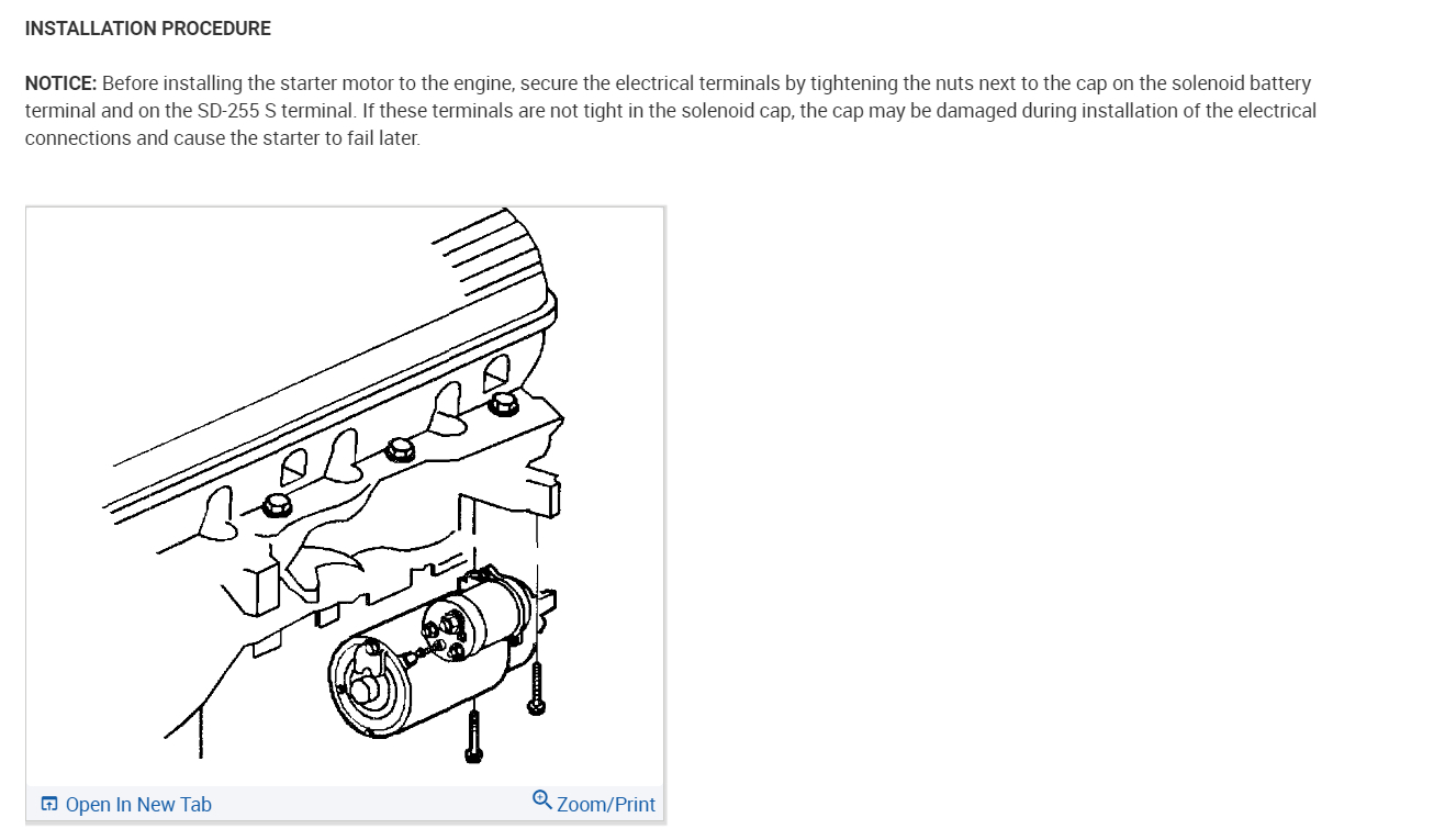

Here is how to change the starter motor out in case you need it. Also try to crank the engine over in neutral. Check out the images (below). Let us know what happens and please upload pictures or videos of the problem so we can see what's going on.

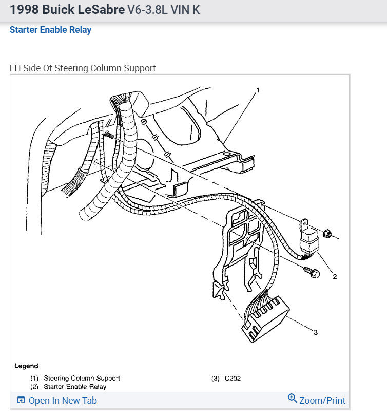

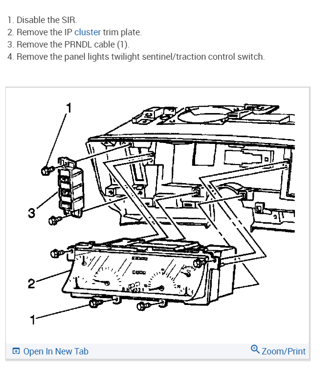

Sure, here is the location of the starter relay. Check out the images (below). Please let us know what happens.

Ken,
Thank you for the starter relay location illustrations.
However, despite repeated efforts to peer deeper behind the instrument panel/cover, I could not locate the relay. Of course, I am familiar with removing the lower dash panel which contains the Mini fuse panel and the data terminal, so this area is somewhat familiar.
With that large dash panel hanging (supported) near the floorboards, I used a flashlight to search behind and higher, for any switch matching the illustration you sent. From my own research, the relay location is described as to the left of the steering column support, and above.
The actual location would be easier to find if I had a photo of that area, showing the relay location in relation to the fuse panel and/or steering column support. I am searching now for such a photo.
May 13, 2023 at 11:18 AM

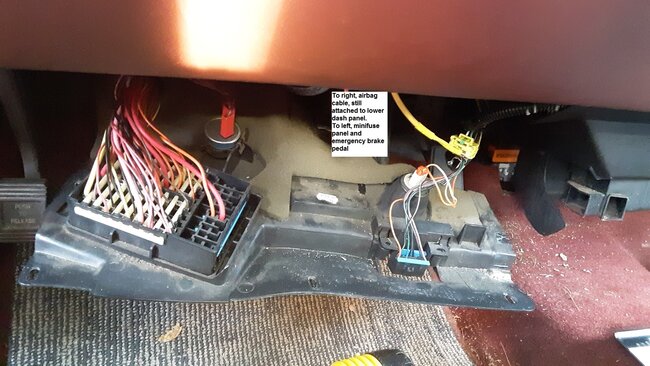

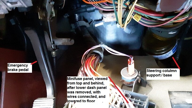

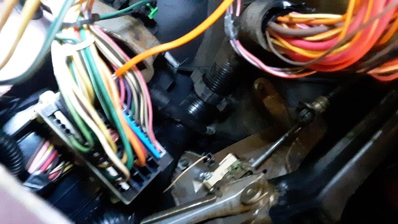

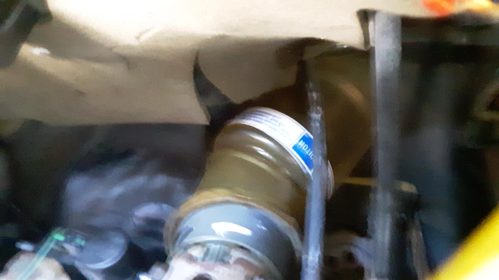

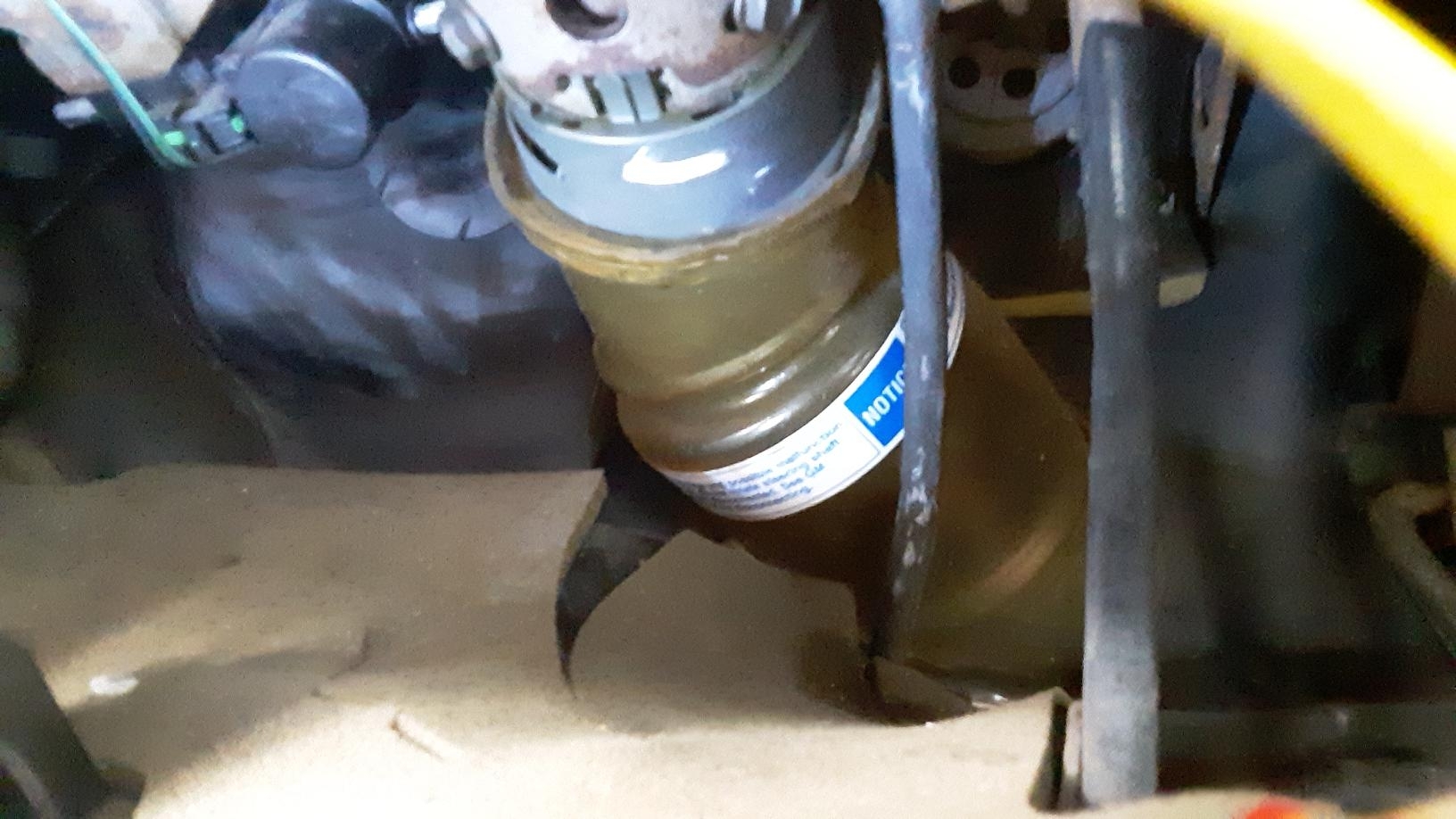

Here are two photos taken of the under-dash area, with a caption on each photo to help orient your view. The only verbal instructions I could find referred to a location (1) to the left of the steering column support, (2) above the fuse panel, and (3) near the windshield cowl base. (That may mean more to you than it does to me.)
The only location I could not examine very easily is another wire junction with a thick white nylon connector, and I am not sure how to check behind the connector.
May 14, 2023 at 6:29 PM

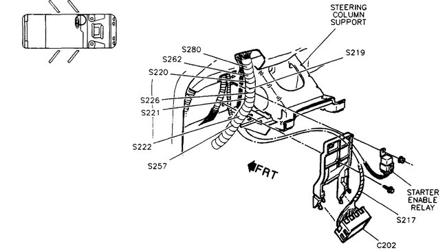

The relay is located at the steering column support so you will need to look up under the dashboard further. I would use a flashlight. Please let us know what you find.

No results, so far. I moved the driver's seat backward to enable me to lie on my back (awkwardly) and shine the large, hand-held lantern around the interior, well above the steering column. Found plenty of connectors, but none had dimensions of the four- or five-bladed starter relay the auto parts store provided. The one cover I did not look behind protects the gas pedal linkage, but I used my fingers to detect anything behind the gas pedal linkage cover. Do you have any idea which side of the steering column to search?

They show the relay above the main electrical connector at the right side of the column, can you upload more images?

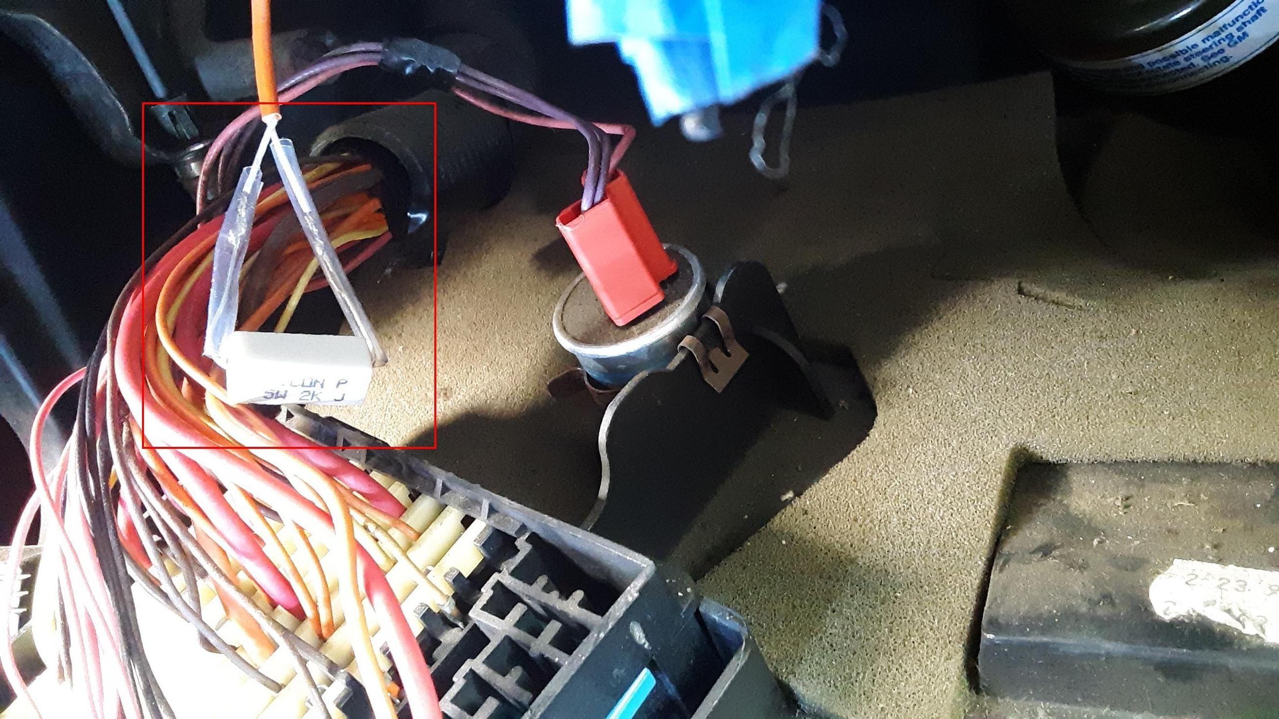

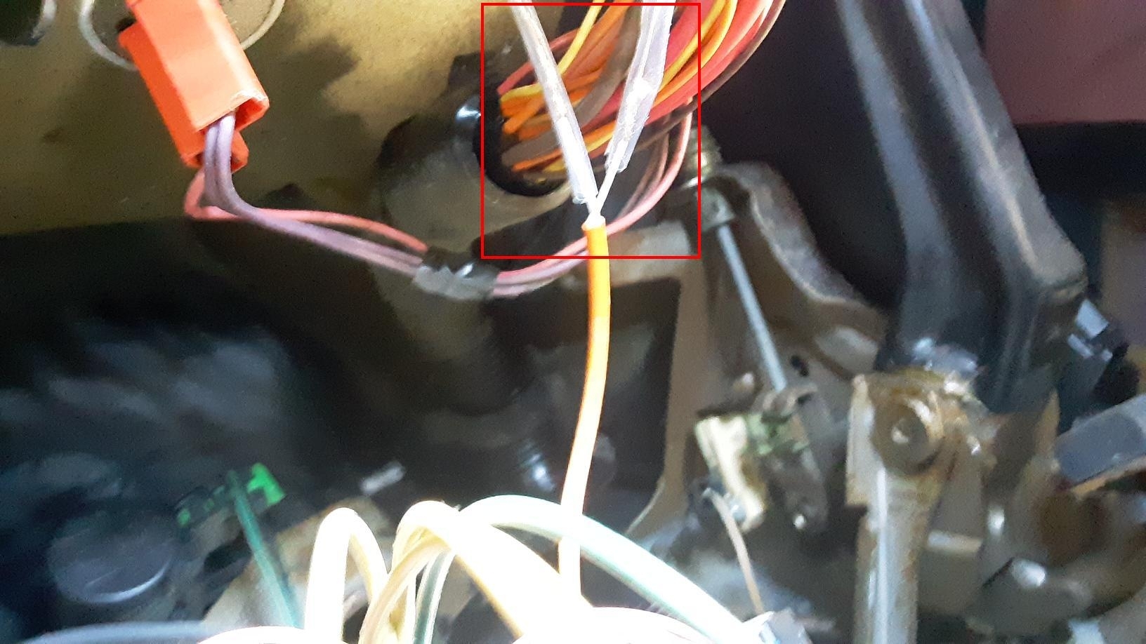

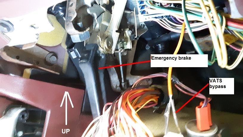

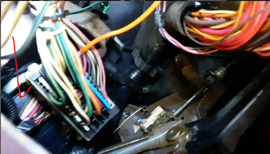

Ideally, my camera lens should be an ultra-wide-angle type. My current phone camera lens is not wide enough (it is only face-oriented, for selfies, presumably), and orienting details are lost when I move farther inside the dash.
Nonetheless, I've attached a few photos, so let me know what you find.
* My home-made circuit jumper is found in two photos and is outlined in a red rectangle.
May 22, 2023 at 5:17 PM
  • 55,456 POSTS
Thanks for the photos, yep, that looks like a security system bypass. Is the security light flashing? Here is the starter wiring diagrams so you can see how the system works. I don't see the starter relay in those photos. It is on the bracket that holds the main electrical connector. Check out the images (below). Please let us know what happens.

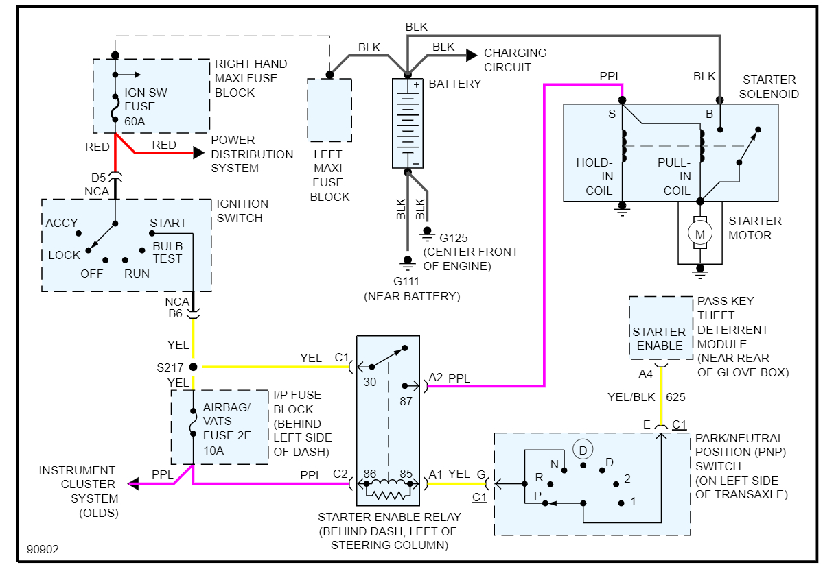

Regarding power through the ignition switch, I checked for end-of-circuit power through the ignition switch using an assistant to press the brake pedal while in Park and turn the key to start. Absolutely no voltage showed on my VOM, connected directly to the S connector (as described above in an earlier post).
As you point out, the problem lies somewhere in the circuit input for ignition. That is why I tried the "obvious" option of checking the starter enable relay. That relay is still invisible, despite many evenings of twisting myself onto the under-dash floorboard to search more closely.

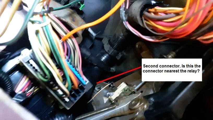

The most specific information I have was found just hours ago, and I have spent as much time as I had taking photos and searching, according to the information. That information says, "The (starter-enabled) relay is found under the left-hand of the instrument panel, above the instrument panel fuse block. Look just left of the steering column support and on a bracket beside the main wiring conduit. You must remove the fuse block cover and panel."
* I have labeled two of the attached photos for your convenience, but hope they are not confusing in their orientation.

Thanks for the photos, I think I see the relay above the main electrical connector. If so let me know if there is activation voltage and output voltage. I think we are getting closer to fixing the problem.

If I can confirm the relay is "above" the main electrical connector-- that is, if I can find it-- replacement of the relay would seem in reach, at last. In the next 24 hours, I must plunder through my collection of auto tools to find the circuit tester.
At this point, I should mention I have located something of interest near the main electrical connector. With my fingers and a small lantern flashlight, I spotted a small cylindrical part, about the size of the relay cube. But its cylindrical/pot shape does not match either the four- or five-bladed relay cubes I bought from O'Reilly (making sure to specify Buick98, 3.8L, LeSabre Custom).

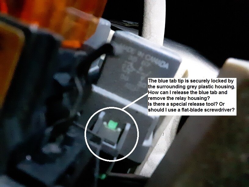

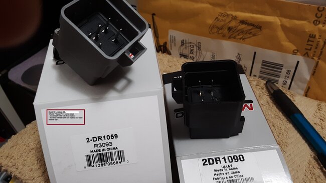

Here is a photo of the starter enable relay, but of two models, one with four blades, the other with five (and a steel retainer clip).
Note the small inset text box, with relay brand and each model number.

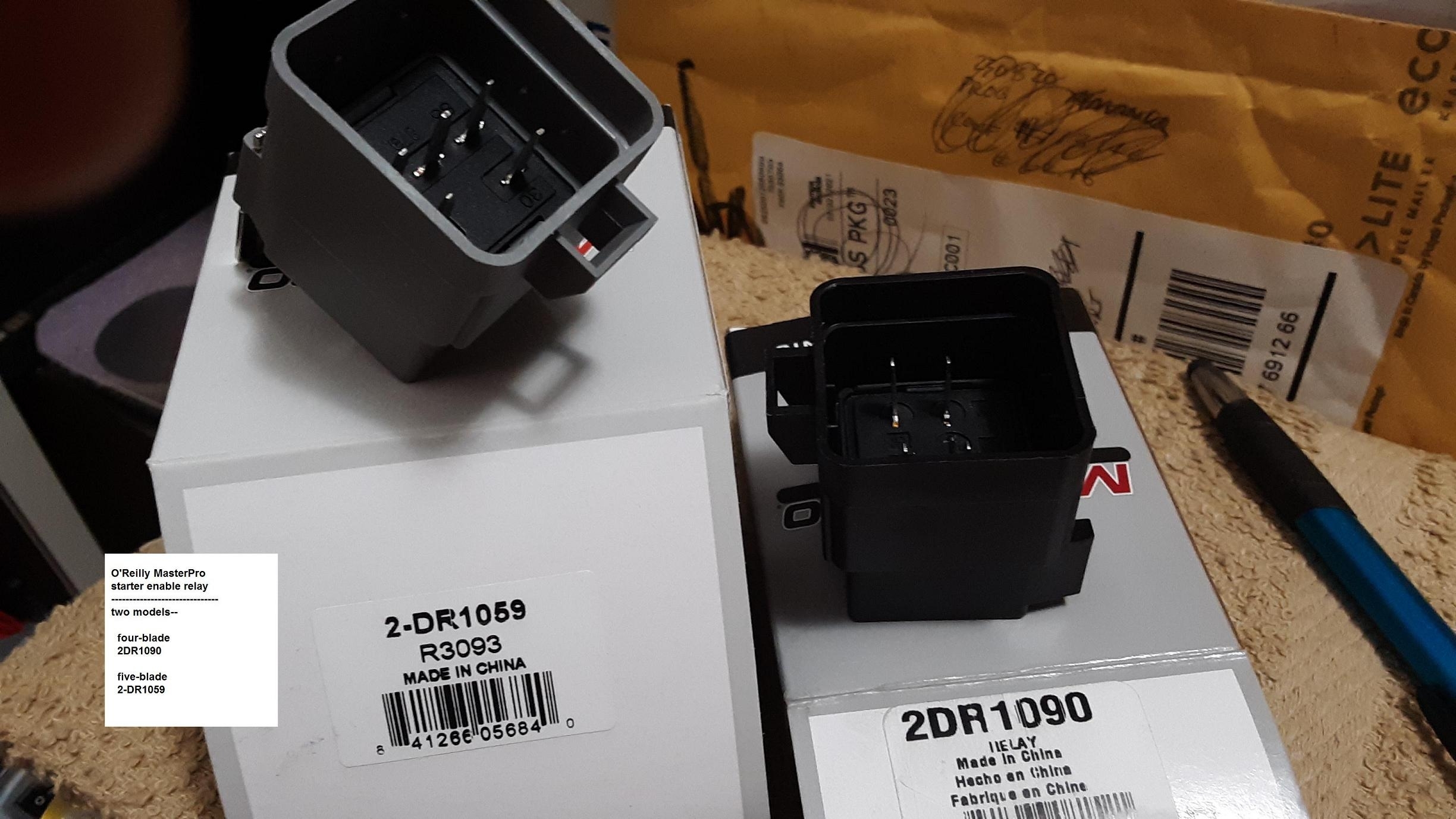

Here is another photo of the starter enable relay, which comes in two models-- one with four blades, and the other with five blades (and a steel retainer clip on the relay body).
Note the small inset text box, with relay brand and each model number, which I tried to make more legible.

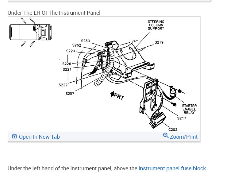

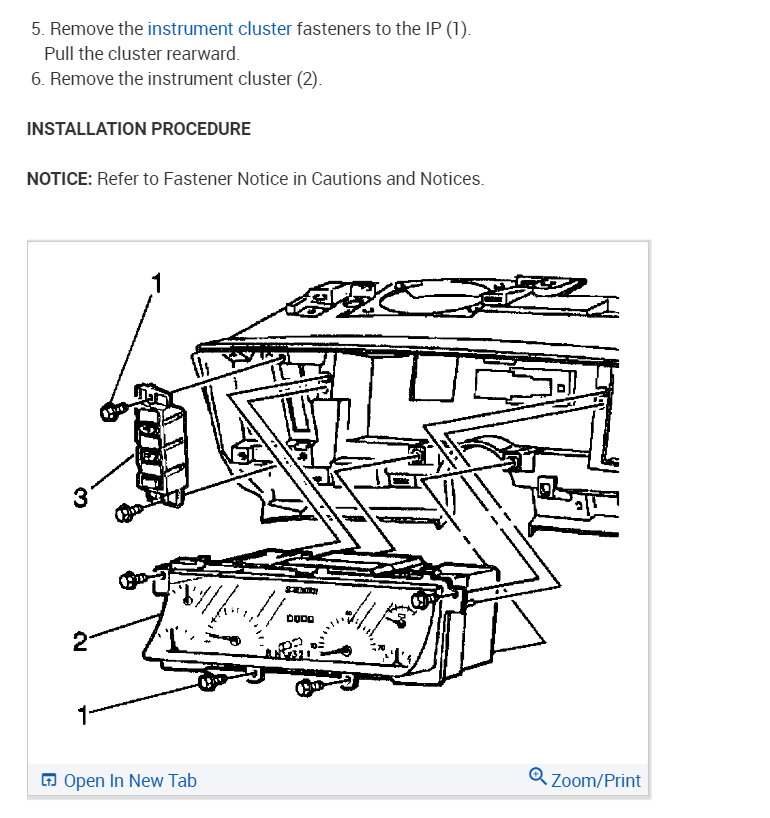

Here is where it looks like it might be, check out the images (below). Please let us know what happens.
Jun 15, 2023 at 5:29 AM
ALPHAA10
  • 235 POSTS
Thanks, I'll look behind the main electrical connector, next. What threw me off was the source I quoted, saying the relay is on a bracket beside the main connector-- not behind it.

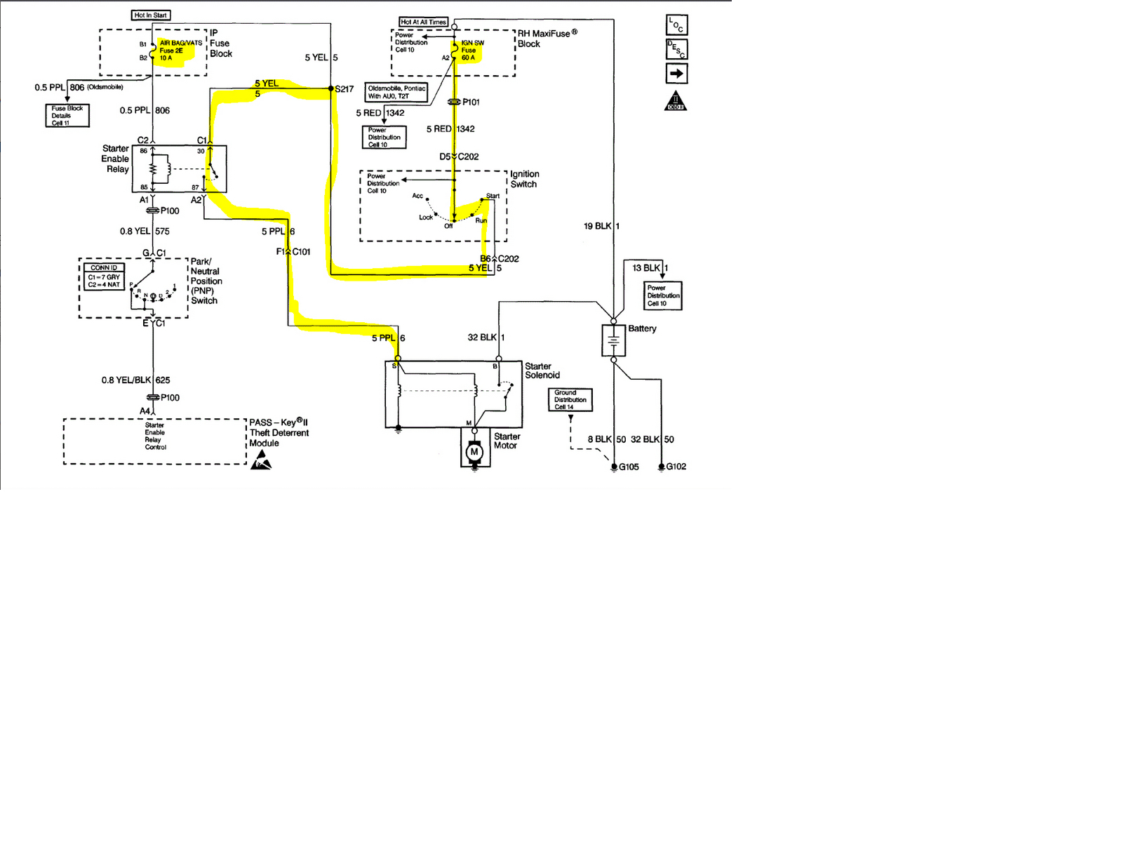

Quite a few forums address various GM issues, and some offer schematics which may vary from GM model to model. Somehow, my Buick 98 starter enable relay location is clearly visible on the schematic you sent (in a previous post), yet cannot be located visually in any of the forum offerings. The location you arrowed for me in a photo as a likely position turned out to have nothing behind it.

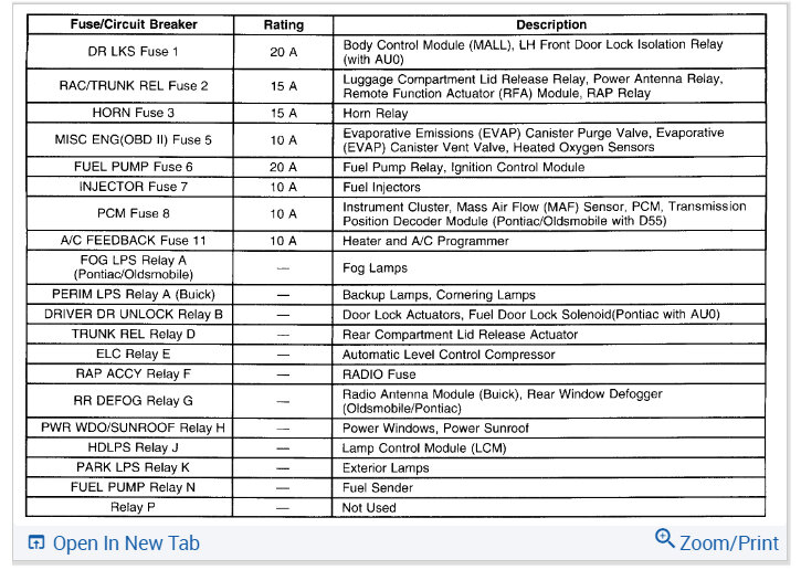

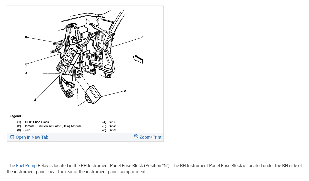

Great attitude! I checked for a 1999 year car and they say it is in the fuse panel, maybe your car was in a mid-year update, please check out the images below. Please let us know how it goes.
Jun 20, 2023 at 2:54 AM
ALPHAA10
  • 235 POSTS

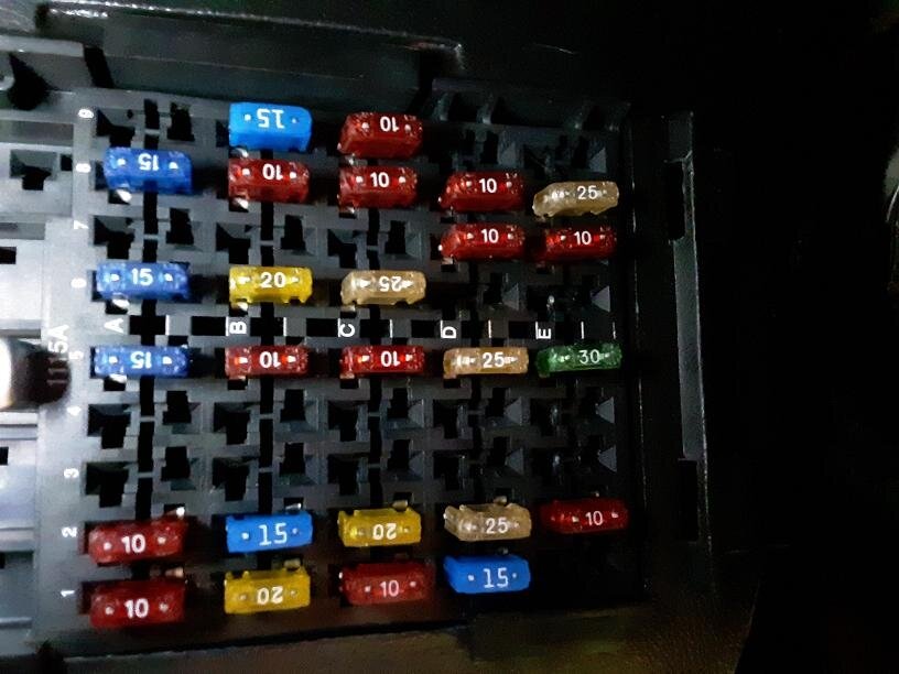

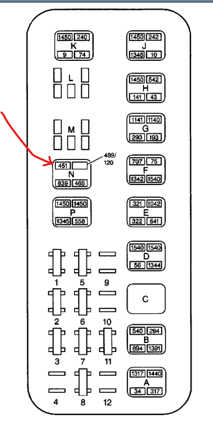

The fuse and relay panel layout does not match my vehicle-- but it was a good, intuitive try. Would the VIN help? VIN 1G4HP52K5WH500185

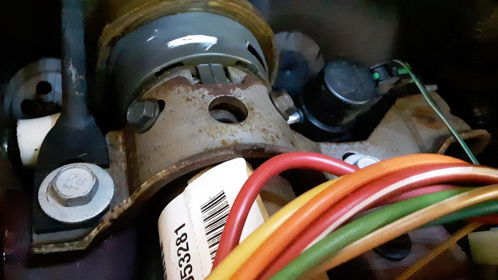

I have attached a photo of the below dash, inside MiniFuse panel (driver left), showing no relay cubes. Tomorrow, or whenever I can catch a break in the rain, I'll take another, better photo of the inside fuse panel (115A) and the outside MaxiFuse panel and outside relay panel layouts.

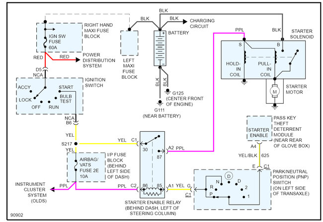

You indicated earlier it is time to trace the ignition circuit. What do you think about this approach?-- from the schematic, identify the two lines leading to and from the starter enable relay, then trace each line physically from each end of the circuit back to the relay. Somehow, the incoming pair and outgoing pair ought to coincide at the relay location. I know from the schematic there is a yellow (Y) and purple (PPL) wire pair entering and exiting the relay. That indicates the enable relay is (probably) a four-blade unit, although the line drawing clearly shows a metal clip attached to the relay body and suggests a five-blade relay unit.
Since I never have traced auto circuits before, I need to spend some time outside looking at the schematic, then tracing the lines.

Okay, so it looks like we are stuck with finding the relay under the dash on the left side. Sometimes they are tucked up behind a brace or something. Also look on top of the column as well. I have seen them behind the instrument cluster as well, here is how to remove it for inspection. Also, maybe you can lower the column to gain better access. Check out the images (below). Please let us know how it goes.

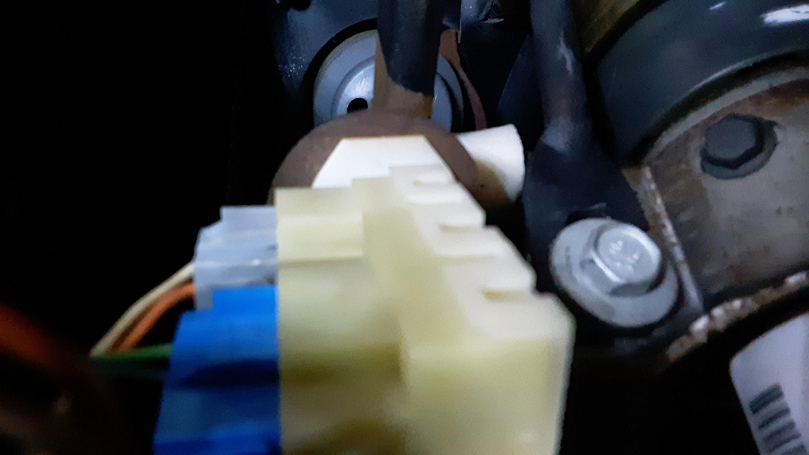

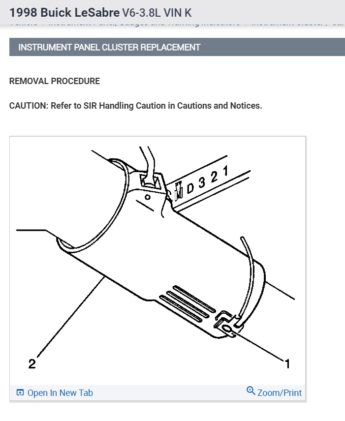

Updating you: My tendonitis has vanished, but the rain continues. Despite that, I have traced the positive line from the battery to the relay and Maxifuse bank, and this is where the fun begins-- at the power distribution bus.
According to all references I have read, the starter enable relay is inside, beneath the dash, but just to be sure, I first looked over each relay or fuse on the firewall power panel, and found no label referred to a starter.
Looking beneath the dash, again, I had no better luck, so far. So, the rest is tracing down from the steering column, to reach the circuit contact points for the starter trigger circuit.
In that regard, a question-- Is it necessary to pull the steering column housing? That is, do you know of a better way to check contact points from the ignition switch?

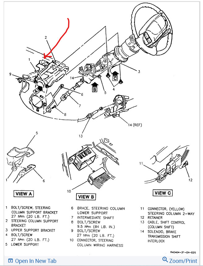

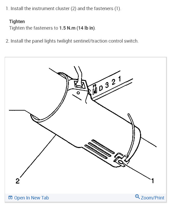

I found a better image for the location of the relay; it is way up above the steering column mounting plate. Please check out the images below.

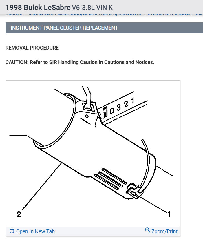

Of course, it is perfectly logical that no accurate Buick-issued instructions for the relay location exist, but another, unlabeled Buick view might contain exactly what we need. Hope so, anyway.
Should I remove anything on the steering column and/or its support bracket to reach this location? I know it's largely up to me to determine that, but I just wondered.
Jul 8, 2023 at 9:41 AM
  • 55,456 POSTS

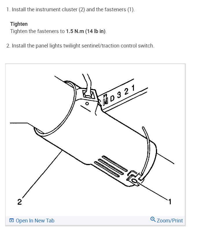

I would use a flashlight and mirror on a stick to help see up and around the column. You should be able to see it.

Of course, it would not make sense for my VATS bypass resistor to be the problem-- even if of the wrong value. Currently, the VATS system seems normal-- its "Security" warning does not flash, but stays solid for about five seconds, and then disappears. Besides, I operated the car with no cranking problem when the resistor was below the ignition key's 1861 Ohm value.

Another update--
1. I checked thoroughly with flashlight and mirror but saw nothing which matched the size and shape of the starter enable relay purchased from the manager of my local O'Reilly auto parts store. However, while searching in exactly the area you and others suggested, I did find an oddly shaped plastic connector which had four wires running from it-- two light yellow, one light yellow with black stripe and one green. Since the connector was firmly in-place, I decided not to apply major force until I understood which way to pull or pry.
2. Now, the interesting part. I had put away all my tools and was on the way inside the house, when I stopped, recalling the image of something odd I had seen beneath the dash, in the Mini fuse panel. I turned around, unlocked the car, and looked carefully at Mini fuse location 2E, which I had presumed was empty on first inspection (not remembering this is the starter enable circuit fuse location). Looking more closely, I saw-- inside each leg of the socket-- was what appeared to be the silver stump of a Mini fuse.
Apparently, fuse 2E had blown/melted, and its red plastic cap had fallen off, leaving only the two metal remnants of the fuse, deep in the socket. Tomorrow, I'll use a turkey basting needle to probe inside the socket to pry out the fuse leg stump. If I am successful with that operation, the next step is to find another 10A fuse, or borrow one from the spares in the fuse panel and see what happens.
Jul 14, 2023 at 12:22 PM
