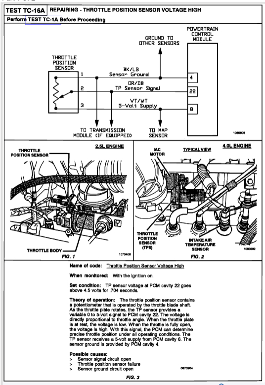

I have the vehicle listed above (xj model) when I take off it bucks and acts like it’s about to run out of gas! I have a dtc 24 but that tells me it’s the throttle position sensor, and I have already changed it. I replaced it with a Mopar TPS I’m lost and confused at this point.
Jan 20, 2020 at 7:25 AM

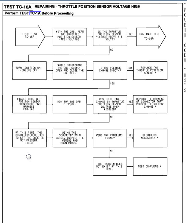

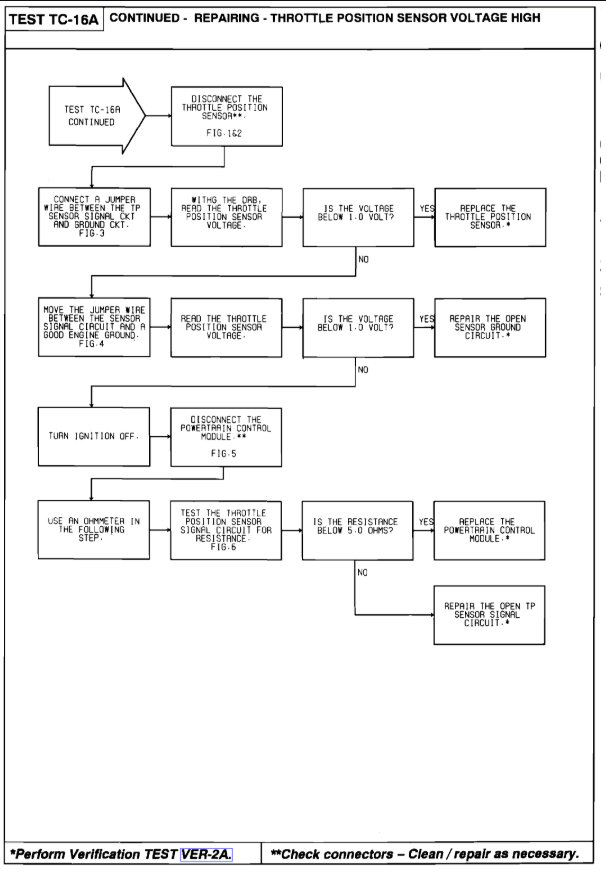

This code is telling you that your voltage is not as expected. This could be as a result of the sensor but it is more likely a wiring issue.

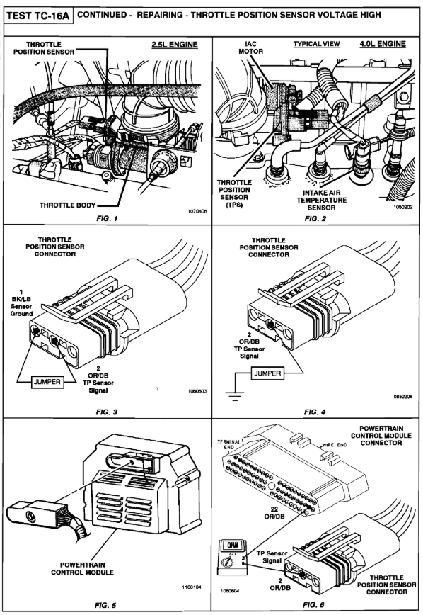

I attached the testing for this code but I suspect there is either a connection issue or a larger wiring issue.
Let me know if you have questions but following this test through should lead you to the issue.

Seems to be a wiring issue between the TPS and the PCM. Thanks for the help though!
Jan 21, 2020 at 9:51 AM
You are welcome. Also, the only way a wiring issue can "hurt" the TPS is if it is shorting out the sensor. However, the testing would reveal this.
