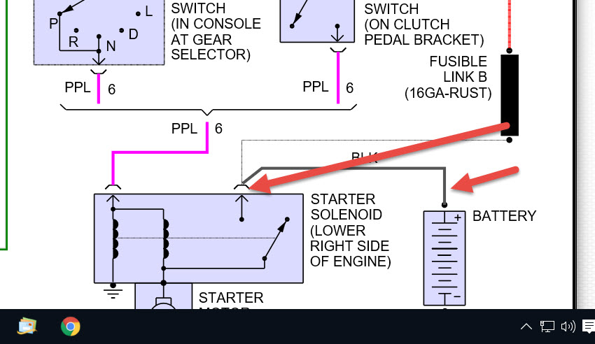

Car keeps on bucking as I press peddle then sporadically dies when at a stop. I have changed the fuel filter and o2 sensor. I have put a new starter on but not sure if I got the wires on correctly. Is there is schematic for the wiring to the starter? What else could be the problem.

What about the wiring for starter? What order do they go on?

this is all we have purple wire to "S" terminal on solenoid and fusible link and positive battery to large pole on solenoid.
