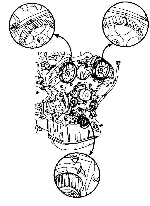

  • 55,056 POSTS
Yep, it sounds like you have no compression. So the timing marks are off or the valves got bent, I would recheck the marks of the timing belt. Thanks for the video it helps. Here are the marks for the timing belt. Check out the images (below). Please let us know what happens.
