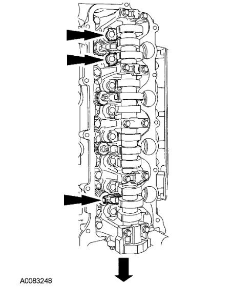

The 3 valve motor was a nightmare. The plugs never wanted to come out and everyone I did, I broke all the plugs as well. I went through what they did but never had an issue with the tool.
At this point, the head would have to come off to get the tool out and check for the damage. Instead of removing the motor, I used to jack up the cab about 5 inches and put 4X4 blocks of wood at the mounts to give me enough clearance to remove the head. Saves removing the engine.
