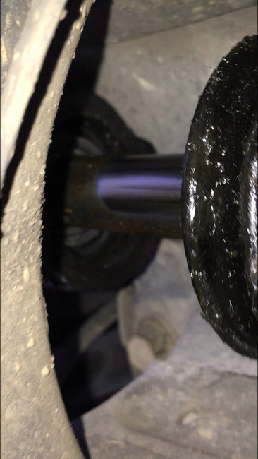

The car recently appeared with a broken boot on the front left side of the car. The axle is fine. However, there is a bothering noise coming from the car.

If you think it is the mechanics of the axle making the noise, it may be time for a new or re-manufactured one.
If it is the rubber remnants making the racket, cut them off and see if it disappears.
Trash/dirt is what escalates CV Joint failure. The boot is what keeps it clean and the lube contained (probably knew that already).

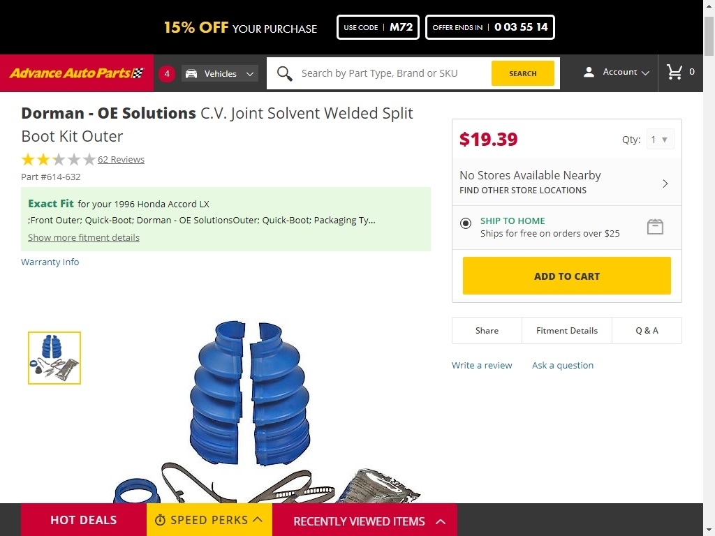

Below is a picture of a really easy DIY and good fix, If you adhere to the directions. Do not let that cost scare you!
Could be that the new lube might quiet the racket.
