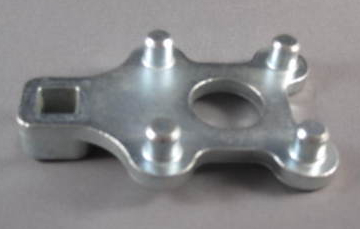

I had an oil leak from the oil pressure switch. Tried replacing guess i tightened it to tight and broke where it goes in at. Trying to figure out what that part of the engine is and how expensive it would be to fix. If possible. Its on the 2.4L Twin Cam in my car. It is located just under the front cam cover. Sorry I cannot be more specific not very smart when it comes to cars. Obviously.

Quick question will I need any special tools? Because I don't have any specific tools just basics. Like I had to get a special socket in order to get the oil pressure switch off.

There are a few special tools involved. Most should be available as rental/borrowed items from a parts store.
