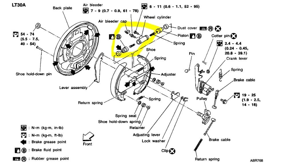

Good afternoon,
The rear brake bleeder has to be replaced. You cannot bleed the system if that is not working.

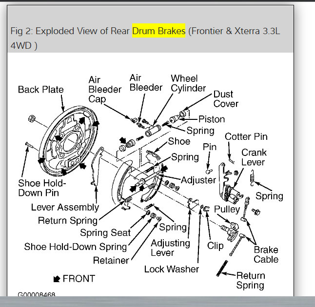

Do you have drum or disc brakes in the rear?
May 18, 2019 at 9:18 AM
SCGRANTURISMO
  • 4,897 POSTS

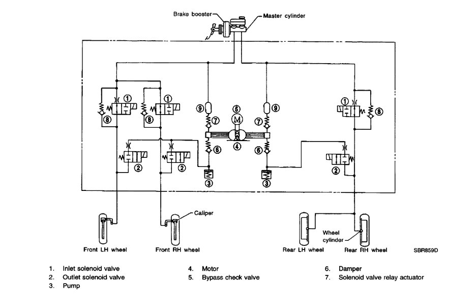

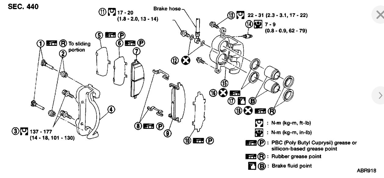

It sounds like you need to replace the bleeder that broke. Brake system use brake fluid like hydraulic fluid the squeeze the brake calipers to stop your vehicle. They are a sealed system, and can not have any leaks or the pressure will just bleed out with the brake fluid. When this happens your brake pedal will just to the floor and brake fluid will be pushed out where the leak is. In the diagrams down below I have included a diagram of your brake bleeder and a whole brake system diagram for you. Please use this information and fix your broken brake bleeder and get back to us with how it turns out, please.
