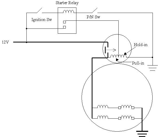

I put a brand new starter into my neon. It operated fine for a day, and then it would not start again. After tearing it down to verify the connection to the starter and putting it back together, it did not start again.
After doing that, I had a helper tap the starter while I cranked it. It started. I got the vehicle home and I have tried to start it several time since (At irregular intervals) and it has started just fine.
Is my brand new starter messed up, or could it have just been a connection issue that I did not anticipate but managed to accidentally/on purpose repair?

The third cause is much less common, and very elusive. First the circuit operation must be explained. The first diagram is from the Notes Pages I handed out in class. It shows a typical starter circuit.

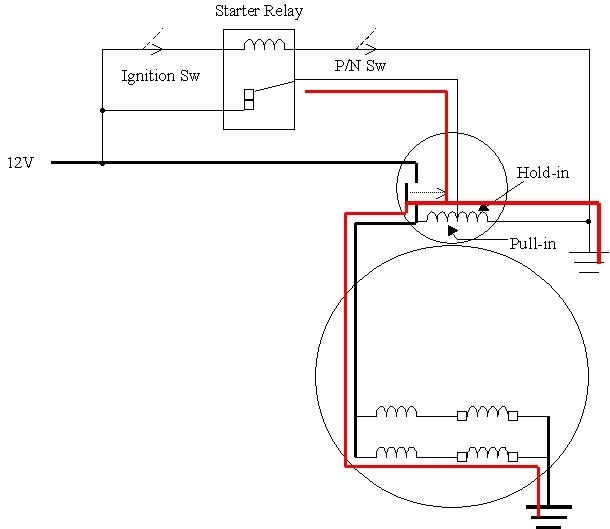

The second diagram shows it is energized. The starter relay is turned on, and current that flows through it flows through two paths, shown with the red lines. One path goes to the right, through the "hold-in" coil, then to ground. The second path goes to the left, through the "pull-in" coil, then it goes to ground through the armature and field windings of the starter motor. Those are so extremely low in resistance that for all practical purposes, it's a large piece of wire connected directly to ground. This creates two electromagnets that together are strong enough to move the plunger and push the drive gear into mesh with the ring gear.

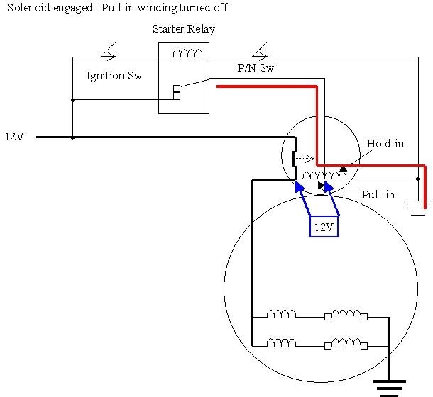

Once the plunger reaches the end of its travel, the contact disc on it connects the 12 volts from the battery directly to the starter motor. In so doing, 12 volts appears on both sides of the pull-in coil, one side from the battery, and the other side from the starter relay. With the same voltage on both side, the difference is 0 volts, so current stops flowing through it.
The important point is the hold-in coil's electromagnetic field is strong enough to hold the plunger and drive gear engaged while the starter cranks the engine, but it is not strong enough to tug it there by itself. Both coils are needed to get it to engage, but one can hold it there by itself. By switching the pull-in coil off, that current can be used by the starter motor. That might be just the little extra current it needs to get the job done on a cold day.
The problem that can develop is a break in the pull-in winding. You find 12 volts getting to the smaller solenoid terminal on the starter, but the solenoid doesn't engage. You don't hear the normal loud clunk it should make.
This is the exact type pf problem I referred to that can be overlooked when the starter is being rebuilt. The worst way to test a starter is off the engine when it isn't forced to work very hard. Under those conditions, it's real easy for the plunger to engage when only one of the coils is working. Once you put it on your engine, the hold-in coil isn't strong enough by itself, until you tap on the housing and jar it a little.
