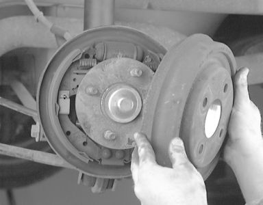

My brakes seem to be working right other than clicking noise coming from the rear. I changed the tires the other day and looked at the pads there seems to quite a bit there not sure what the problem could be (rear drum) thank you in advance for any help.

Hello mikejp Pull the brake drum straight off the wheel lug studs after the wheel and tire assembly have been removed. check for loose parts .
