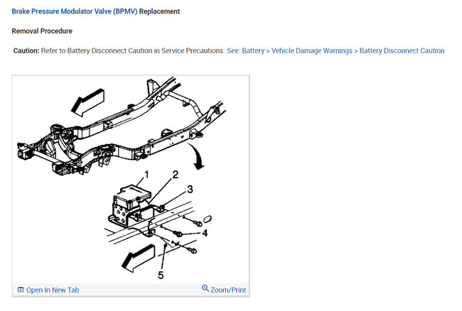

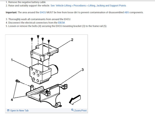

That is the ABS activating when it should not. When the ABS activates it pulses fluid to the wheels for stopping. The unit itself could be the issue
You need to match the number of the unit for replacement and it needs to be flashed when you install it for it to work. Without flashing, you cannot bleed it and the system will not work.

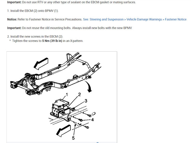

Roy, still tinkering with these brakes... I came across this video and the way he describes it is exactly what happens. https://www.youtube.com/watch?v=0_bglkgERWM
Are there only these sensors on the front or on all four axles?
I guess it couldn't hurt to check the rust and clean them up and give it a try.
The control module is more than I want to spend since I am trying to sell the darn thing.
Not sure if the sensors can be salvaged or I just need to remove the old, clean the rust and install new ones.
However, I understand the spongy pedal may still be the air and ABS control module issue.

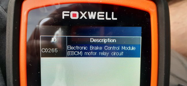

I put my scan tool on it and had it read. I got this back:
C0265 - seems you nailed it of course.
I am wondering if I can even attempt this or it needs to go to the shop. I know my GM dealer is going to be expensive.

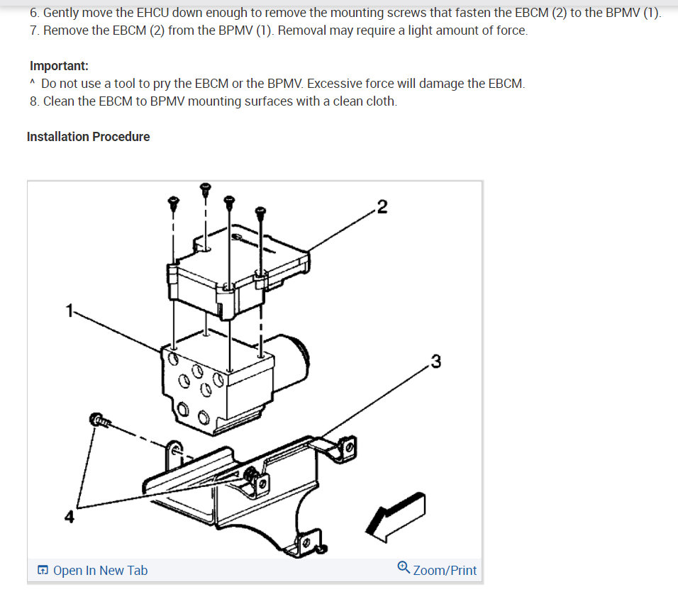

  • 52,797 POSTS
I would just replace the module. I would not do anything internal to it unless you have the equipment and experience in that kind of repair.
