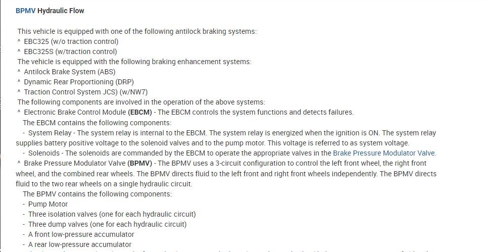

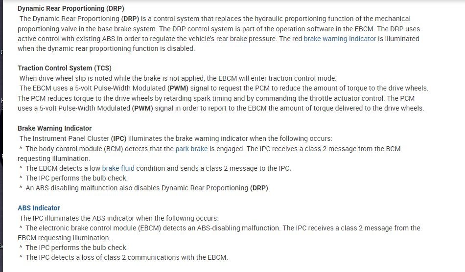

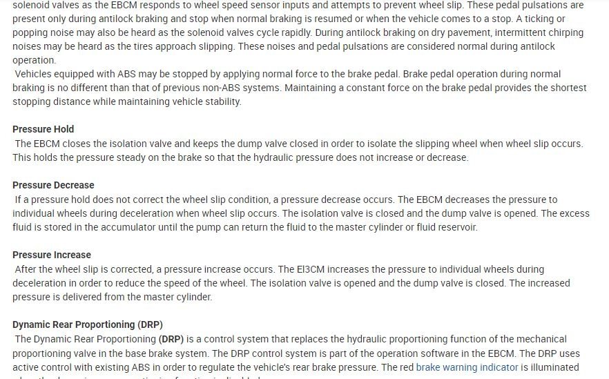

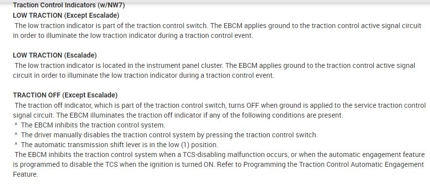

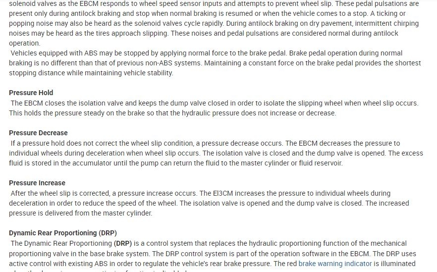

Good afternoon,
The ABS is a system that prevents wheel lock-up when braking heavily. When there is a fault in the system, the ABS is offline. When it fails you will always have normal braking power. You will not lose the brakes if there is a fault.
https://www.2carpros.com/articles/abs-warning-light-on-easy-repair-guide
I attached a description of the system and how it works below for you to view.

Thanks for the information - not quite sure what to do with it. The ABS light is not on.
Jun 4, 2021 at 8:13 AM
The ABS will not kick in unless you are in a panic stop and one of the wheels is locking up. Then it will activate and prevent the wheel from locking up.
It does not work under the normal operation of the brakes.

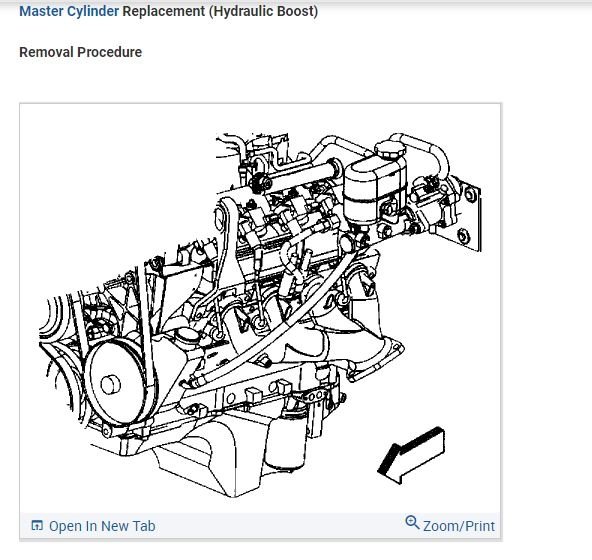

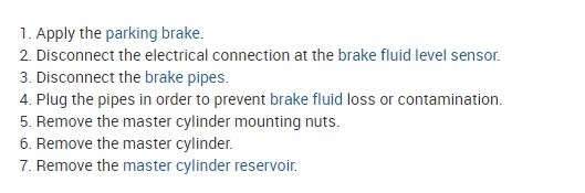

This sounds like the pedal may have gone down and you had to push harder to get it to start.
https://www.2carpros.com/articles/brake-pedal-goes-to-the-floor
https://www.2carpros.com/articles/how-to-bleed-or-flush-a-car-brake-system
The seals inside may be failing especially when you push it very softly.
If you replace the master cylinder, make sure you bleed and flush the brake fluid. Old brake fluid will cause this as well.

I changed out the master cylinder today... bled it, then bled all brake lines in pattern from back right/left, front right/left. took it out to drive it and the pedal still feels the same and if I have to stop suddenly the pedal drops to the floor and it almost feels like it surges. No brake lines are open or leaking.

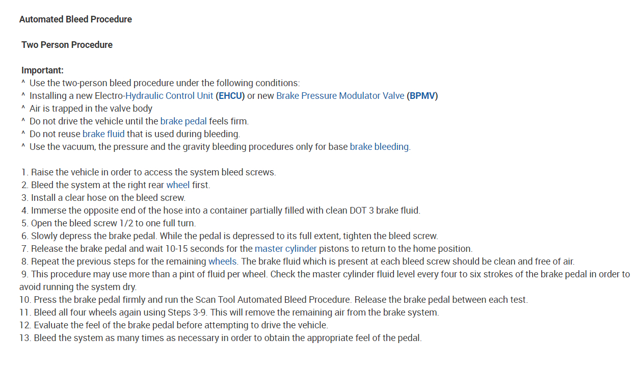

How did you bleed the ABS? That requires a scan tool to bleed it. If you did not, you will have air in the system and that will cause the pedal issue.
I attached the procedure below for you.

Well I bought scan tool - Foxwell NT630 and proceeded to bleed the brakes again.
The scan tool really didn't have a workflow that stepped through each brake line. Rather it would basically say to get it ready, I would open the bleeder which is connected to a hose into a bottle with brake fluid, I would get back into the vehicle and it would say to press and hold the brake - the ABS then would cycle several times and the workflow in the scan tool would end. Without lifting up on the brake pedal I would keep it held down with a DIY bar. I would go close the bleeder and then proceed to the next line set.
after all said and done, I cannot feel a difference - still plenty of pedal movement and spongy.
Not sure where to go next on this....
Jun 13, 2021 at 11:28 AM
Okay, when you did the automated procedure, all the bleeders should have been closed. By the description you posted, you left the bleeder open in the rear.
I would rebleed the system again with the scan tool and keep all the bleeders closed.

I just presumed that was the entire point of the exercise was that the ABS pump would auto bleed and to do so I needed to have the bleeder open at the time the scan tool told me to push and hold the brake pedal, then repeat for each wheel.
Jun 13, 2021 at 10:35 PM
Okay, you to just do the automated sequence with all bleeders closed. Do it several times since you did it with open bleeders.
Then do your manual bleeding.
Jun 13, 2021 at 10:46 PM

You can do it the other way but that is what the manufacturer recommends.
Jun 13, 2021 at 11:08 PM
UPMM019
  • 217 POSTS
One last question... is it fair to say that some vehicles, not this suburban year, would have a scan tool work flow that is guided through each wheel? I ask because I have watched a few YouTube videos and see where the scan tool work flow directs the user to each wheel but in my case I only have one option in the scan tool and the workflow is just to hold the brake pedal until it cycles and the workflow ends. Or is this more so related to the type of scan tool, meaning mine is a cheap version compared to professional grade scan tool?
Jun 13, 2021 at 11:13 PM
I know the YouTube video you saw. That is inaccurate. The tool opens the valves and vents the air from the module. The basic bleeding does not go through those areas.
There is never a need to open bleeders for the automated sequence.

When driving it again today the pedal surges at the end of the stroke as the vehicle is coming to a stop. when it surges like this it allows the vehicle to move more forward than originally intended if that makes any sense.

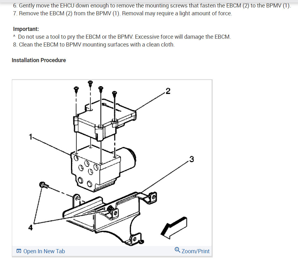

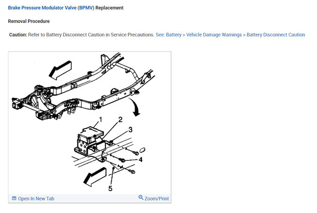

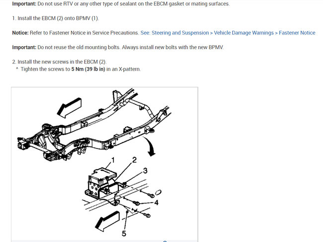

Jun 21, 2021 at 10:27 AM

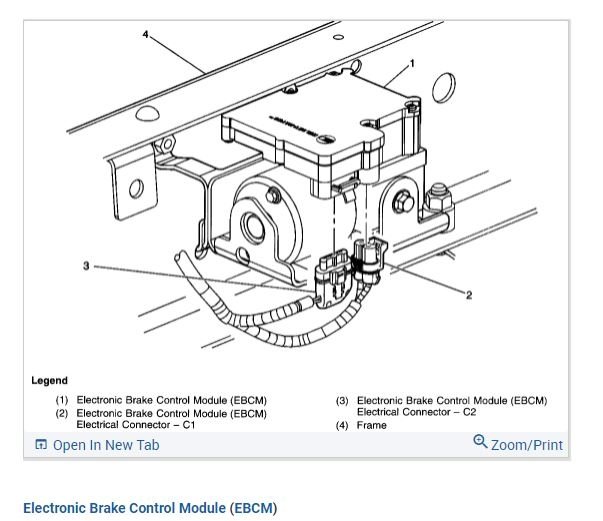

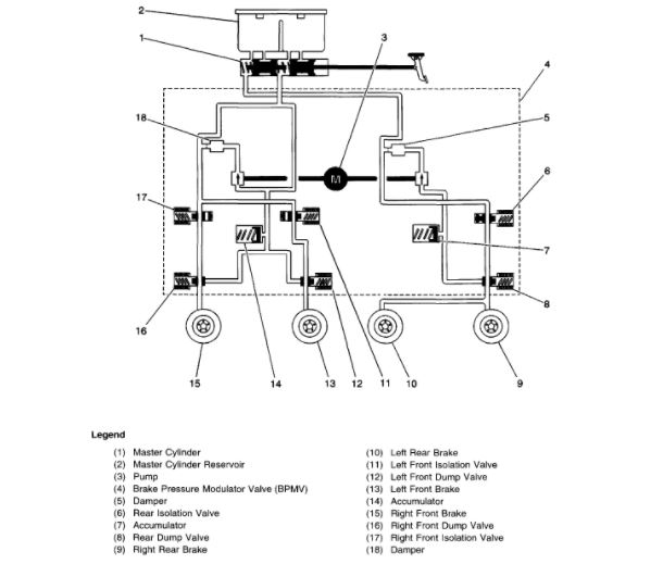

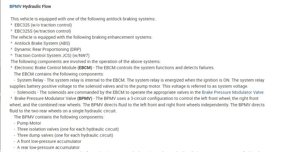

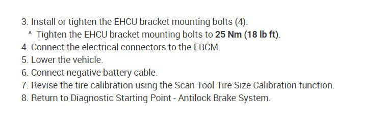

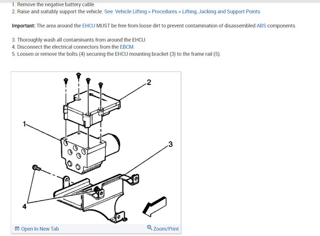

That is the ABS activating when it should not. When the ABS activates it pulses fluid to the wheels for stopping. The unit itself could be the issue
You need to match the number of the unit for replacement and it needs to be flashed when you install it for it to work. Without flashing, you cannot bleed it and the system will not work.
https://www.2carpros.com/articles/how-to-replace-a-abs-controller

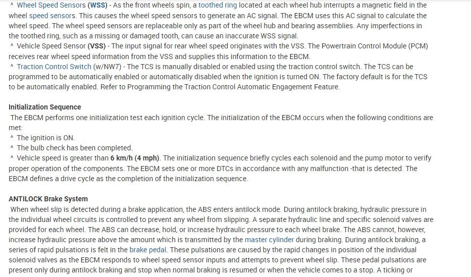

Could it be an issue with an ABS Wheel Sensor?
Jun 21, 2021 at 12:49 PM
No, a sensor would not cause a low pulsating pedal.

Absent the pulsing at the end of the stroke when pedal is pushed. would it also cause the pedal to be soft/spongy/lots of travel before feeling the brakes kick in?
Jun 21, 2021 at 1:04 PM
Yes, the ABS control unit can cause that issue. There is air that is not being bled from the unit itself.

Roy, still tinkering with these brakes... I came across this video and the way he describes it is exactly what happens. https://www.youtube.com/watch?v=0_bglkgERWM
Are there only these sensors on the front or on all four axles?
I guess it couldn't hurt to check the rust and clean them up and give it a try.
The control module is more than I want to spend since I am trying to sell the darn thing.
Not sure if the sensors can be salvaged or I just need to remove the old, clean the rust and install new ones.
However, I understand the spongy pedal may still be the air and ABS control module issue.

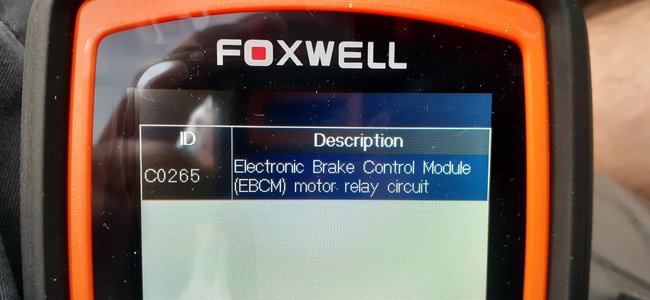

I put my scan tool on it and had it read.... I got this back:
C0265 - seems you nailed it of course...
I am wondering if I can even attempt this or it needs to go to the shop.. I know my GM dealer is going to be expensive.
Jun 24, 2021 at 11:31 AM
UPMM019
  • 217 POSTS
One thing to note... not that it make any difference but my abs and brake light on the dash are not on and never stay on... (so is the a soldering issue or maybe something else) ?
Jun 24, 2021 at 11:42 AM
I would just replace the module. I would not do anything internal to it unless you have the equipment and experience in that kind of repair.
