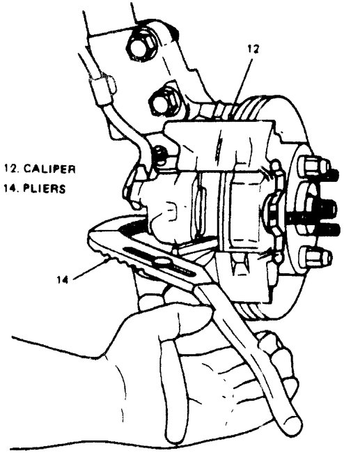

3. Position suitable pliers over inboard pad and housing as shown in Fig. 8, and squeeze pliers to compress caliper piston.

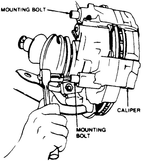

5. Remove Allen head caliper mounting bolts, Fig. 9. If bolts show signs of corrosion, use new bolts when installing caliper assembly.
6. Remove caliper assembly from disc. If only shoe and lining assemblies are to be replaced, using a length of wire suspend caliper from spring coil. Never allow caliper to hang from brake hose.
Fig. 9 Caliper Mounting Bolts Replacement.

Fig. 13 Caliper & Stops Clearance Inspection.
Pic 3
CALIPER INSTALLATION
1. Position caliper assembly over disc and align mounting bolt holes. If brake hoses were not disconnected during removal, use care not to kink hoses during installation.
2. Install mounting bolts and tighten to specifications, Fig. 9.
3. Check dimensions between each caliper stop and caliper, Fig. 13. If necessary remove caliper and file ends of bracket to provide proper clearance.

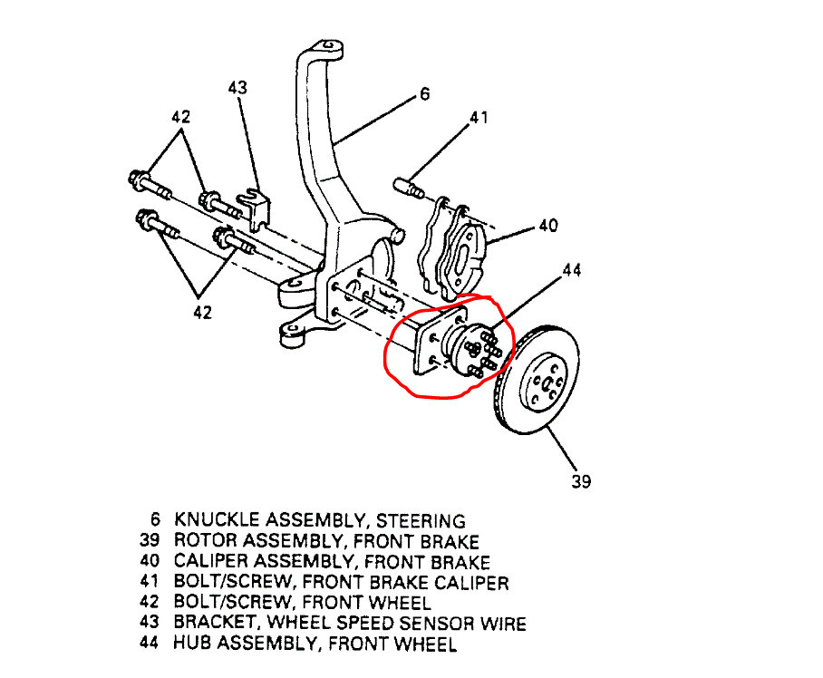

When you have the tire off the ground, place your hands first at 3 and 6 oclock and wiggle to see if there is play. Do the same at 6 and 12. If you do notice play, then have a helper watch to see if the play is in the bearing.
As far as repacking them, I will need you to check something. When I look in my manual, it explains the old style bearing where the rotor itself functions as a hub assembly. When I look at the directions, it indicated a bolt on hub. I attached a pic of this type. Let me know if this is what you have. It will have 4 bolts going from the rear of the steering knuckle and bolting the hub assembly on, or it will have the type where there is a tin type cover center on the hub which is removed to access the spindle nut.
Let me know which one you have so I can make sure to provide the correct directions. Also, I really feel the rotors should be replaced regardless. I suspect that is where you are getting the vibration. I feel you would have the vibration with the brakes applied or not if it was a bearing.
Let me know and please feel free to let me know if you have other questions.
