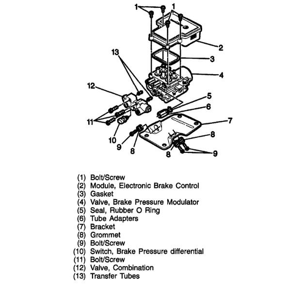

First this is what I have done so far: (1) replaced all steel lines complete front to rear. (2) replaced all rubber lines front to rear.(3) replaced booster.(4) replaced master cylinder. (5) replaced front rotors/pads/and calibers.(6) replaced complete rear brake assemblies drums/hardware/and shoes. (7)proportion valve. All parts are brand new GM parts. My problem is the right front caliber keeps sticking and I have replaced the right front front three times and still it sticks and burns up the pads and rotor. It is like driving down the road towing a heavy trailer. When I go to stop sometimes the pedal is firm other times it is spongy. I have checked for possible kinks in all lines and there are none. I have also rechecked all rubber lines and found no issues. When I bleed the brakes the fluid pours out with no problem. I am at my wits end on this and all most ready to send this to the crusher.

Try this:
After driving it, go to the wheel and open the bleeder. See if it releases the brakes. If it does, the ABS control unit is the issue not allowing back flow to the master.

No, that just disables the electronic portion of the system. Fluid still goes through the unit.

Good evening Roy. I tried your advice and yes the bleeder did spit up a short stream of fluid and released the caliber from the rotor. My question before I put more money into this, the ABS electronic control module is what you state is the issue, is there any chance the ABS pump assembly could play a role in my problem or do you think it is just the ABS control module (Kelsey Hayes)? Thanks for any help you can give.

It is the hydraulic unit that is the issue.
I attached a picture. It is the unit itself that has stuck valves.
