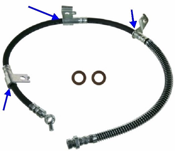

Good news folks!! The issue has been resolved with the replacement of the flexible front brake lines. I truly appreciate all of the support CARADIODOC and KASEKENNY1.

It could also be a failing flexible brake line. They can fail inside and act like a one way valve. You apply the brakes and the fluid either cannot return or returns very slowly.
These can be hard to find if it only happens once in a while because they will look fine on the outside. Sometimes you can find them if you jack up the vehicle and stomp the brake and have someone immediately try to spin the wheel by hand as soon as your foot is off the pedal. If the wheel is hard to turn and slowly gets easier I would suspect the line.

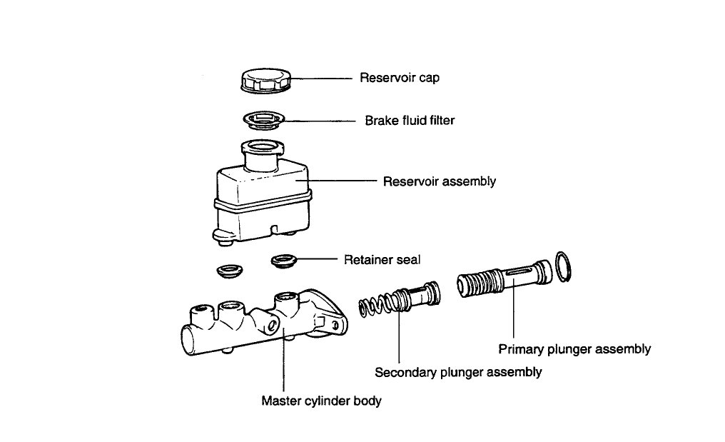

DAVIDZARATE
I have an 6/04 hyundai sonata and have replaced the rear pads rear rotors, rear calipers front and rear brk hoses, fluid, and while driving the front and rear brks start locking up
Mar 15, 2021 at 11:05 AM (Merged)
NICKB275
  • 24 POSTS
Please be more specific, does it feel like ABS braking or a complete brake lock-up, such as all four wheels locking up and staying applied and not releasing. Does the ABS light flash when this happens? Did you have any problems of note when changing the brakes? Did everything install back into place with no problems?
DAVIDZARATE
All four complete brake lock-up and does not release until resting for approx. 1 hour. and yes the abs light is on
NICKB275
  • 24 POSTS
Is it possible that any of the old brakes pads were ground down to metal before replacement? Some metal shavings may have magnetically stuck to abs wheel sensors. I would try to remove the shavings and clean the wheel speed sensors, check all wiring to and from these wheel speed sensors. If all checks out, a code check of the ABS module will need to be doe with a scanner. You may remove the abs pump motor fuses. Not recommended, but may isolate problem, if it still occurs with abs motor having no power, it is your basic hydraulic system. I personally feel you have a ABS issue.
LUCAS343
  • 6 POSTS

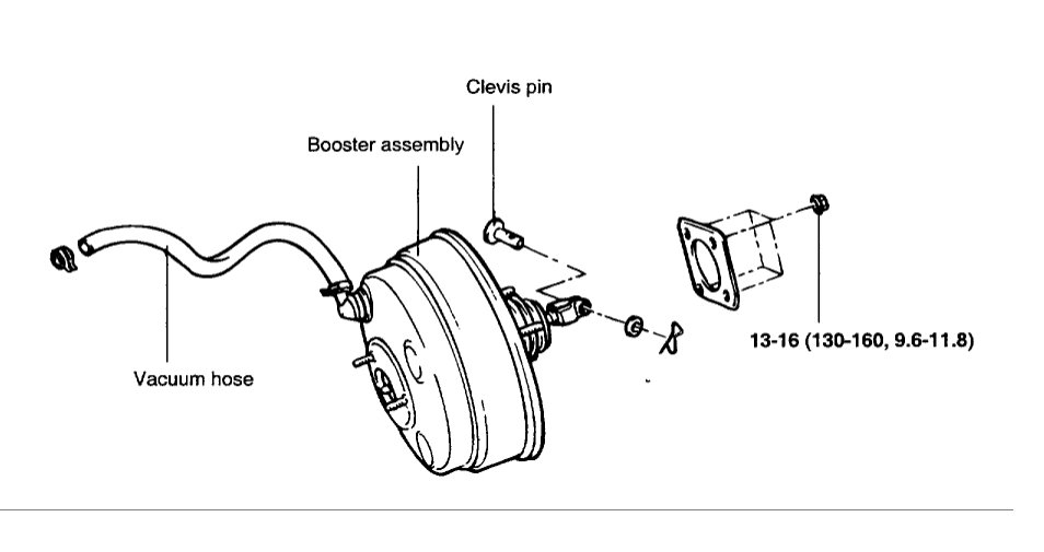

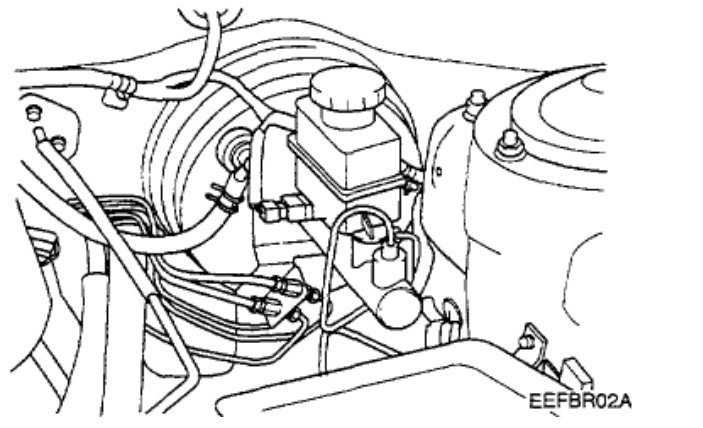

I’ve replaced everything in the braking system. when I take off the brake line and it returns to normal again. What should I try next?
  • 110,251 POSTS
Did you replace the rubber brake hoses at the brake calipers? Also, do all the brakes lock up or just one?
Let me know what has been replaced and exactly what is happening.
LUCAS343
  • 6 POSTS
And master cylinder was replaced front brakes lock up only.
Brakes lock up even if car is not moving when we unplug the brake line from engine brakes loosen again and when they lock up and your driving it overheated the car.
  • 110,251 POSTS
Okay, so it locks up when you apply vacuum to the brake booster, correct? If you disconnect the booster and it releases, it sounds like the booster itself is bad.
When the car first came to you, what was the problem?
LUCAS343
  • 6 POSTS
I replaced the filter.
When I got the car I drove it for a few months and then it started locking up when driving later we took it to a mechanic we let it warm up they locked up sitting not moving.
  • 110,251 POSTS
What filter was replaced? Also, is it a vacuum supply you are referring to?
LUCAS343
  • 6 POSTS
Not filter brake booster.
When you unplug the brake tube vacuum.
  • 110,251 POSTS
If they only lock when the brake booster is connected to vacuum, it sounds like the booster is bad. I realize you replaced it and it worked for some time, but it sounds bad.

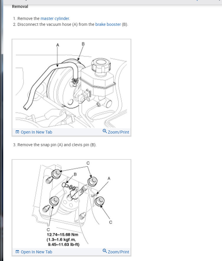

What happens is the internal valve inside the booster gets stuck so it wont release. The booster needs to the replaced or the booster rod is adjusted too far out. Try to undo the mounting bolts for the master to see if that releases it as well if so then turn the rod adjustment screw inward. If not here are some diagrams to help you replace the booster with a rebuilt or new unit.

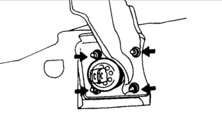

MATTHEW T WHITE
repaired a wheel cylinder on back, now the front brakes lock up about every five miles. this car does not have ABS and do not see a release valve. i can release the pressure at the bleeder or the master.
got a new master same thing still happening.
MATTHEW T WHITE
i also backed the screws out on the master cylinder to see if the rod was keeping it in. still locked up. maybe i did not unscrew it enough?

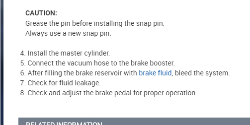

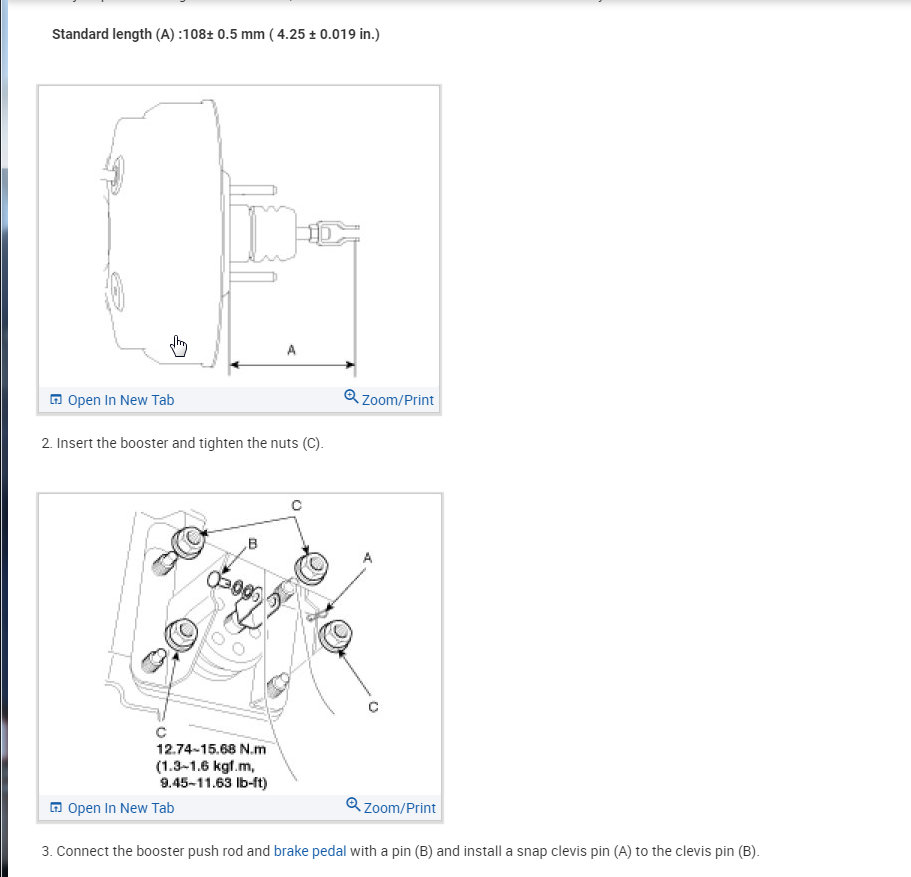

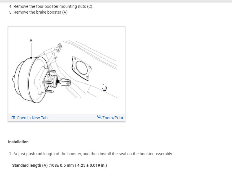

KHLOW2008
  • 41,812 POSTS
Check the brake pedal adjustment. If there is insufficient free play, the master cylinder would be partially depressed and this would result in the brakes seizing after the brake fluid heats up. Insufficient free play could be due to a mis-adjusted brake switch.
MATTHEW T WHITE
i figured it out it is the brake booster not sure if the pedal is adjustable or not. However, the screw is just have to take the master all the way off to adjust it.
Mar 15, 2021 at 11:06 AM (Merged)
KHLOW2008
  • 41,812 POSTS
Before adjusting the brake booster, check the brake pedal free play adjustment first. It is adjustable, either by the push rod or the brake switch if the pedal is low.
