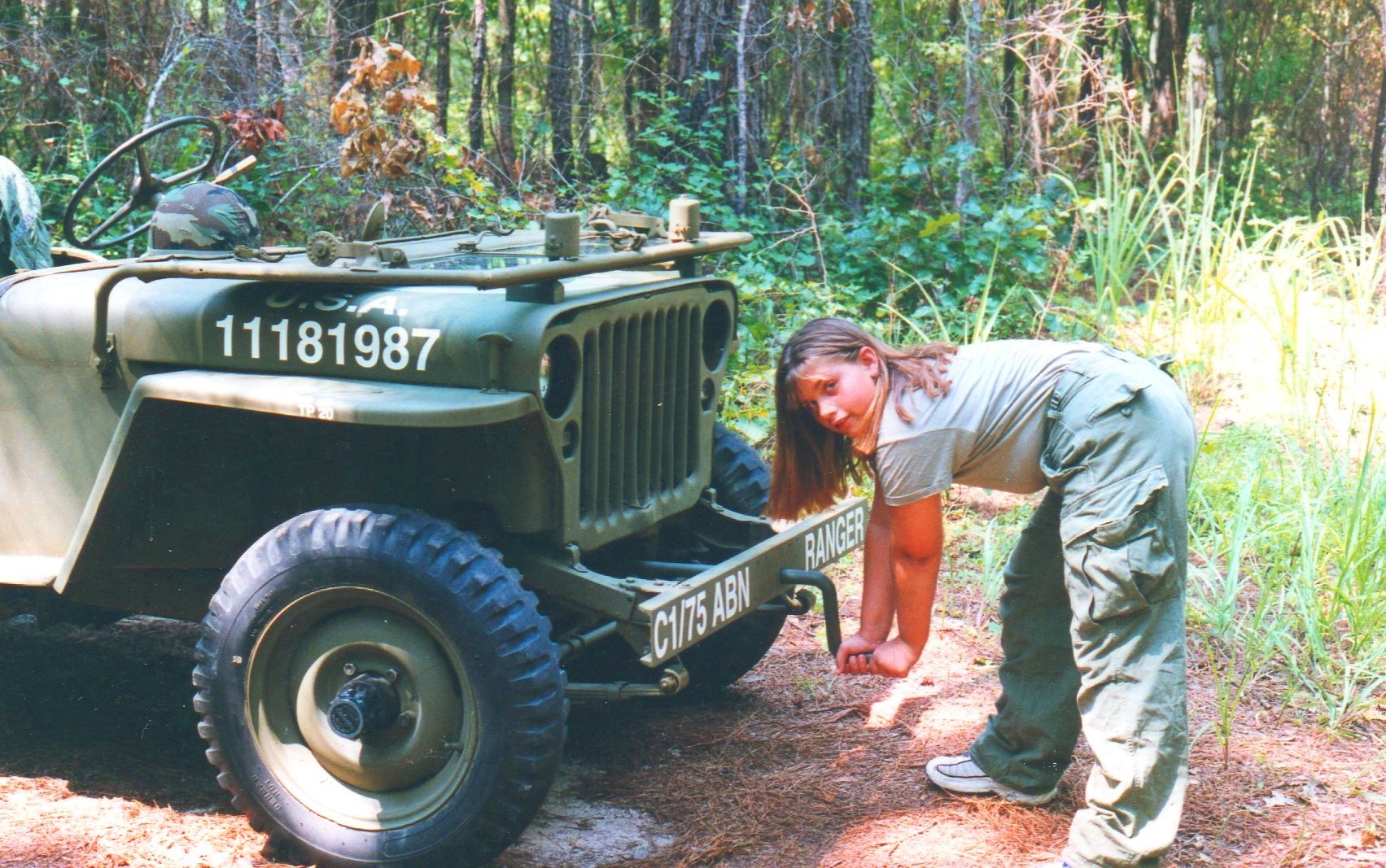

PICS OF HER AT 10 (SHE LIKED THE HAND CRANK OVER THE STARTER SO SHE COULD SHOW OUT)

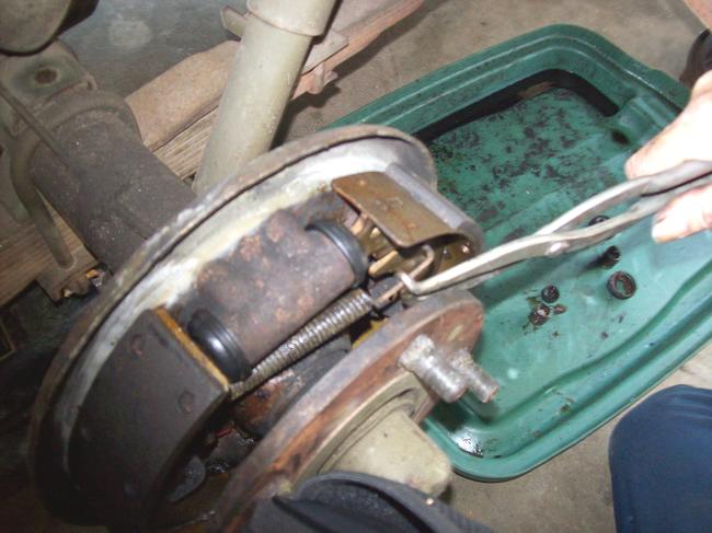

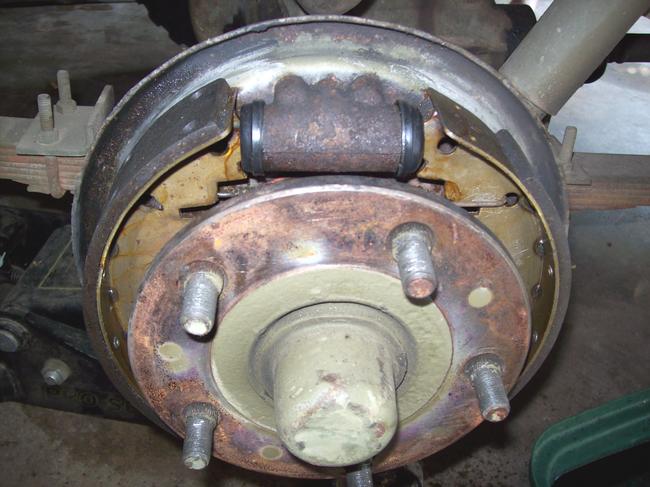

PRIMARY AND SECONDARY SHOE PLACEMENT IS CRITICAL- EVEN ON MINE, DRUMS ALL THE WAY AROUND, THE SHORTER SHOE LINING GOES "FORWARD" OR CLOSEST TO THE FRONT OF THE VEHICLE
THE LONGER SHOE LINING GOES TO THE REAR
THIS APPLIES TO BOTH SIDES AND BOTH AXLES
(NOT 2 SHORT ON ONE SIDE- AND NOT 2 LONG ON THE OTHER SIDE) THIS IS SORTA IMPORTANT!

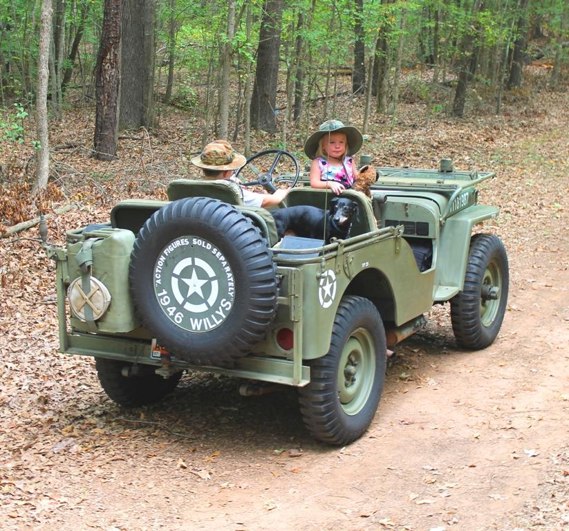

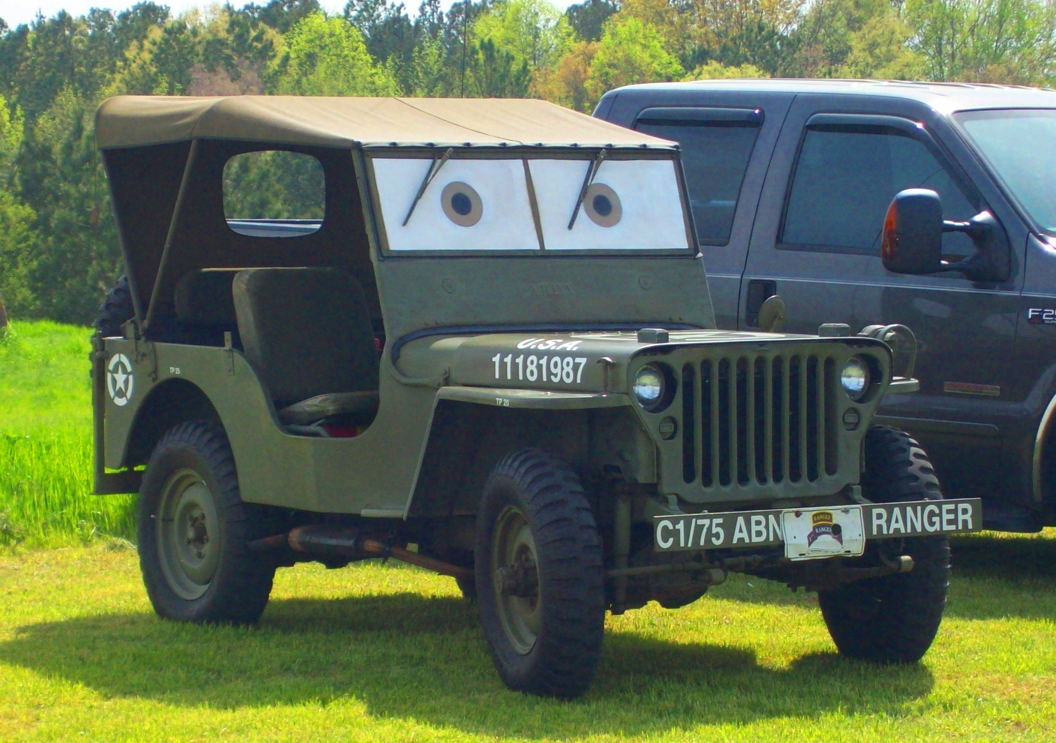

SEE MY SO VERY SIMPLE BRAKE SYSTEM ON MY '46 WILLYS SHOES IN THE 1st PIC - FRONT OF JEEP IS TO THE RIGHT- NOTICE SHOE LINING LENGTHS
AGAIN IN 2ND PIC- FRONT OF JEEP IS TO THE RIGHT
