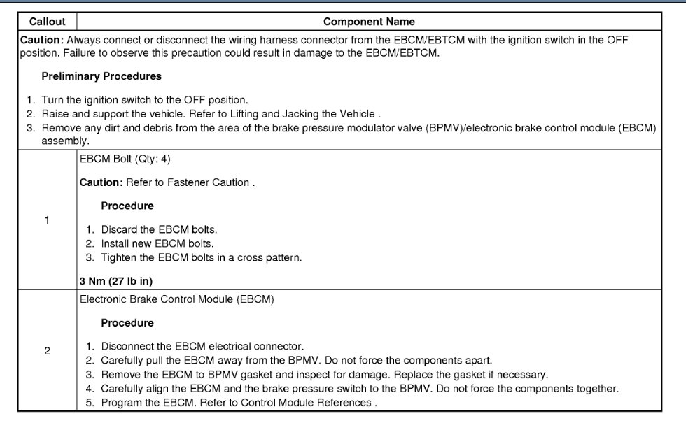

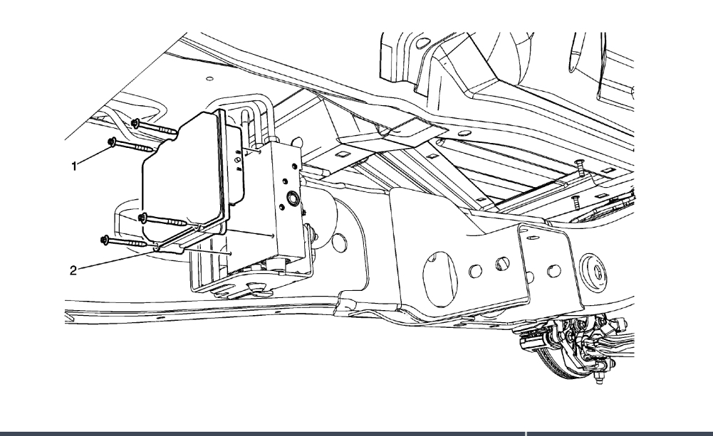

CHARLESPARKS832
  • 2011 CHEVROLET SILVERADO
  • 150,000 MILES

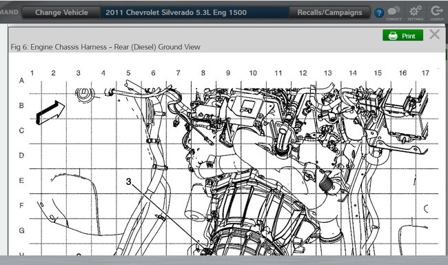

Drivers front brake locked up and was smoking. So I changed the caliper, everything was okay for the forty mile trip home. The next day I drove five to eight miles when both front brakes locked up smoking. They released after two hours. How should I trouble shoot this problem?

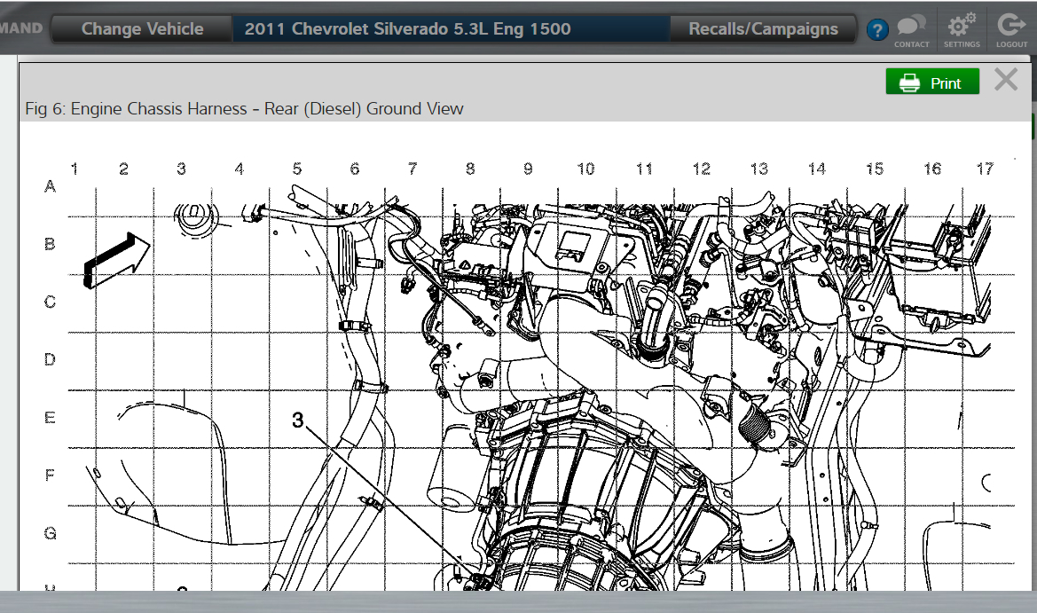

CHARLESPARKS832
Alex, the ABS light sometimes comes on, and DTC code appears. But it resets itself. I don't know if this is connected, but sometimes the doors; unlocks and locks! The alarm chime, also sounds when this happens. I've checked the fuses they are okay. Also service tire monitor system sometimes appears. I don't know if this is relative to my problem.
Monday, February 22nd, 2021 AT 11:36 AM (Merged)

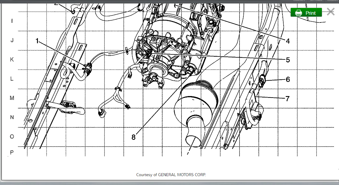

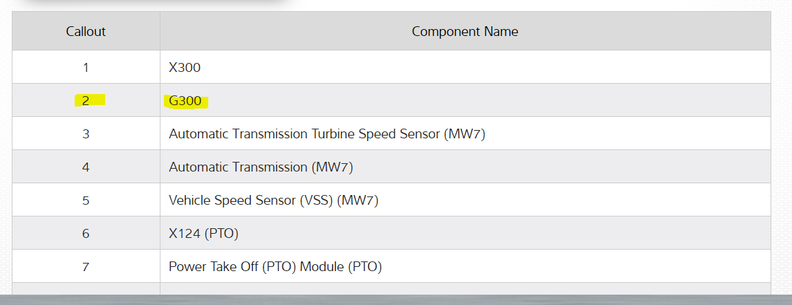

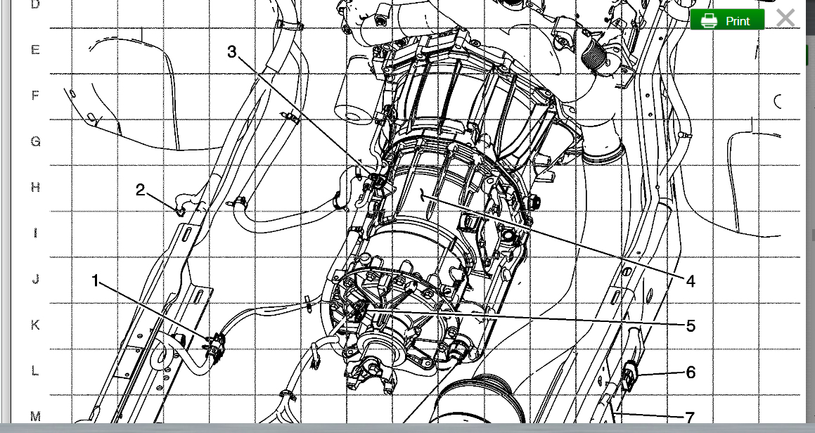

SCGRANTURISMO
  • 4,897 POSTS
Okay, this could be a problem with ground #300, which is located below the drivers door on the body mount. Check and make sure that the ground is clean, corrosion free, tight, and making good metal to metal contact. Please check this ground out and get back to us with what you are able to find out.

CHARLESPARKS832
Is that care of the brake issue? I took it for a short five miles, and it didn't lock up but both front started to heat up had to stop for a while.

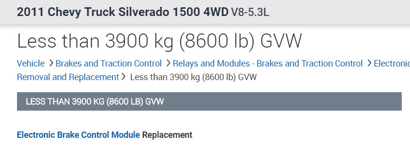

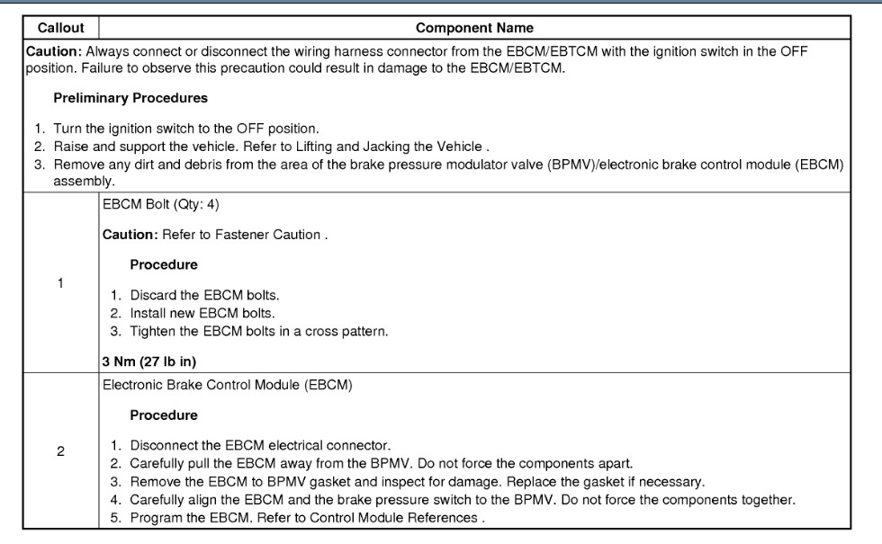

SCGRANTURISMO
  • 4,897 POSTS
Hello again,
This is the ground for your vehicle's Electronic Brake Control Module (EBCM). 75% of all electrical problems on a vehicle are ground problems. If the ground is okay, I would suspect the EBCM itself. In the diagrams below I have included the directions for removal and installation of the EBCM. Please go through the guide and get back to us with what you are able to find out.
