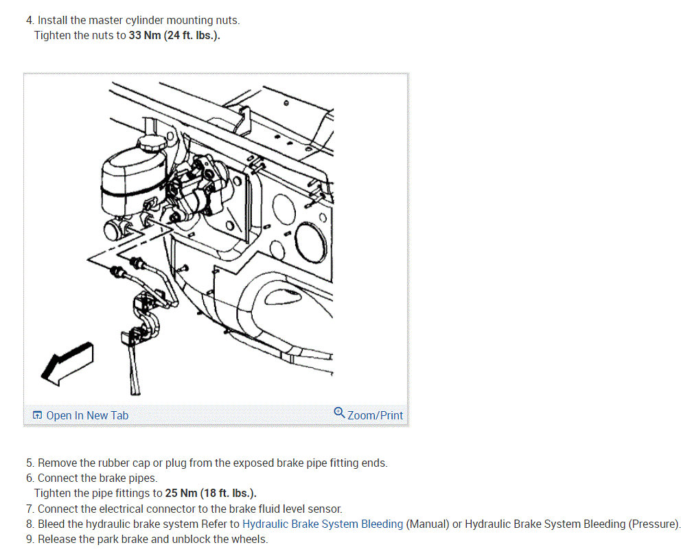

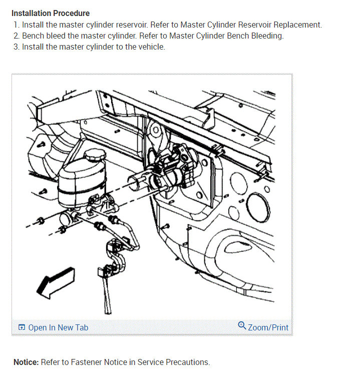

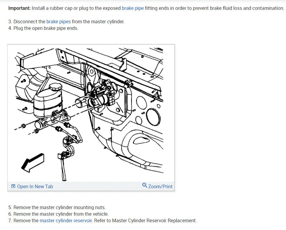

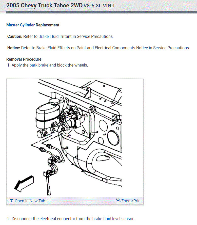

If you look at the attachments below, they are the directions and pics specific to your vehicle for master cylinder replacement. Take a look through them to make sure nothing was missed.
