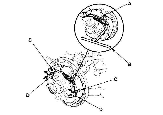

Brake shoe replacement. The attached pics correlate with the directions.

pic 1

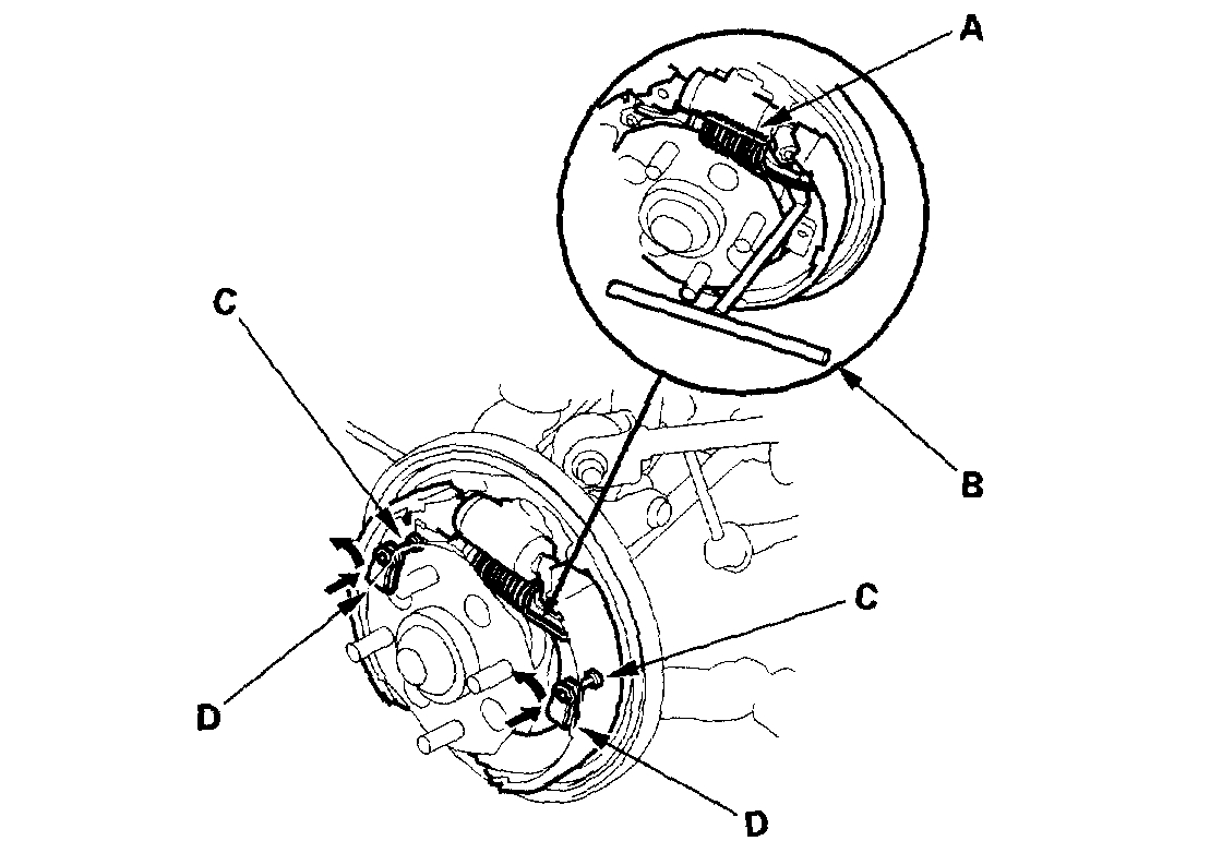

1. Disengage the upper return spring (A) with the tool (B)
2. Remove the tension pins (C) by pushing the retainer spring (D) and turning them.
pic 2
3. Lower the brake shoe assembly (A), and remove the lower return spring (B). Make sure not to damage the dust cover on the wheel cylinder.
4. Disconnect the parking brake cable from the parking brake lever.
5. Remove the brake shoe assembly.

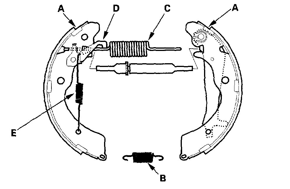

6. Remove the upper return spring (C), self-adjuster lever (D), and self-adjuster spring (E), and separate the brake shoes.

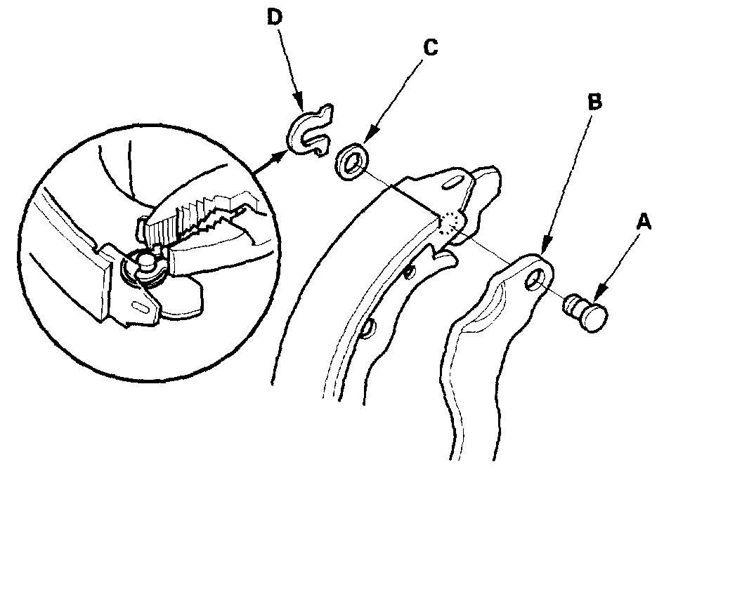

pic 3

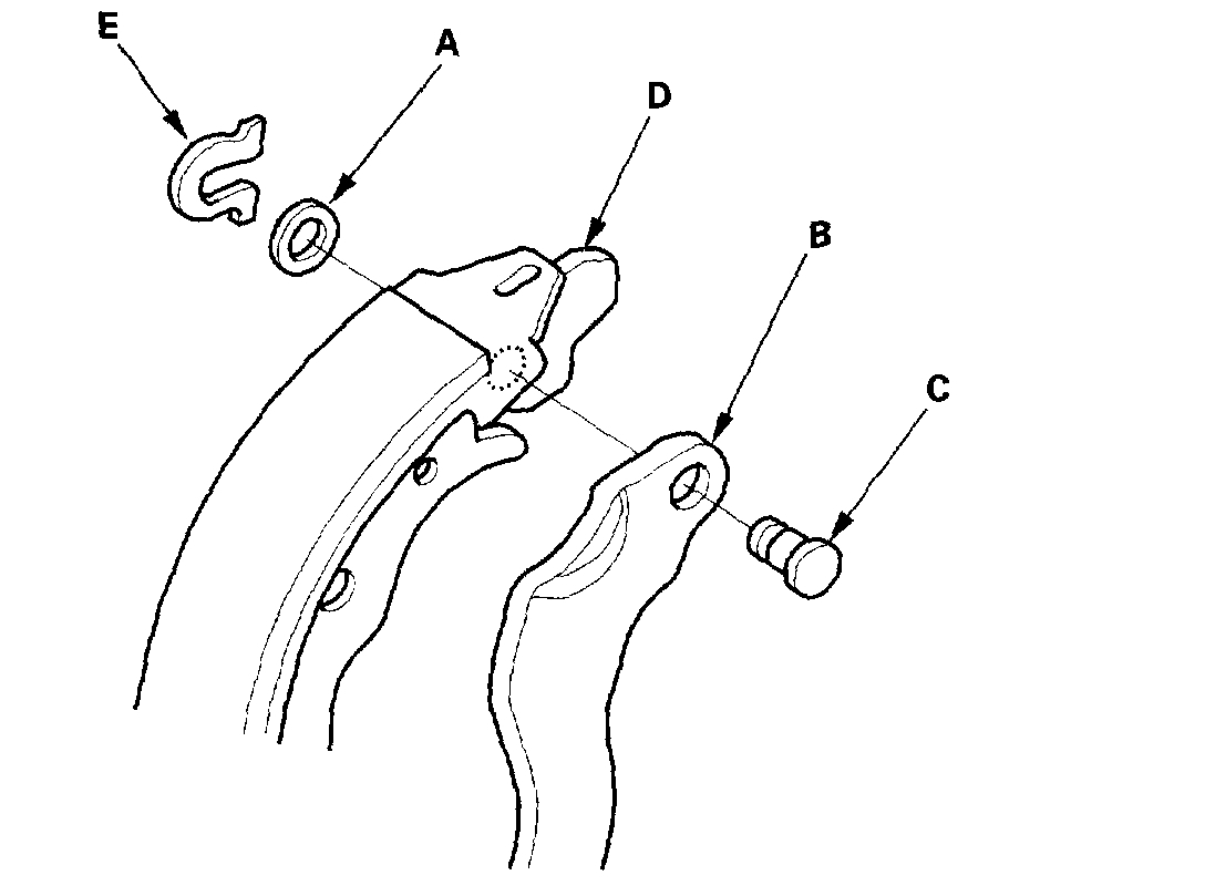

7. Remove the wave washer (A), parking brake lever (B), and pivot pin (C) from the brake shoe (D) by removing the U-clip (E).
pic 4
8. Apply brake cylinder grease (P/N: 08733-B0202) or equivalent rubber grease to the sliding surface of the pivot pin (A), and insert the pin into the brake shoe.
9. Install the parking brake lever (B) and wave washer (C) on the pivot pin, and secure with a new U-clip (D).
- Install the wave washer with its convex side facing out.
- Pinch the U-clip securely to prevent the pivot pin from coming out from the brake shoe.
10. Connect the parking brake cable to the parking brake lever.

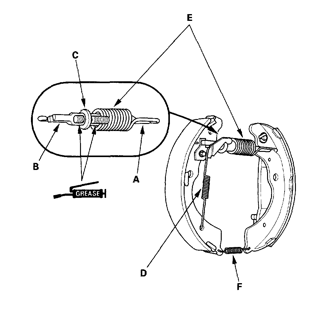

pic 5
11. Clean the threaded portions of clevises A and B. Coat the threads of the clevises with grease. To shorten the clevises, turn the adjuster bolt (C).
12. Hook the self-adjuster spring (D) to the adjuster lever first, then to the brake shoe.
13. Install the Devises and upper return spring (E), noting the installation direction. Be careful not to damage the wheel cylinder dust covers.
14. Install the lower return spring (F).

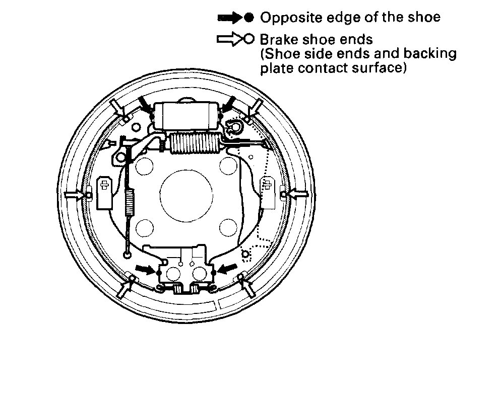

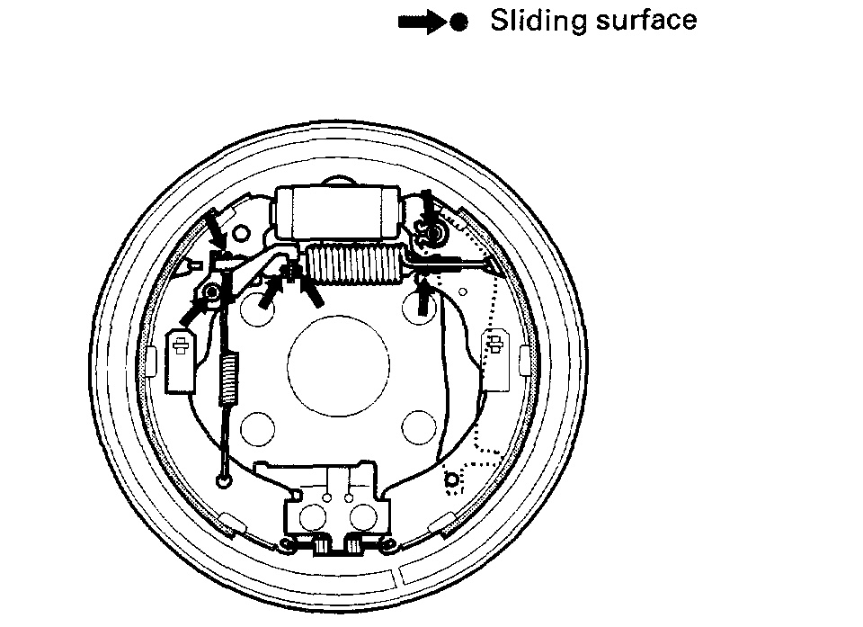

15. Apply brake cylinder grease (P/N: 08733-B020E) or equivalent rubber grease to the sliding surfaces shown. Wipe off any excess. Don't get grease on the brake linings.
pic 7
16. Apply Molykote 44MA to the brake shoe ends and opposite edges of the shoes shown. Wipe off any excess. Don't get grease on the brake linings.

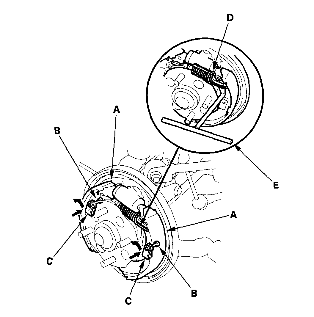

pic 8
17. Install the brake shoes (A) onto the backing plate. Be careful not to damage the wheel cylinder dust covers.
18. Install the tension pins (B) and the retainer springs (C).
19. Hook the upper return spring (D) with the tool (E).
20. Install the brake drum.

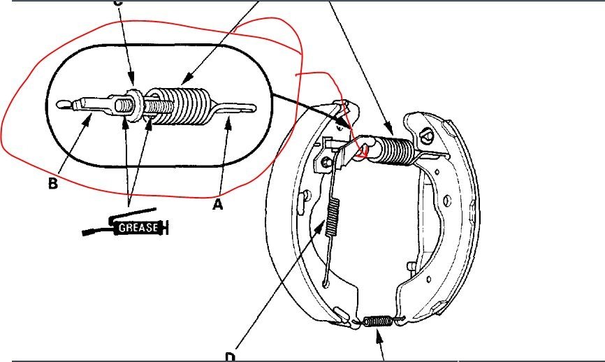

In Pic 9, I circled the adjuster.

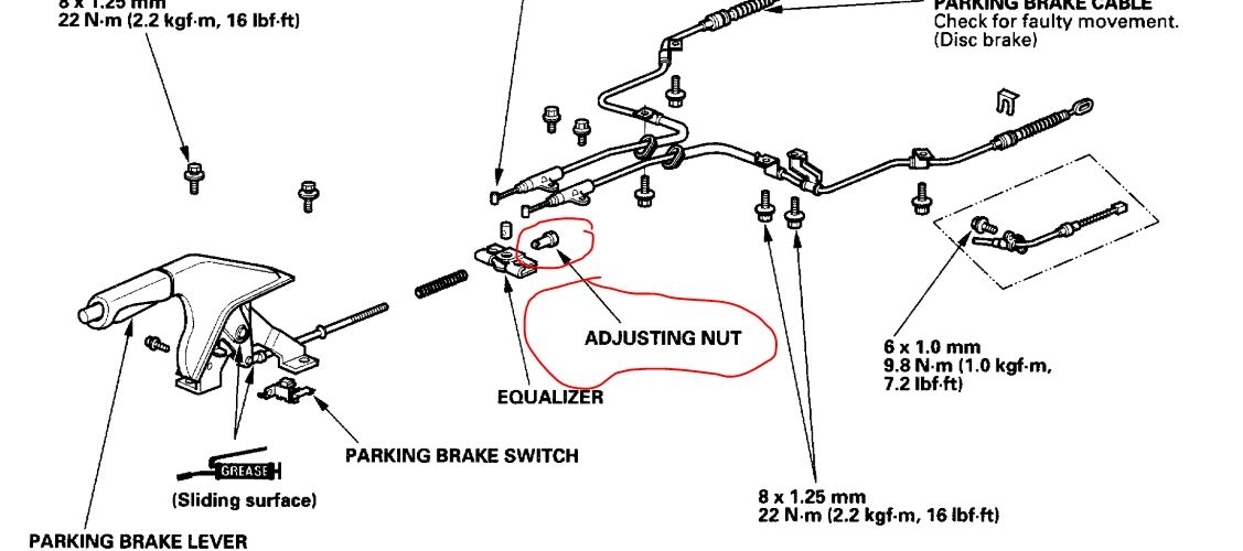

Parking brake adjustment.

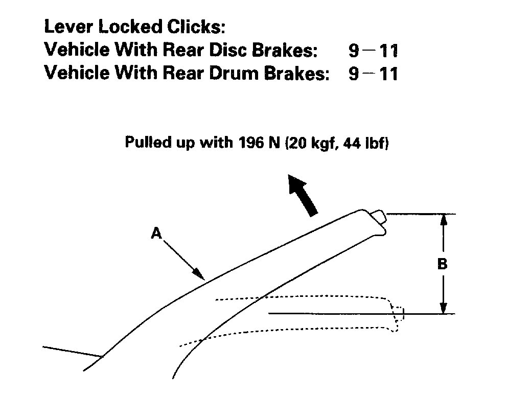

In pic 10, I circled the adjuster for the parking brake.
Here are the manufacturer's suggestions for adjustment. I will tell you that when I check one, it should hold the vehicle stationary when the vehicle is placed in gear and your foot is off the brake. It should do this within the number of clicks recommended.

Check
pic 11
1. Pull the parking brake lever (A) with 196 N (20 kgf, 44 lbs.) force to fully apply the parking brake. The parking brake lever should be locked within the specified number of clicks (B).
2. Adjust the parking brake if the lever clicks are out of specification.
