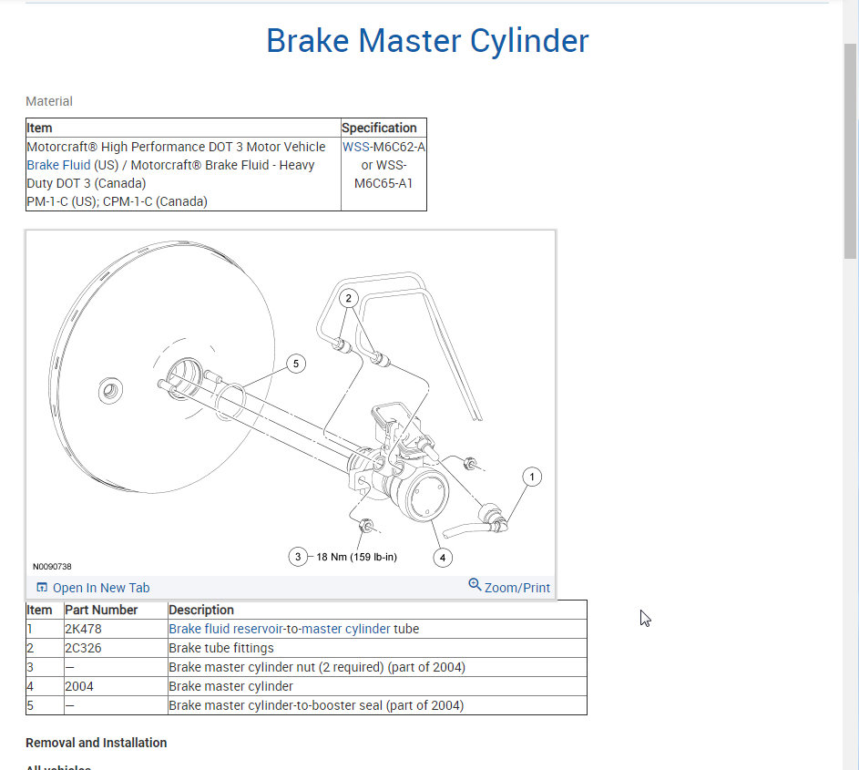

I have a problem with my vehicle and I really do not know what is the problem. I do not know if I need brake lines. I got my brakes and rotors check and I was told that they are in good condition. But as I drive I have to push down to get my vehicle to stop, when I do finally stop I feel as in my brake pedal goes down as it pumps down by itself while I am at a light or stop sign. I checked my brake fluid and it is good.

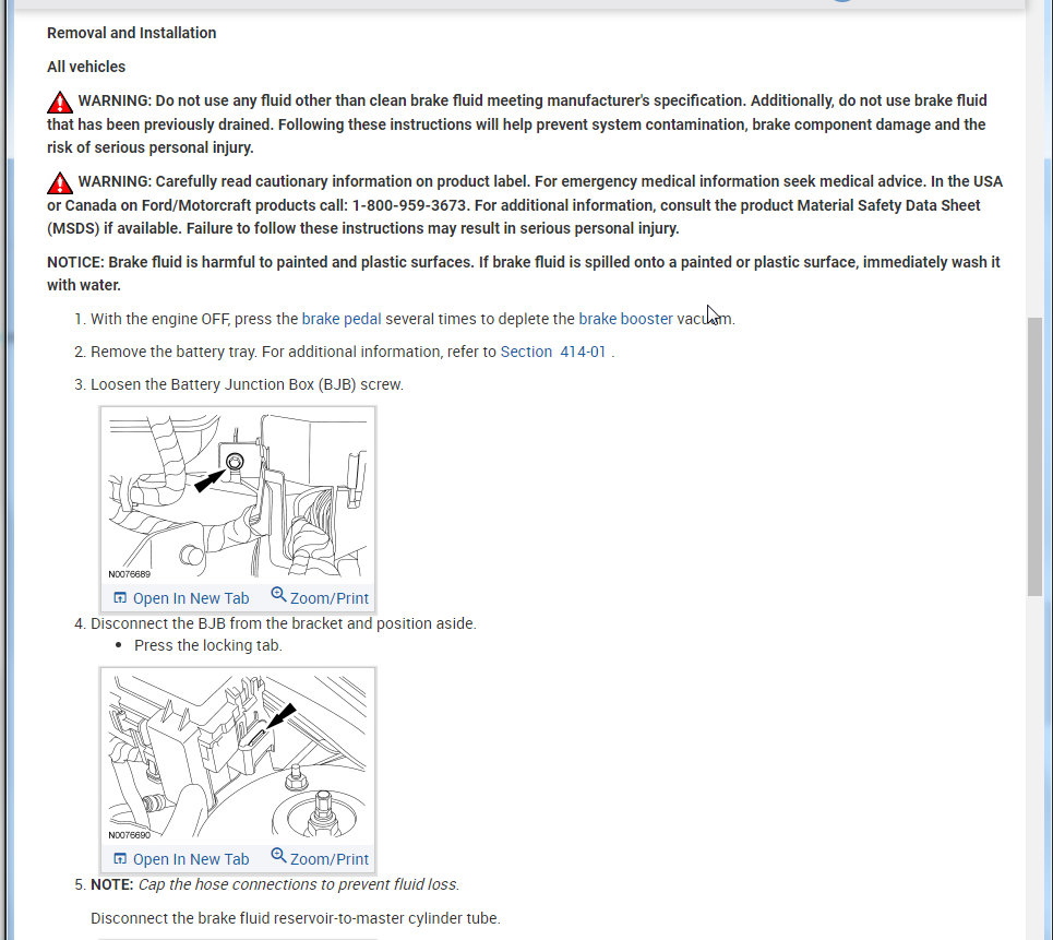

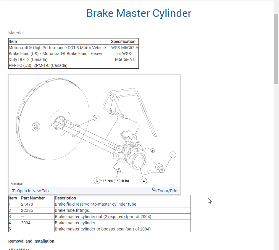

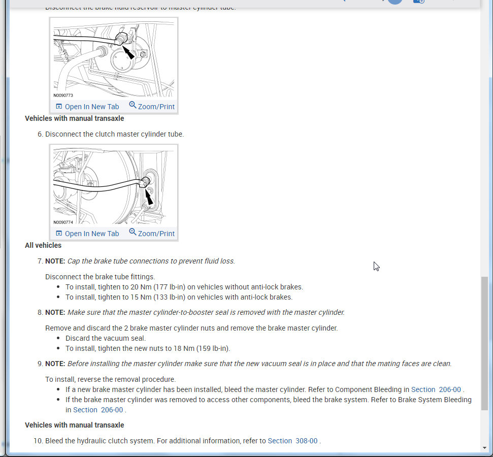

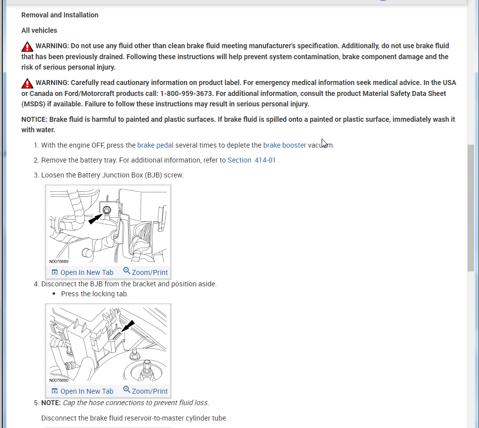

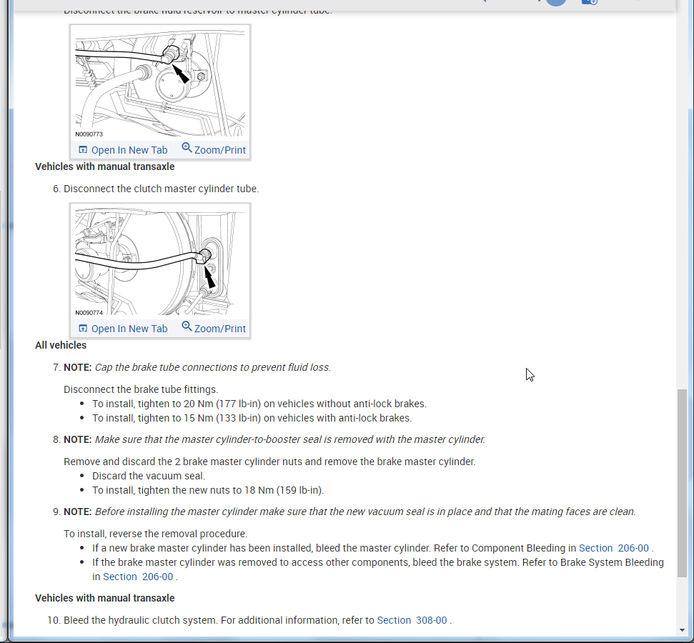

Here are the master cylinder installation instruction you have requested. Here is a guide to help you step by step with instructions in the diagrams below to show you how on your car.

Below you will find instructions from the manual that will get you anything else you need.
Lastly you will need to bleed the brakes so here is a guide that will help with this:
