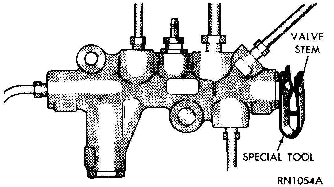

I’ve recently changed the the brake booster on my truck listed above (w250) as well as the calipers and wheel cylinders and master cylinder. I have bled the lines while off and it’s fine but as soon as I start the truck to bleed them, the pedal is pulled to the floor and won’t come back. Any ideas on how to fix it??

I know there is a pressure hold off valve that could be causing the issue. It does require pressure bleeding. Do me a favor. Take a look through these directions and let me know if it is something you can try. Also, let me know how you have been bleeding them to this point and if there is pressure when you open the bleeder.
The attached pic correlates with these directions.
1991 Dodge or Ram Truck W 250 Pickup V8-360 5.9L VIN 5
Pressure Bleeding (Preferred Procedure)
Vehicle Brakes and Traction Control Hydraulic System Brake Bleeding Service and Repair Procedures Pressure Bleeding (Preferred Procedure)
PRESSURE BLEEDING (PREFERRED PROCEDURE)
Fig 2 Extending Valve Stem
See pic 1
NOTE: All vehicles are equipped with a pressure hold-off valve. The valve is located (in the combination valve) on the left frame rail. The hold off valve balances front and rear braking force to improve braking and steering control on icy surfaces. The valve shuts off the flow of brake fluid between 3 and 135 PSI. Because the valve shuts off flow in this pressure range the valve must be held open manually -- using tool C-4121 or equivalent -- when pressure bleeding the system.
CAUTION: Under no circumstances should a rigid clamp, wedge or block be used to depress the valve stem. This could cause an internal valve failure resulting in complete loss of front brakes.

I do not believe it has a hydraulic system for the brakes at all. If it helps, you had all the info right except it’s vin Z. Any other ideas you may have? It did this when we replaced the booster, before we replaced the master cylinder. We decided to chance the master cylinder because it was doing this pedal thing and it still does it with the new one. We have no leaks and the brake fluid runs clear when we bleed it while off.

I'm not sure why the vin is different, but something isn't adding up. The Z engine code is for a 360 CI V8. Is that what you have? Is it a gas engine? Does it have rear ABS?
If you are getting a pedal when the engine is off and it goes to the floor when started, I suspect it is an air issue in the system. This does have a vacuum controlled assist brake booster, correct? Some actually had the hydro-boost.
Let me know exactly how you are bleeding the system. Also, I reread your original post. Why are you starting the vehicle to bleed the brakes? If the pedal goes to the floor, either we have a bad master cylinder, a leak, or air in the line. There really isn't anything other.
