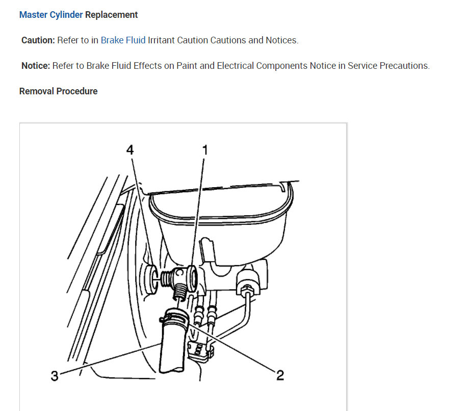

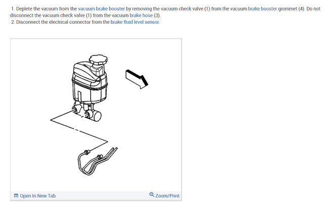

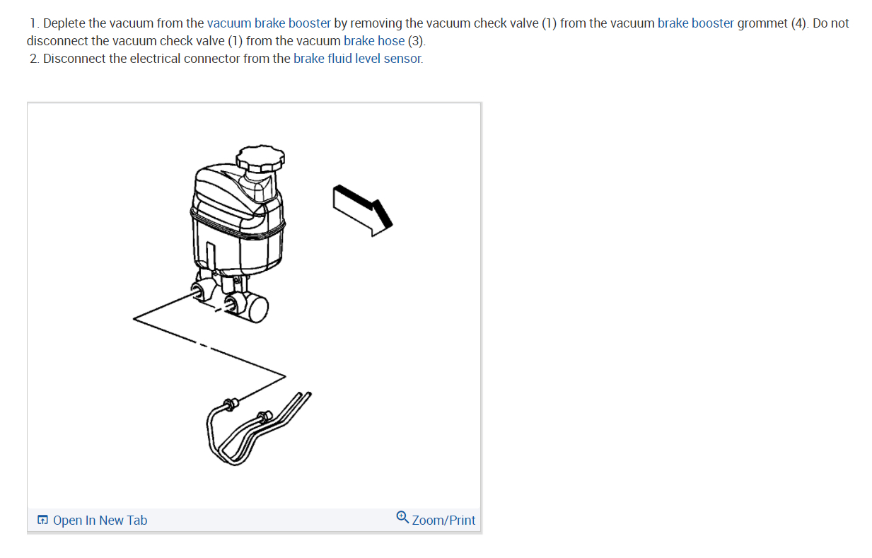

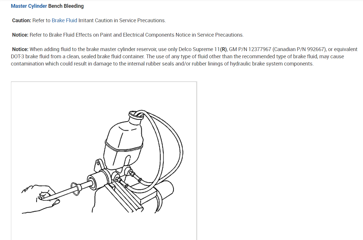

Good morning,

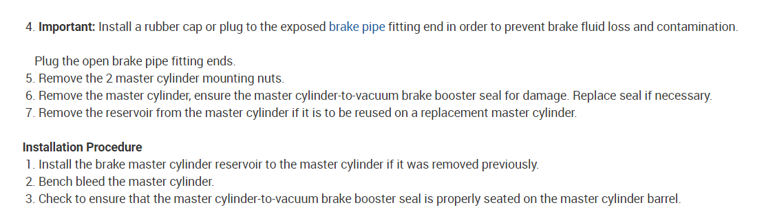

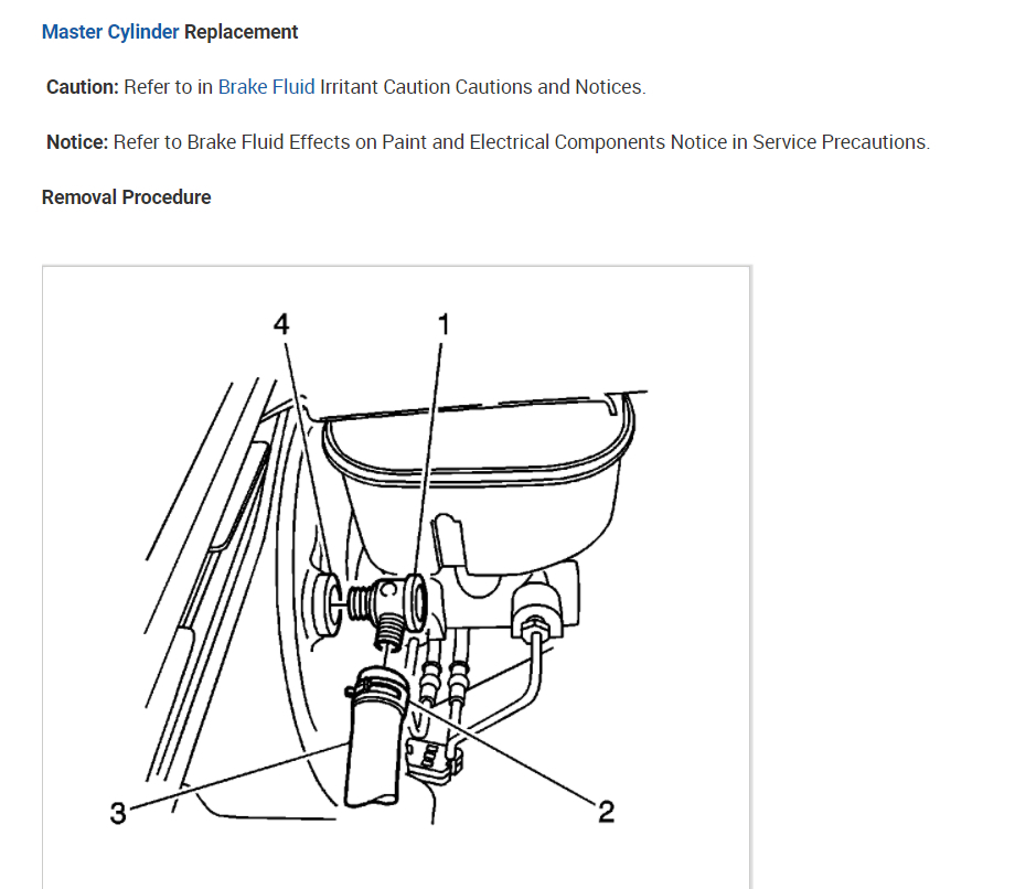

I would check the system for any leaks. It sounds like you either broke a brake line or the master cylinder has failed and needs to be replaced.
https://www.2carpros.com/articles/brake-pedal-goes-to-the-floor
https://www.2carpros.com/articles/how-to-replace-a-brake-master-cylinder

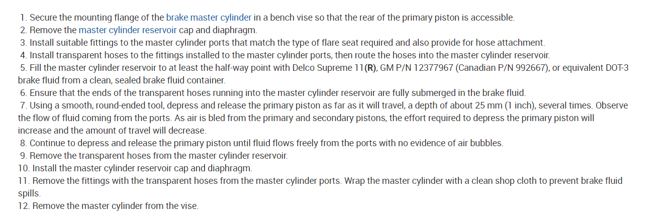

You will need to bench bleed the master cylinder before installing it.
https://www.2carpros.com/articles/how-to-bleed-or-flush-a-car-brake-system

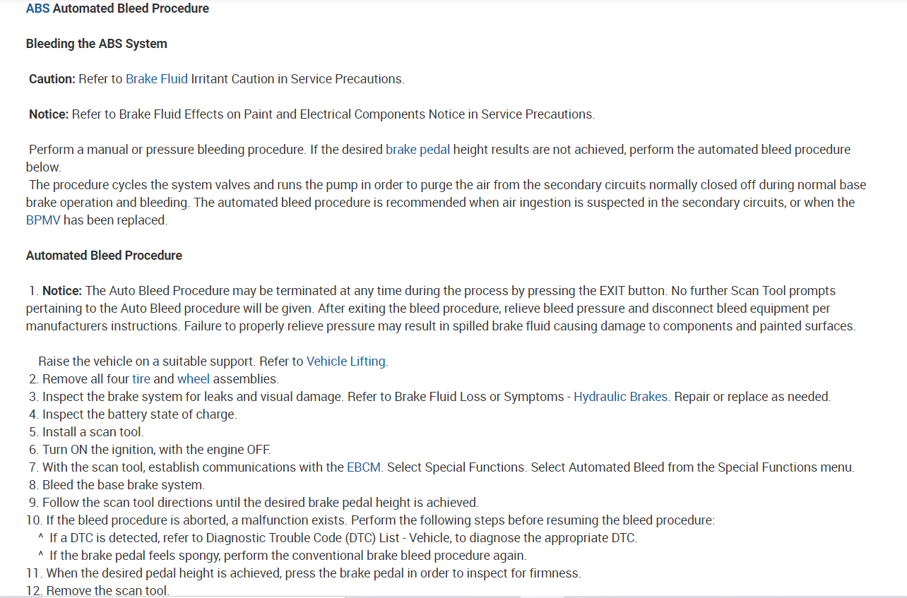

You will have to have an advanced scan tool to bleed the system as the ABS has to be bled as part of the bleeding process.

You have a failed master cylinder. The internal seals have failed.

Thank you. Roy I will look in to it, also if I do replace it then as for bleeding I have a scan tool that does ABS and the car has a auto bleed built in with a obd2 will that be adequate or should I do it old school and have a friend just pump and hold as I bleed each wheel starting from passenger rear to driver rear to passenger front to driver front?
Monday, August 9th, 2021 AT 7:54 AM
  • 52,797 POSTS
Okay, you will bleed the ABS module first. Then you will bleed using a second person for the rest of the system

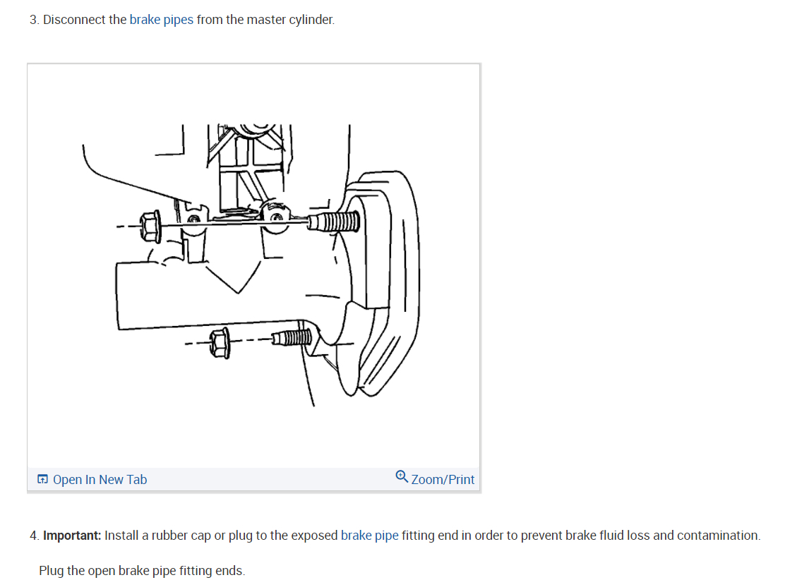

Roy, please help. I was removing and replacing master cylinder and both bolts removed studs half way now I have got one off by using a 6mm sock it on stud and 13 on nut but number 2 is all most impossible to move on stud?
Thursday, August 12th, 2021 AT 6:45 AM
  • 52,797 POSTS
Can you please upload some pictures of what you see?
