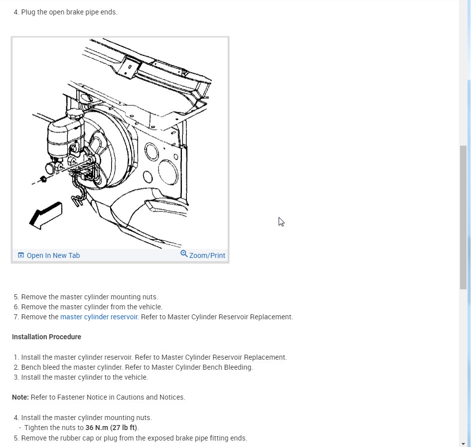

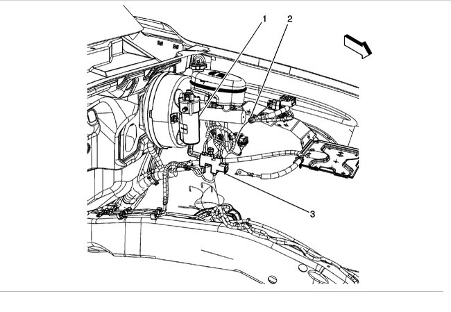

Code says master cylinder pressure sensor means i need to replace the master can you help me please?
Feb 22, 2021 at 9:40 AM (Merged)
  • 55,433 POSTS

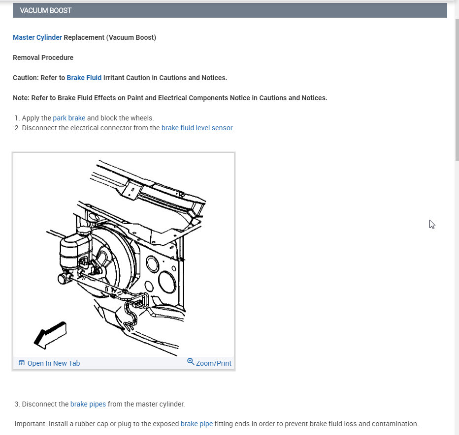

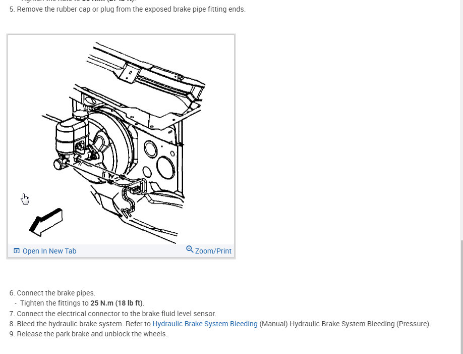

The sensor is on the brake master cylinder here is a diagram to help you see where it is. This guide and video will help you get the job done. Here is a guide to help you step by step with instructions in the diagrams below to show you how on your car.
