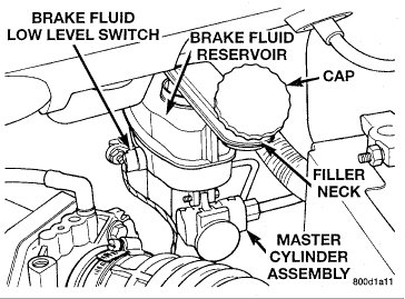

CAUTION: Before removing the master cylinder filler tube from the brake fluid reservoir, the filler tube, brake fluid reservoir and master cylinder must be thoroughly cleaned. This must be done to prevent dirt particles from falling into the brake fluid reservoir and entering the brakes hydraulic system.
Thoroughly clean all surfaces of the filler neck, brake fluid reservoir, and master cylinder. Use only a solvent such as Mopar Brake Parts Cleaner or an equivalent.

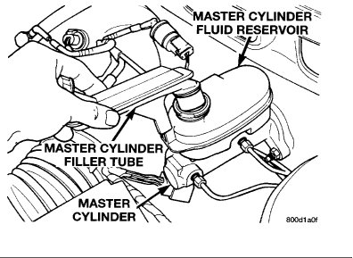

Master Cylinder Filler Tube Removal
Remove master cylinder filler tube from brake fluid reservoir by pushing down and rotating. Then remove the cap from the removed filler tube and install it on the master cylinder reservoir.
Master Cylinder Assembly
Remove vehicle wiring harness connector, from the brake fluid level sensor, in master cylinder brake fluid reservoir.

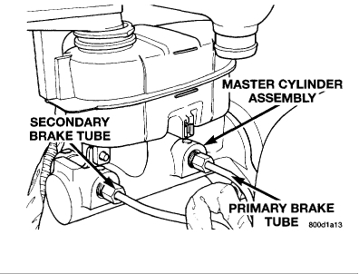

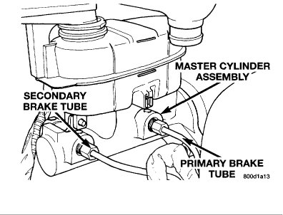

Primary/Secondary Brake Tubes At Master Cylinder
Disconnect the primary and secondary brake tubes from the master cylinder housing. Install sealing plugs in the open brake tube outlets on master cylinder assembly.

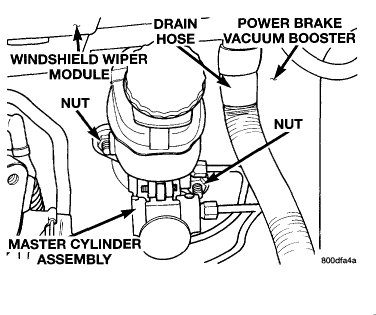

Remove the 2 nuts attaching the master cylinder assembly to the brake vacuum booster.
Slide master cylinder assembly straight out of the power brake vacuum booster.

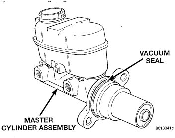

CAUTION: The master cylinder is used to create the seal for holding vacuum in the power brake vacuum booster. The vacuum seal/boot on the master cylinder MUST be replaced whenever the master cylinder is removed from the power brake vacuum booster.
Remove the vacuum seal located on the mounting flange of the master cylinder. The vacuum seal is removed from the master cylinder by carefully pulling it away from the master cylinder. Do not attempt to pry the seal off the master cylinder by inserting a sharp tool between seal and master cylinder casting.

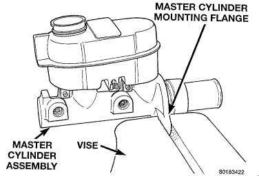

CAUTION: When clamping master cylinder in vise, only clamp master cylinder by its mounting flange, do not clamp on primary piston, seal or body of master cylinder.
Master Cylinder Mounted In Vise
Clamp the master cylinder in a vise using only the mounting flange.

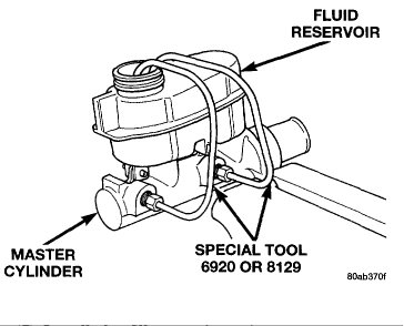

NOTE: Two different size bleeding tubes are used depending on which type of master cylinder the vehicle is equipped with. Vehicles equipped with traction control use a center port master cylinder with a larger diameter brake tube. Vehicles not equipped with traction control use a compensating port master cylinder using a standard 3/16 inch diameter brake tube. Be sure the correct size bleeding tubes are used when bleeding the master cylinder.
Bleed Tubes Installed On Master Cylinder
Install the Bleeding Tubes, Special Tool 6920 for a non-traction control master cylinder or Special Wool 8129 for a traction control master cylinder on the master cylinder. Position bleeding tubes so the outlets of bleeding tubes will be below surface of brake fluid when reservoir is filled to its proper level.
Fill brake fluid reservoir with brake fluid conforming to DOT 3 specifications such as Mopar or an Equivalent.
Using a wooden dowel, depress push rod slowly, and then allow pistons to return to released position. Repeat several times until all air bubbles are expelled from master cylinder.

CAUTION: When replacing the master cylinder on a vehicle, a NEW vacuum seal MUST be installed on the master cylinder. Use only procedure detailed below for installing the vacuum seal onto the master cylinder.
Vacuum Seal Installed On Master Cylinder
Install a NEW vacuum seal on master cylinder making sure seal sits squarely in groove of master cylinder casting.
Position master cylinder on studs of power brake unit, aligning push rod on power brake vacuum booster with master cylinder push rod.
Install the 2 master cylinder to power brake unit mounting nuts. Then tighten both mounting nuts to a torque of 25 Nm (225 inch lbs.) .
CAUTION: When installing the primary and secondary brake tubes on master cylinder, be sure brake tubes do not contact any other components within the vehicle and that there is slack in the flexible sections of the tubes. This is required due to the movement between the ABS hydraulic control module (HCU) and the master cylinder, when the vehicle is in motion.
Connect the primary and secondary brake tubes to master cylinder primary and secondary ports. Brake tubes must be held securely when tightened to control orientation of flex section. Then fully tighten the tube nuts to a torque of 17 Nm (145 inch lbs.) .
