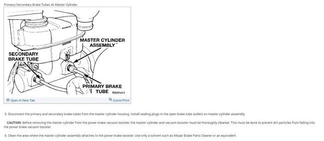

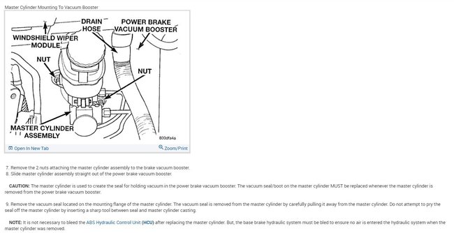

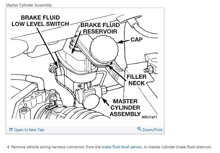

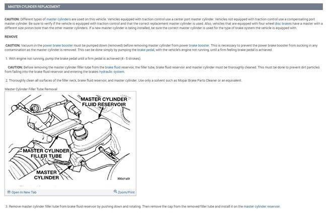

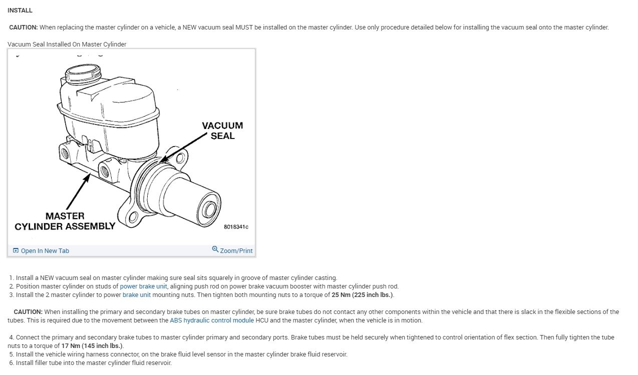

Sounds like the master cylinder may be by-passing internally. This will happen sometimes when the seals inside become work and cannot always hold pressure.
See the guides below on this issue, they will help shed some light on what is going on and how to repair it. Video
https://youtu.be/WDxvEQrMkBg
and
https://www.2carpros.com/articles/brake-pedal-goes-to-the-floor
and
https://www.2carpros.com/articles/how-to-replace-a-brake-master-cylinder
See the images below for replacement of the master cylinder
